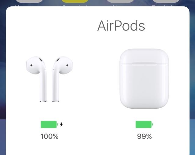

My wife's AirPods after nearly 36 hours:

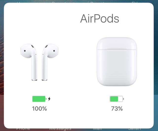

My original ones after 11 hours with zero use:

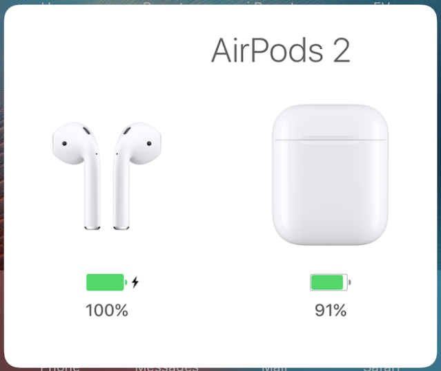

And my new pair after 6 hours with zero use:
Something definitely isn't right. My original pair that has discharged to 73% in 11 hours, I'm going to let them die completely without using them at all. Curious how long it'll take.
