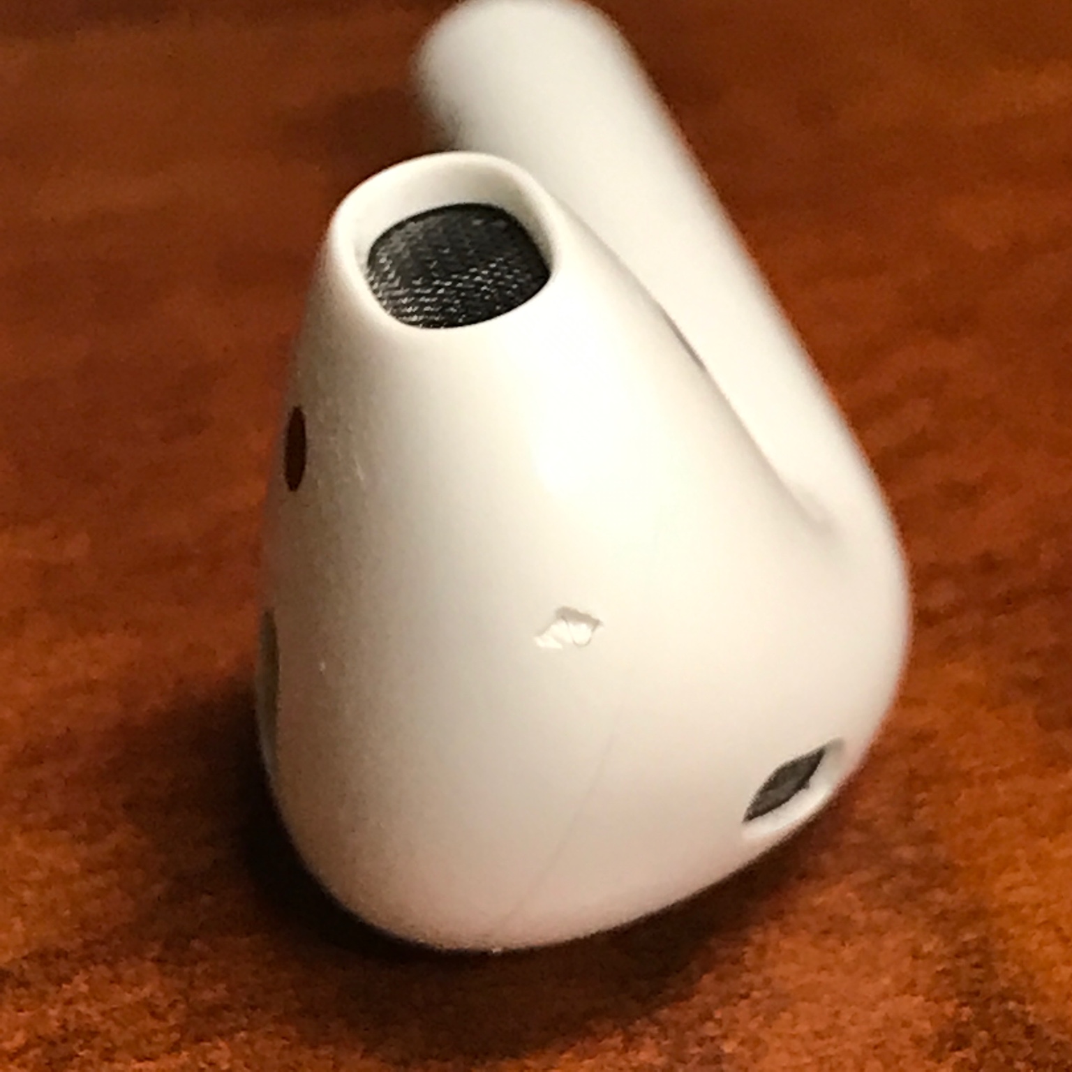

Dropped mine yesterday. Was putting my hydration vest on and the tubing dislodged the Airpod from my right ear and it fell to the ground (pavement). It almost got dislodged again when my arm brushed my face.
Still works okay, there's a smaller chip somewhere.
