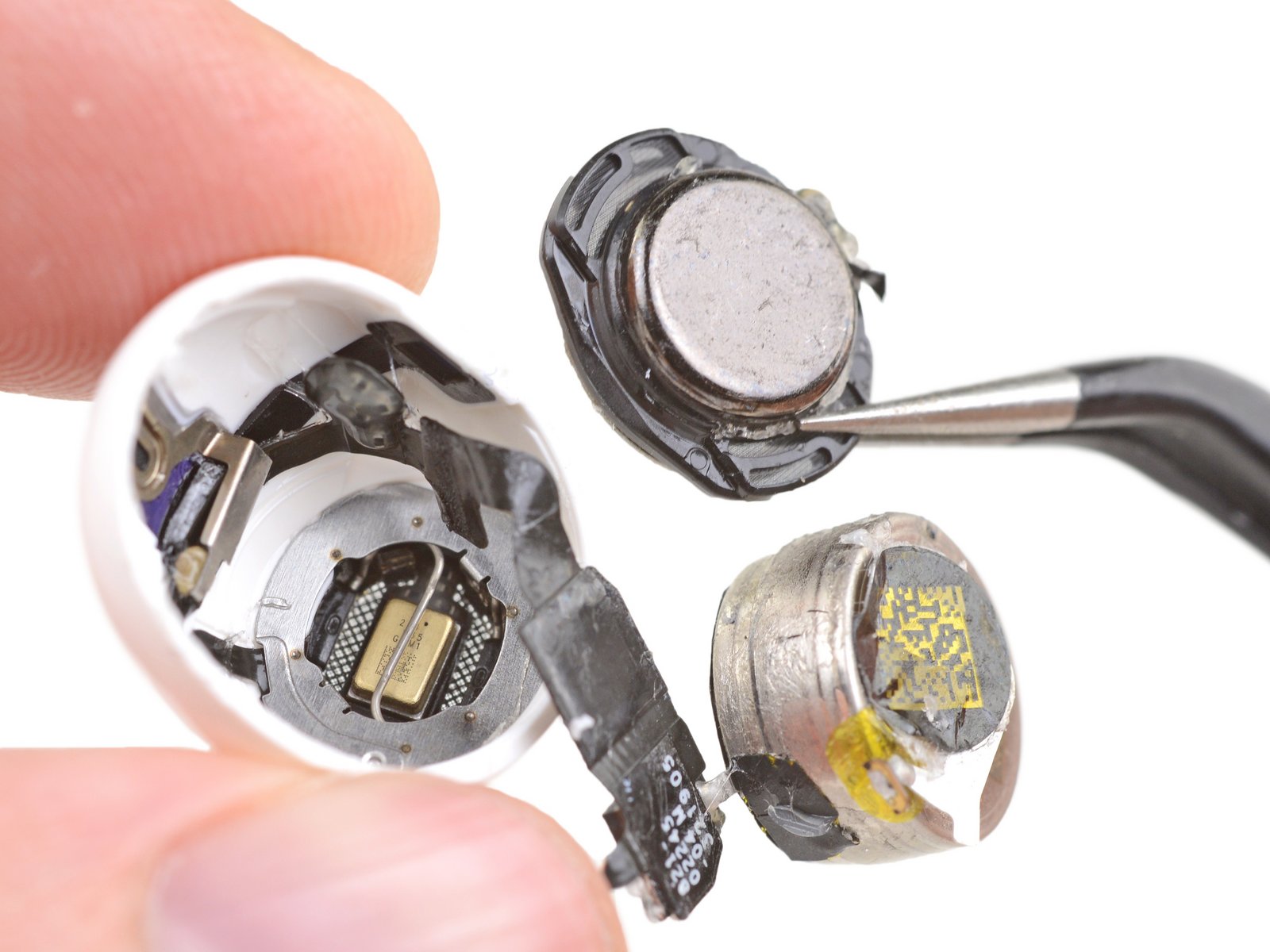

I think this is caused by one of the noise cancelling mics picking up vibration(movement) and then spitting what it thinks is the reverse out into your ear. https://d3nevzfk7ii3be.cloudfront.net/igi/WEpddnsSXf3wurQM.huge
See that metal wire running across that mic? If I could afford to I would take my left one apart and see if that is already loose. Just my wild guess.
If a firmware issue fixes it then I would bet they simply disabled one of the mics, or eliminated via software the frequencies the mic picks up that correspond to whatever is commonly coming loose and vibrating. This would also explain why it might fix it for some but not others because there may be multiple sources of vibration at different frequencies.
