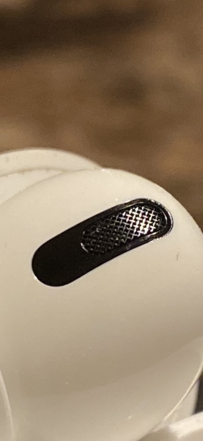

The July and August APPs had a flush inner vent with the white plastic surface. The ones I received today both seem to be every so slightly but cosistently recessed into the APP housing. IF it means something, then it’s probably to avoid direct vent contact with the skin of the inner ear.

The swap before wasn’t even 3 weeks ago, developed the usual ANC issues. Those were August And July 2020. I compared both under a microscope.

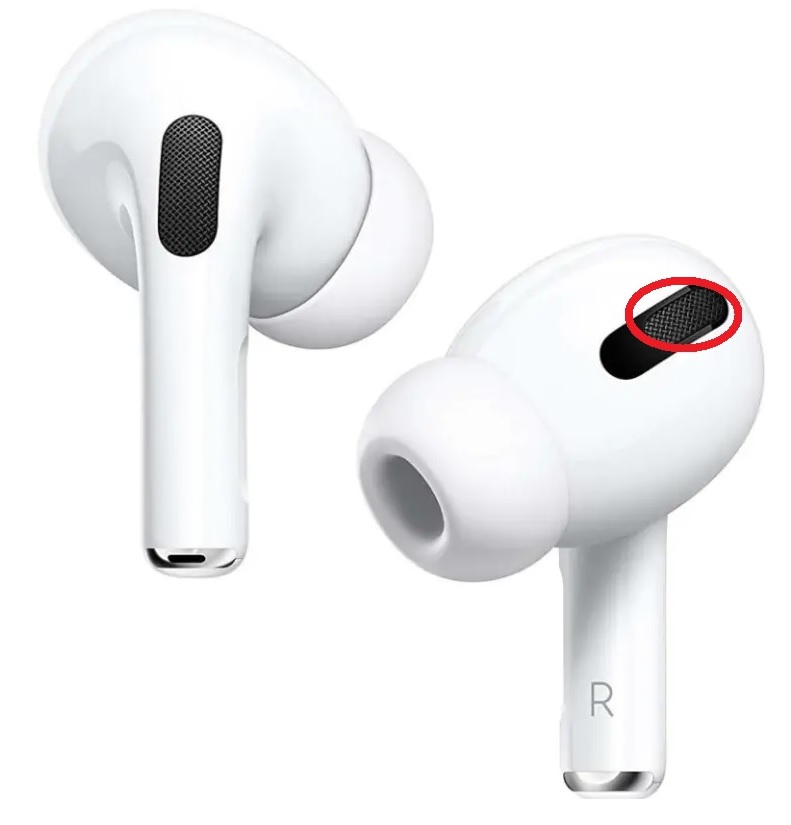

Are you talking about the circled area? If so, even mine with the "G" serials have it recessed now. I still have a faulty pair at home and will be comparing them once I'm back from work. Well this gives me some hope that even mine, with the "G" serials, are a revised version. And they were made in the China facility, mind you.

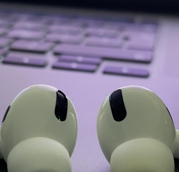

Anyone mind taking pictures of the new recessed vent mesh?
I swapped 3-4 pairs, so it’s still a fairly small sample size, but it is what I instantly noticed. Is why I put “IF” in caps in my previous posts.
The ones I only replaced 14 days ago had flush vents, so did the ones from October 2019 and others.

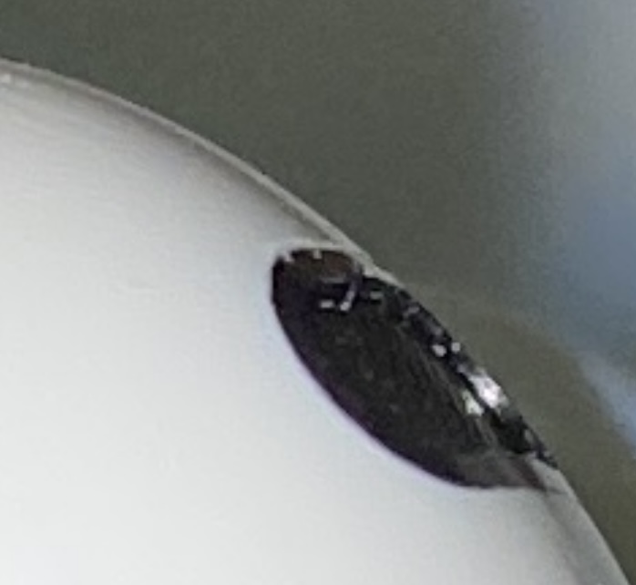

Both, left and right replacements show the same “gap”, so I don’t think it’s a misaligned vent grid.
Week 4, September 2020, Week 1 October 2020.
Btw, picture is showing an unworn set of AirPods Pro, straight out of the box. So those particles, probably some glue residue or dust particles, were there before 😉
Who would have ever thought that a mesh flush with the body would be the ideal collector for ear gunk mmm... ?

Just got my replacement in store. Can confirm the recessed grill (I would say about half a milimeter) will test it out once it’s synchronized and paired. But I put a lot of confidence into that hardware change
