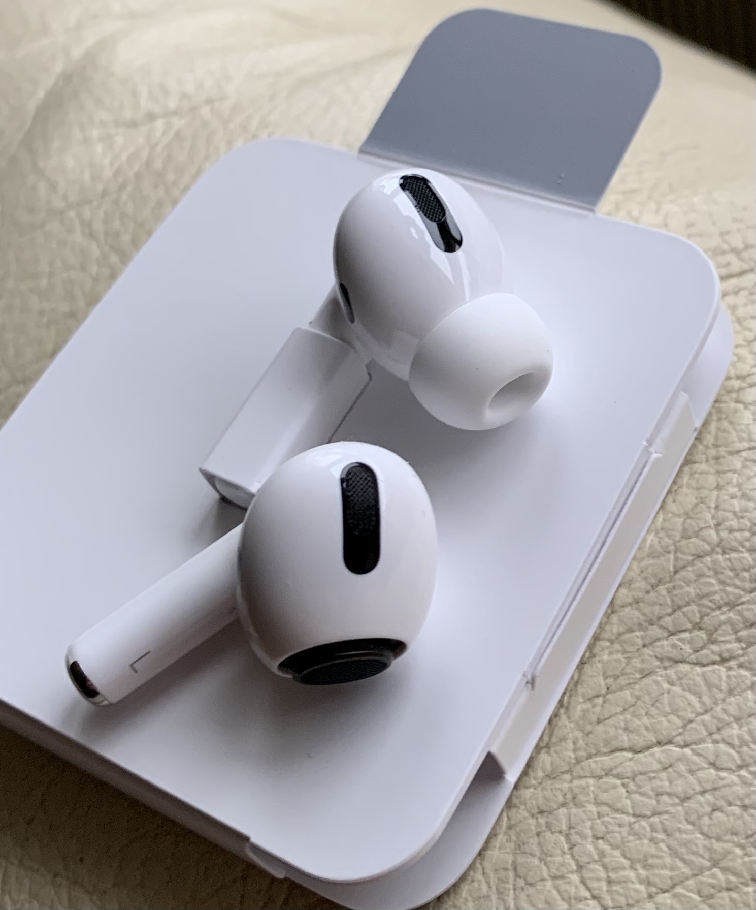

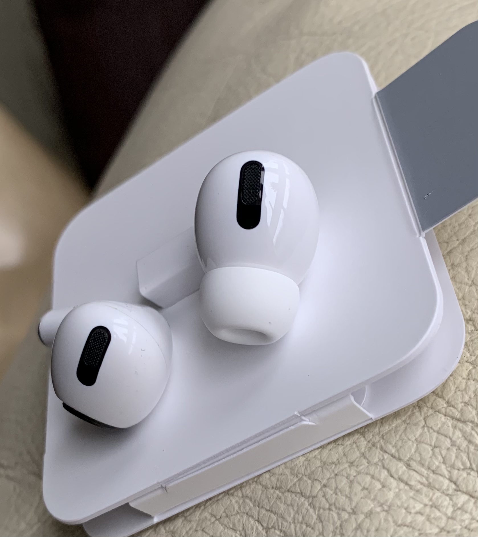

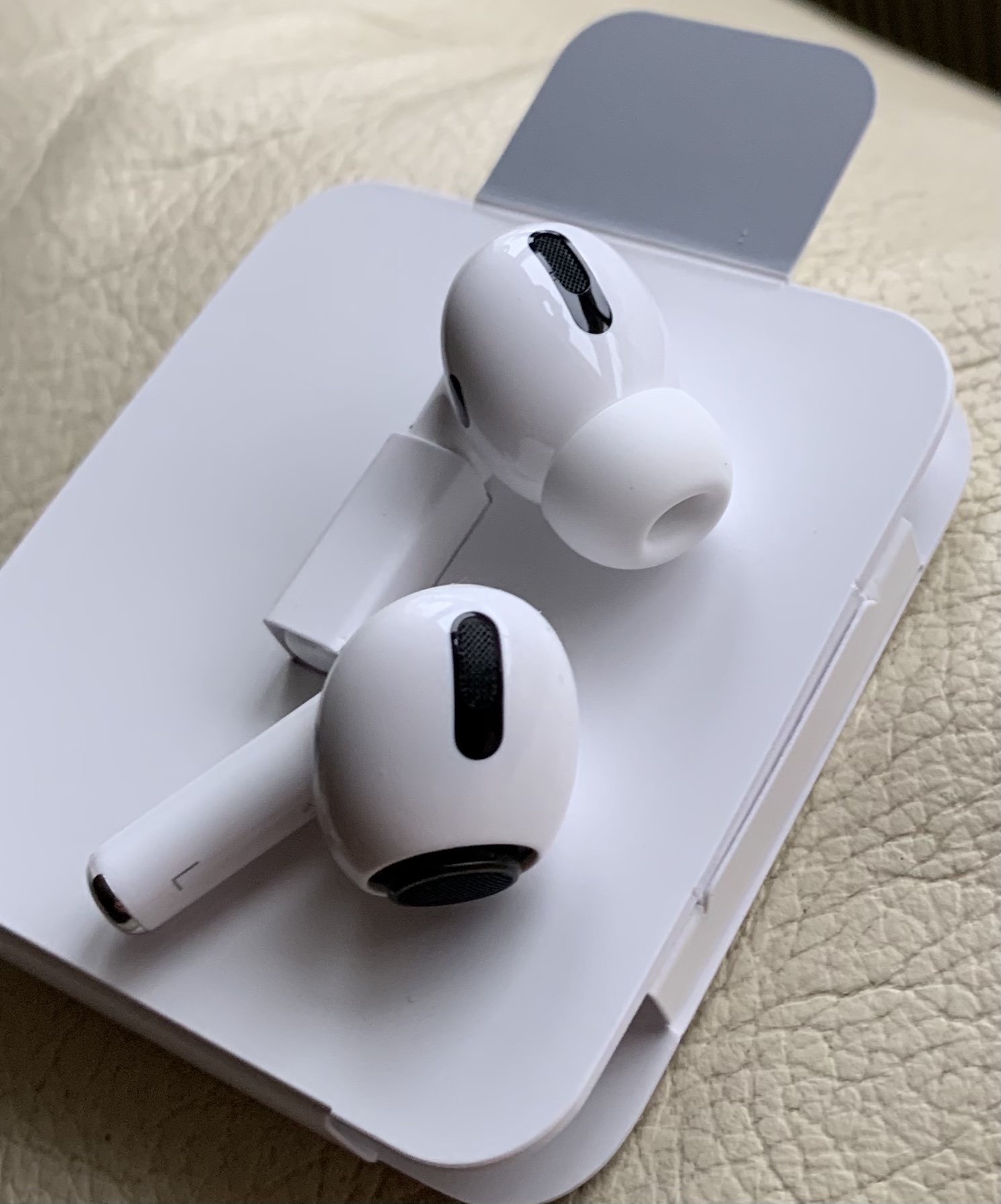

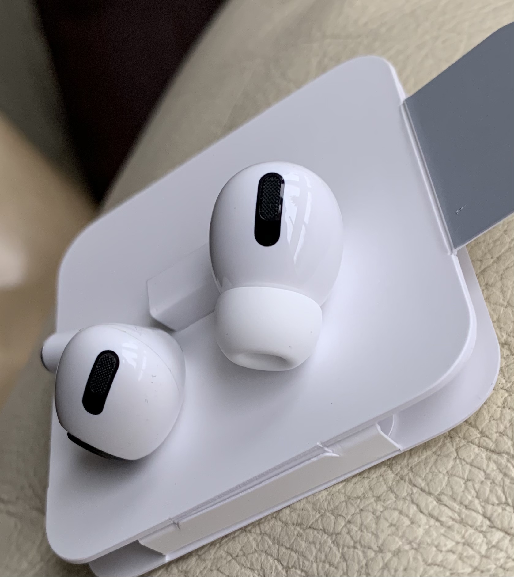

It’s difficult but I think you just have to go with a fingernail. If you feel snag or resisting along the grill. If your fingernail gets trapped in the tiny recess of the grill..chances are it’s the later (post-October) version.
It’s difficult to see but this pic of my new replacement (With tip. Post-October) alongside my original (without tip, pre-October) shows a slight but obvious definition of the plastic surrounding the grill
View attachment 1691714View attachment 1691713
ah - yeah i can feel the snag on the new one but not the old. thanks. visually i still can't see much of a difference but maybe if i took pictures like this it would be more obvious.

Hello from austria,
i got 2 new AirPods from Apple.
when I use this instruction, because of the letter G and K the Production would be cw 39 and 42.
But on the backside I have also a sticker with 2041 and 2043. Does this mean there are from year 20 cw 41 and 43?
The vents are the new ones. But if letter G is cw 39 the production is end of September and not the new model from October. I am confused.
According to this table:
One of the two serial numbers in your photo would be October 2020 (DK) and the other one would be September (DG). I’m not sure this table applies to AirPods but the serial number format does seem to match up.
This is looking at the fourth and fifth characters in the serial numbers (which are marked S/N). By the way, you may want to take down those photos or at least blur out part of the serial number. Not sure what someone could do with it, but better safe than sorry. :)

Thanks,
but both had the recessed grill. I don’t know if I should return the one because it is built in September. And apple said that all AirPods Pro from october build are redesigned.
I also read Post-October 2020 productions end in 0C6L. Pre-October 2020 (should) end in LKKT.
Also the last 4 chars of the pods are 0C6K (left) and 0C6J (right) for the new version.
