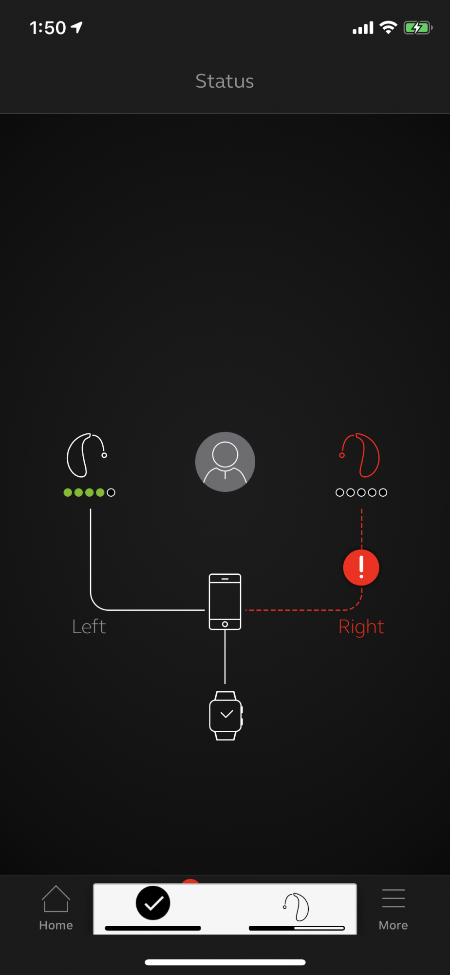

I have similar issues with my hearing aids ever since 13.2 update.
They double as headphones.
Kinda nice as I don’t have carry extra headphones and I don’t have to take them out once a call is done.

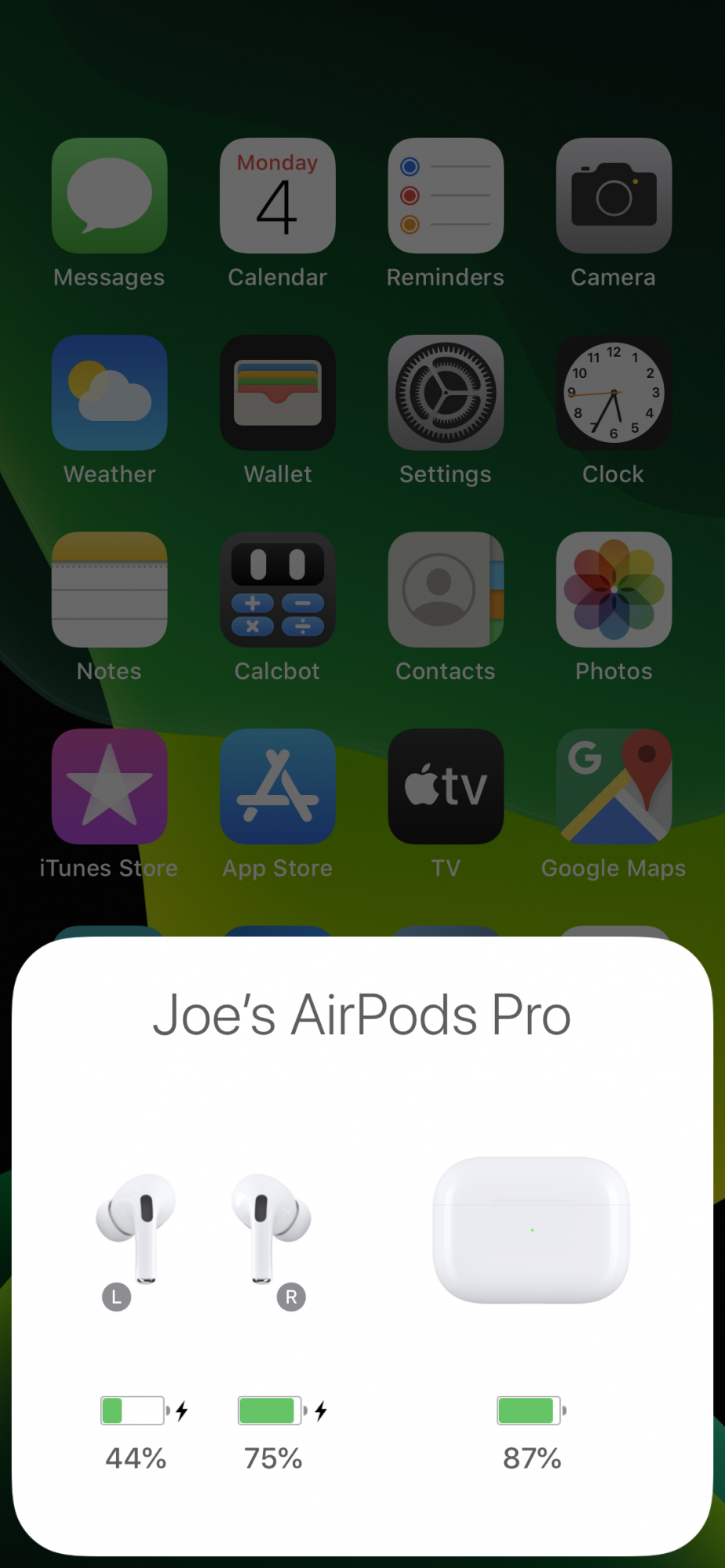

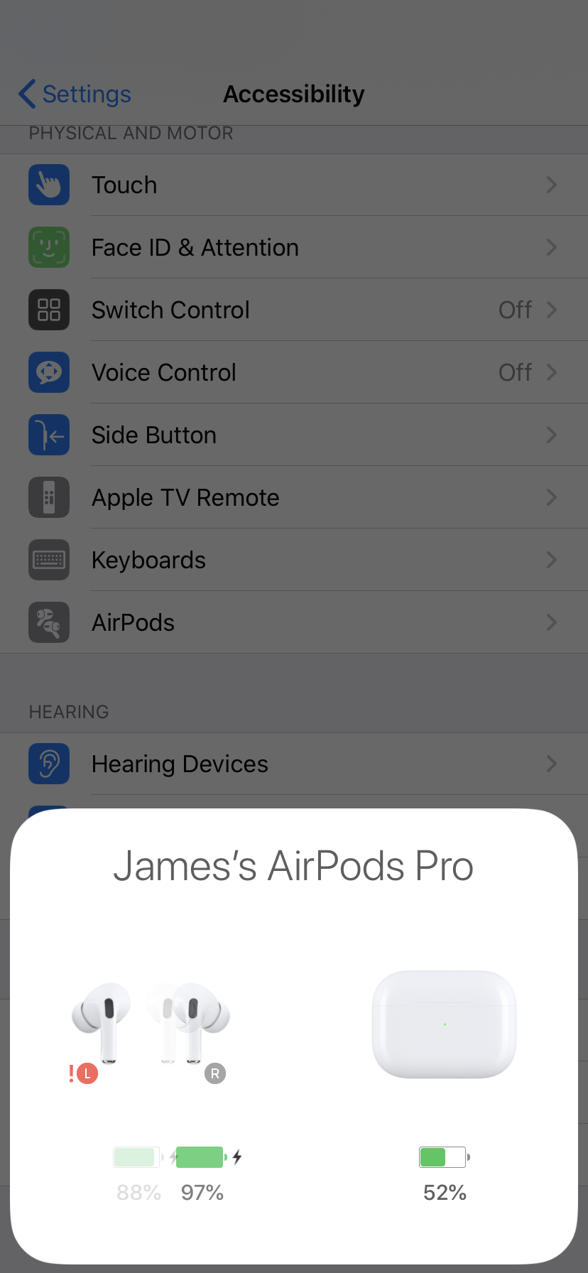

So my new AirPod Pros pair and work no problem. They also seem to charge in the case ok. But when I get the onscreen animation upon opening the case I remove an AirPod and put it back the two images of the AirPods dance side to side like it’s glitching and shows a red exclamation. This swaps depending on what AirPod I remove then replace.
There’s no dirt or dust in the case or AirPods. What the hell is happening? Are these defective?
I repaired several times and reset the phone but it keeps happening.
Probably a bug I experience that but it still works normally.

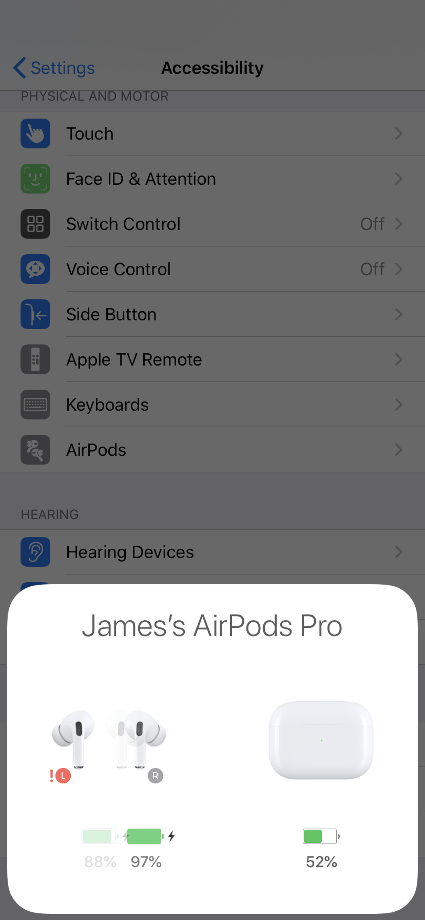

I’m also having this problem. The pods works fine though but I’m mostly worried about the battery drain. Left pod is sometimes 20-30% less than the other one. Probably the one that are dancing around in the animation :(

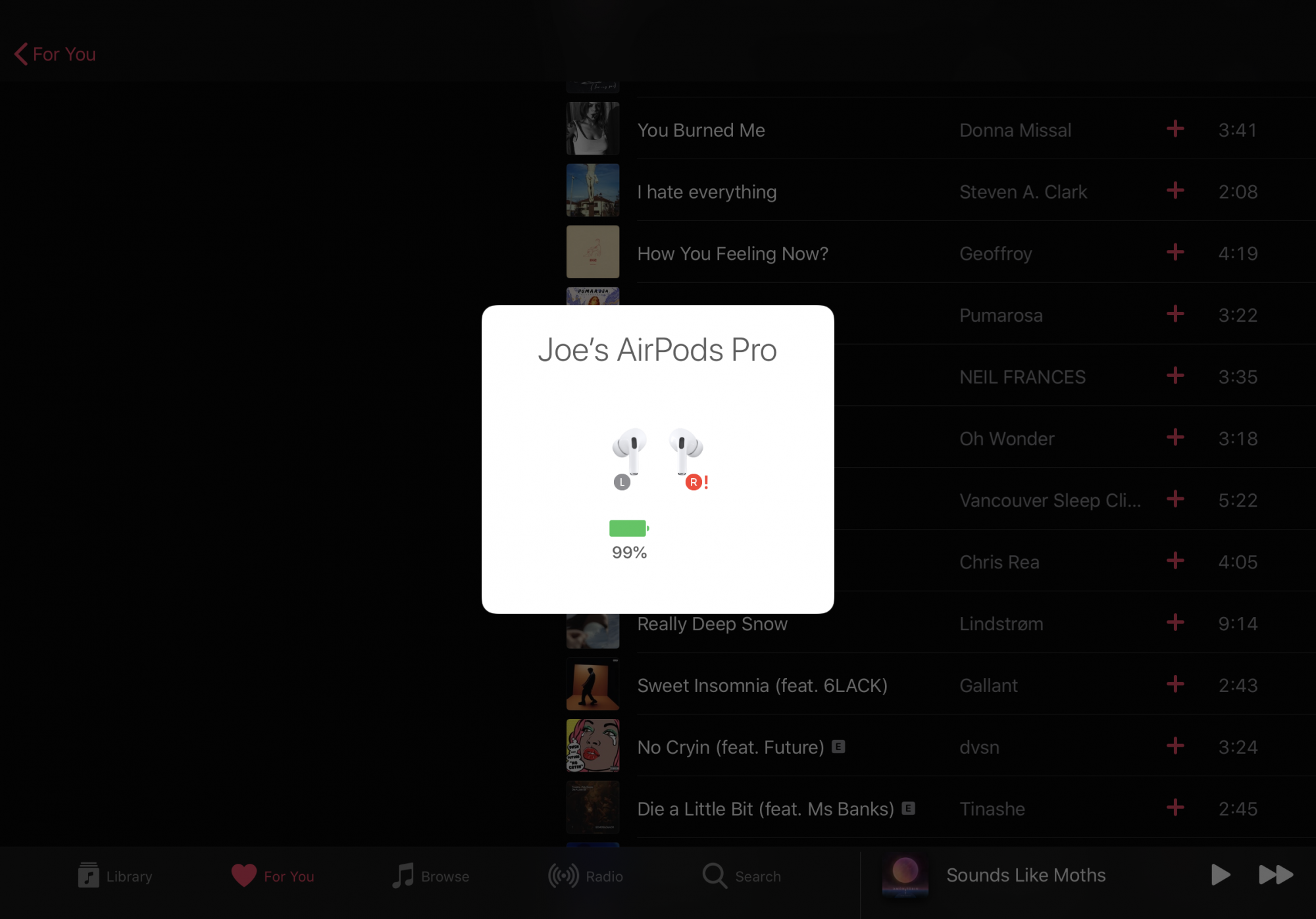

Yeah me too, always the right one.
This is NOT a visual error. If I try to use the affected bud with the exclamation point... nada. I also get the connected/not connected dance when the buds are in the case.
Hmmm, if this affects AirPods and AirPods Pro, this may be an iOS issue. We will have to wait for Apple to acknowledge the issue and plans for the fix.

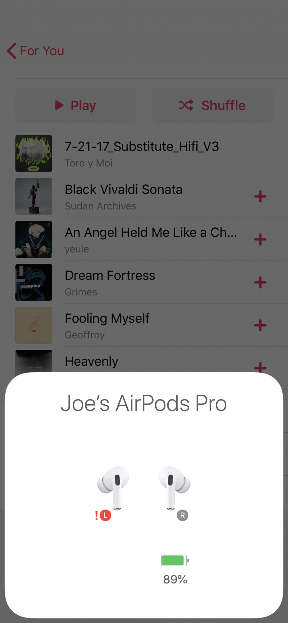

I keep having this issue on my left AirPod, only that I can’t actually play any music or sound to it. I pretty much cannot use noice cancelling at all and the issue persists after many un pairs.

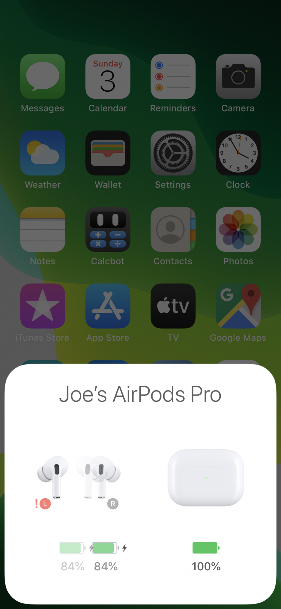

It seems to me to be a software bug with the battery level reporting. I have seen red exclamation occasionally, but more commonly a big battery level difference between left and right. It can go from showing they are within a percent of each other to 20-30%+ difference. Currently it is showing a 40% difference, but it is also reporting that one of them is still charging from the case... when it is in my ear! So seems like a software reporting bug.
Maybe so, but when the red ! is there, no sound or NR comes through the affected bud.
