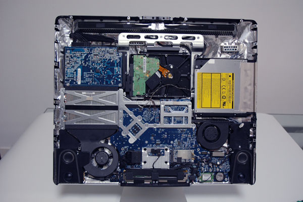

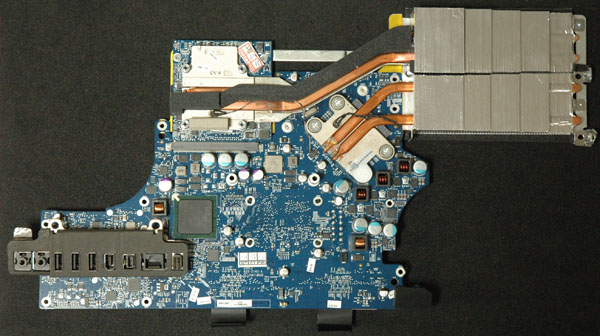

Cpu intensive or not it's always in a high usage, but that's not all, both cpu and gpu share the same heatsink, so, when one heats up, the other will raise a bit also.
In a closed room at 28ºC gaming C&C 3 for 2 hours with fans at 2500rpm I get around 55ºC CPU and 75ºC/79ºC. Without smcfancontrol the fans will only rise till 1600rpm. Imagine the temps at those fan speeds...
