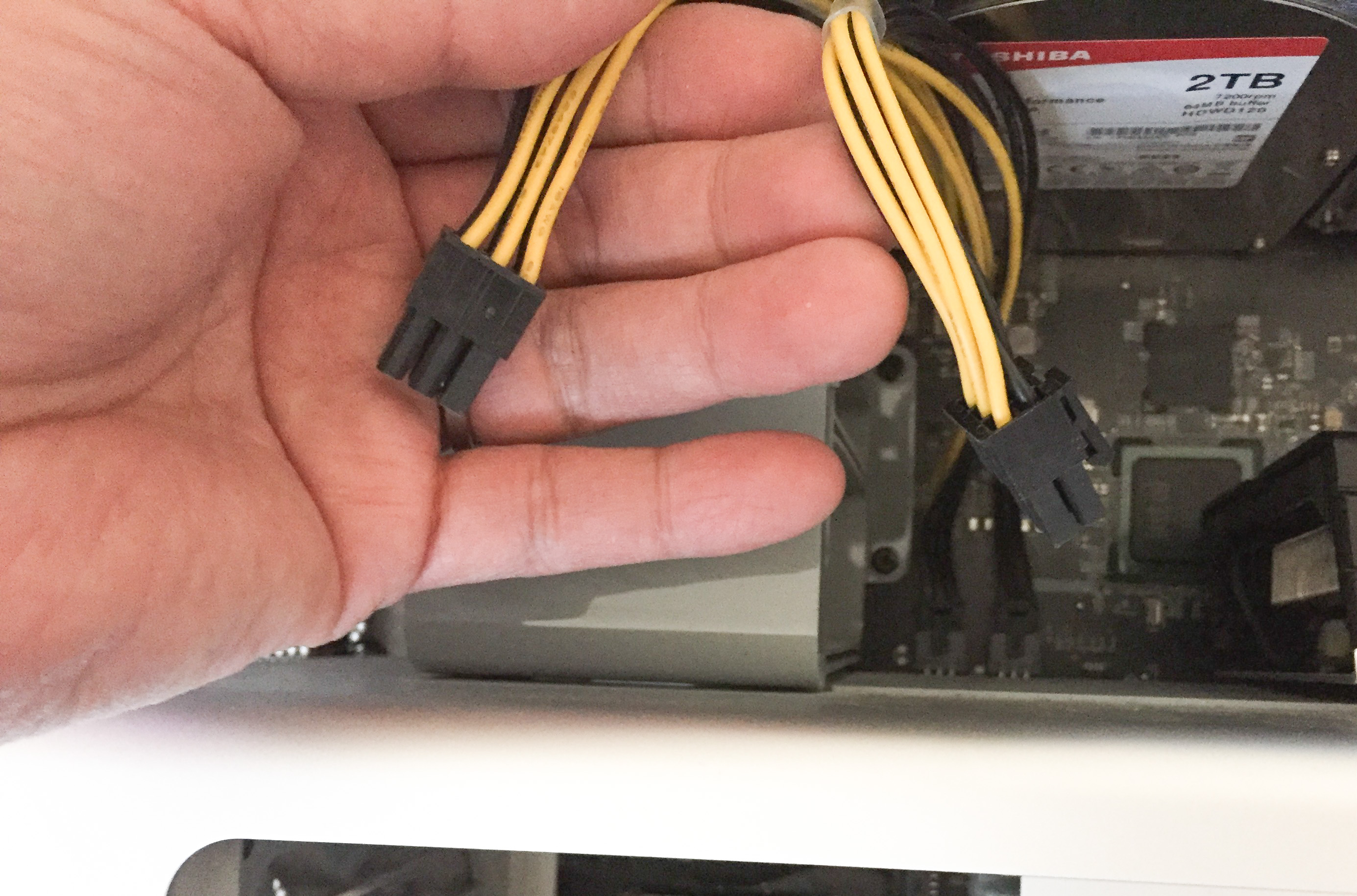

Thanks again for all the help. I went ahead and purchased the reference Sapphire RX580 from Amazon and the Dual 6 pin to 8 pin y-adapter cable. I'm looking forward to having Display Port 1.2, as it has been annoying using a 4K monitor with the AMD 7950 as I have to constantly change the MST to secondary during boot up and then having to reverting back to off.

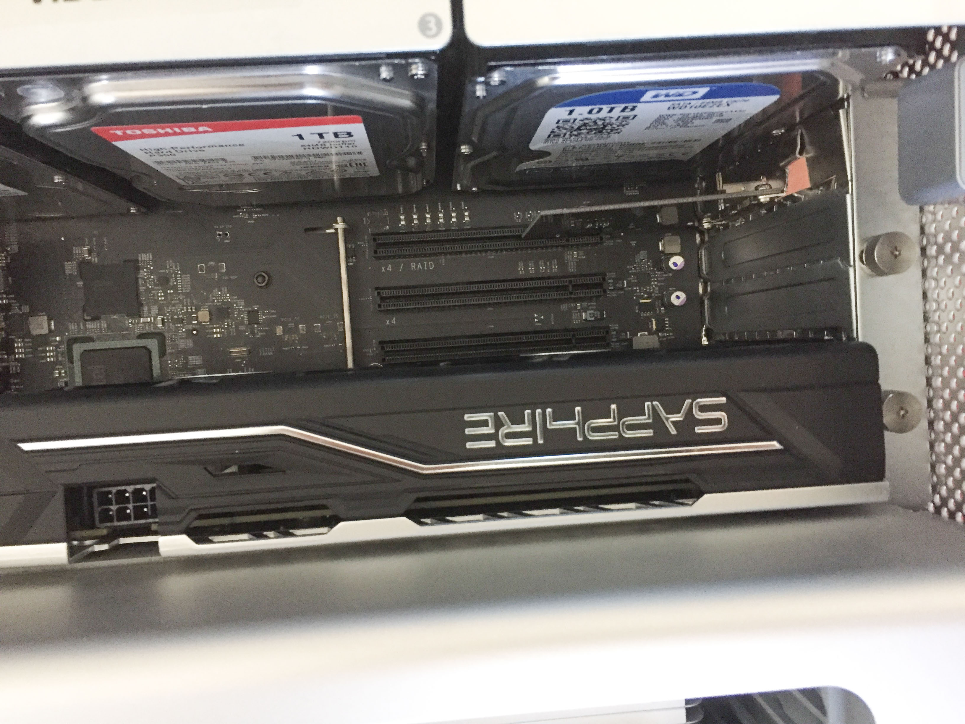

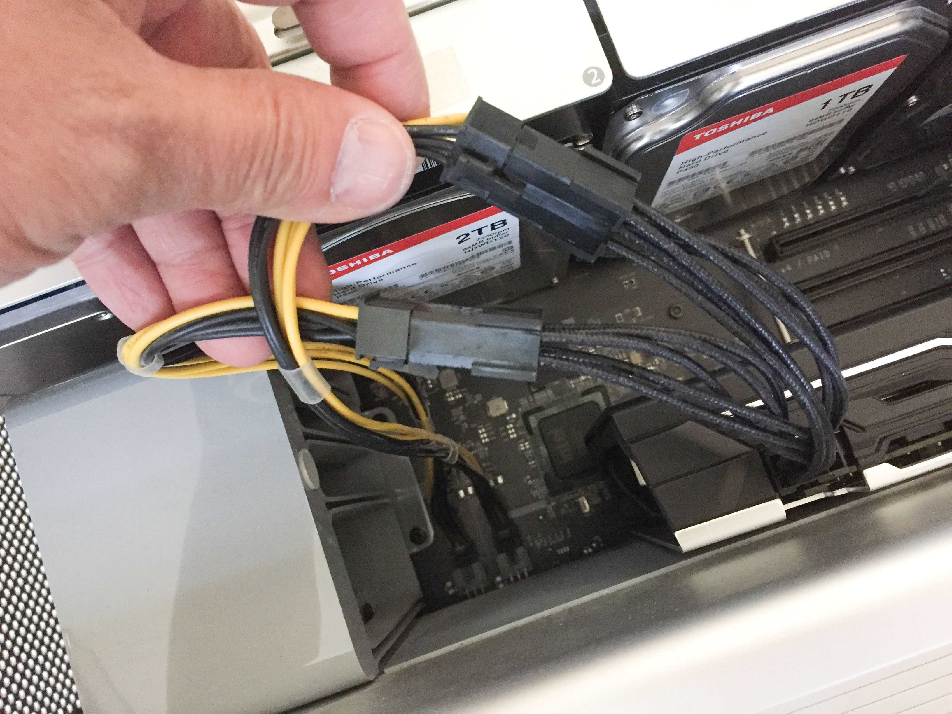

So just got this RX580 installed and I'm very happy. (I got the Y-adapter cable - dual 6 pin to 8 pin from GutsParker on Amazon-- no issues despite some of the reviews).

The Sapphire RX580 Pulse has been working like a champ in the Mac Pro 5,1 and Dell P2715Q. It has been flawless. It is such a relief not having to deal with the boot issues with the 7950 and 4K monitors. (When it freaked out in the past, I had to shut down reset the SMC and reset PRAM etc.)
Performance has been phenomenal.

Every once in a while in Windows 10, my screen will go black for about a second and come right back on. It has happened only like twice since I got the Sapphire PULSE RX 580. I wasn't gaming or anything, just idle. This morning it happened right after I woke the computer up from sleep. The screen came on, I went to start using it, then the screen went black and came back on.
It's making me paranoid. I'm using the 16AWG dual mini 6 pin to 8 pin cable to power it.
