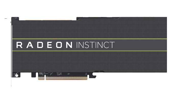

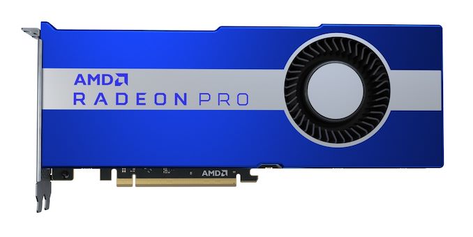

Fewer streams and CU , slightly better compute and better memory bandwidth than the WX9100 / Vega F.E. It uses a smaller 7nm process but also the same power consumption ratings ( officially - we'll see what its like in reality in time ) . It should run cooler , but AMD probably bumped up performance to negate the thermal savings . Same GPU as the straight Radeon VII ( Vega 20 ) ... Waste of money to install this in a cMP . Might be fun to install in a MP7,1 , though .

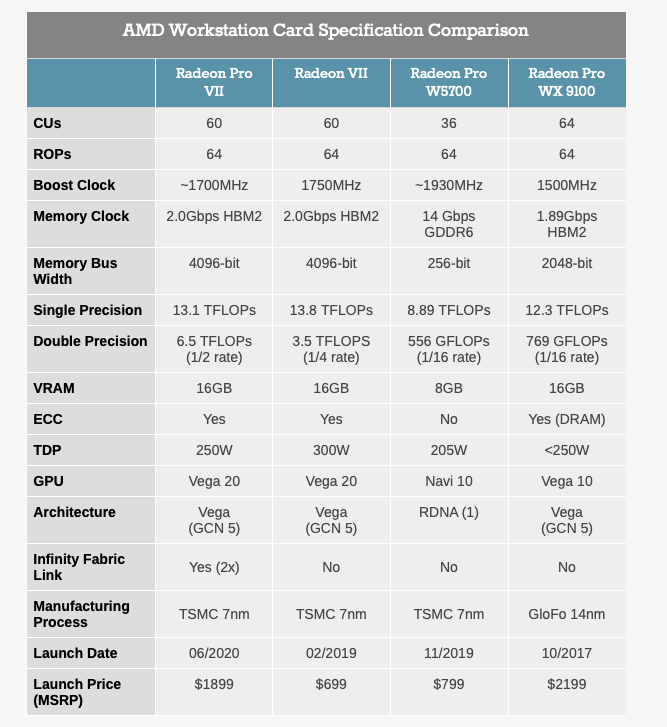

It has 1/2 rate double precision. It's basically the MI50. It has 1TB/s memory bandwidth and ECC memory.
It has spades of compute compared to the cards you mentioned. Normal Radeon VII clocks in at 3.5 TFLOPS (1/4 rate) while this gets 6.5 TFLOPs (1/2 rate). The Radeon Pro W5700X has 593.8 GFLOPs and the VEGA FE has 819 GFLOPs for comparison.
The Radeon Pro Vega II Duo ($5,600) has 1/16th rate, so only has ~881 GFLOPS double precision.
It's also clearly binned better as it has a TDP of only 250W compared to 300W of the Radeon VII.

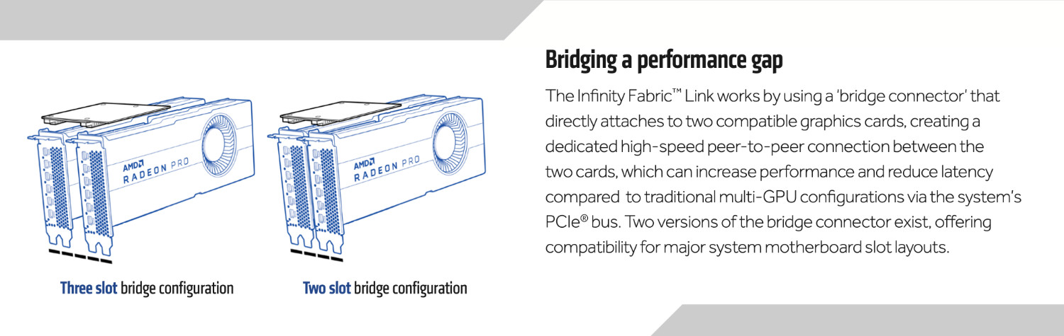

... and it uses Infinity Fabric to combine GPU memory (similar to Pro Vega II):
https://www.amd.com/system/files/documents/ifl-solution-brief-radeon-pro-vii.pdf
Largely a more affordable and simpler to make Apple Pro Vega II 'Solo'.
If specs here are right the "peak clock" is the same as the Vega II
Has the Infinity Fabric link that the plain commercial VII doesn't have. ( similar to MI/50 which may/may not be priced higher. ).
Apple may not have the 1/2 Double precision setting and didn't certify out the ECC mode but there shouldn't be a surprise here if the Pro Vega II is doing reasonably well. That means the demand is high enough to keep churning these out for now.
These are about $1K cheaper than Vega II. Loose about 16GB of HBM2 memory. ( so the VII model only needs 4-hi memory stacks instead of 8-hi . If can salvage some failed 8-hi as 4-hi then all the better).
But if can fit the two cards into a Mac Pro ( e.g., slot 1 580X , slot 2 (or 3 ) Pro VII , slot 4 (or 3) ) then could get into range of a Vega II Duo for about $2K less. And loose all the Thunderbolt , switching, MPX power elements of Apple's MPX module.
I suspect that the "Arcturus' MI100 may not be too far away and that this VII will serve as the more affordable alternative for workstations on a "close enough" GPU.
Well it should because it would be going "backwards" if it didn't. The MI50 and MI60 have had this for over a year.

On several of those benchmarks the 'regular' VII and the Pro Vega II 'Solo' are essentially tied. The additional 16GB of HBM2 VRAM isn't buying very much. If you trim that off the Vega II you'd get a more affordable card and get about a three way tie.
The thermals are down from a VII so if have some computation that has a substantively long "single thread control" block in it ( and just throw max (possibly overclocked) boost speed at it to plow through it won't do as well. But large heavyweight double precision simulations probably will do much better if have a very high "embarrassing" parallel workload.
But what workflows will benefit from double precision ? Not likely for video editing , which is where a card like this could wind up in a macOS System . Even if a single Radeon Pro VII could match the performance of Dual GPU WX9100 / Vega F.E. configuration for video editing ( both FCPX and Resolve love dual GPU configurations ) , there is significant cost savings going with the later . You can pull used Vega F.E.s off of eBay for $400 each and rebuild them . WX9100 is a different story .... for now .
Single precision compute performance of the above cards is roughly the same - what most users would use .
Same with video ECC , nice but hardly necessary .
Memory bandwidth of the RPVII would be about the only exciting feature here . It's where paper specs have a hard time showing fair comparisons . And Infinity Fabric , but ...
Infinity fabric is useful only in a multiple GPU System , so you need to plunk down extra cash for two+ of these babies .
I have little doubt both the WX9100 and the RPVII are top binned . But with proper maintenance , GPUs last a long time anyways . There might be the power savings thingy , but AMD has shown in the past they'll just make things hot and power hungry to boost performance to match nVidia anyways . We'll see when somebody deploys one .

So, simply put, how much better is a single Vega II (and Vega II Duo) over this one in a Mac?
It is really going to depend upon what workflow and those app's ability to utilize what is present.
If you are looking for a simplistic unidimensional metric then single precision (TFLOPs ) :
cardTFLOPSdelta from Vega IIVRAM (GB)DP TFLOPs
VII13.6-0.5163.5
W5700X9.4-4.716~0.618
Pro VII13.1-1.0166.5
Vega II14.1032? 3.5
Vega II Duo28.3+14.32 x 32? 2 x 3.5
The price points of all of the above are vastly different from top to bottom. Vega II has four more CU (compute units: 64 shader processors per CU. so if counting shaders 256 more) over the Pro VII.
If your workload only concurrently lights up 55 CU's at any one time then that extra 4 usually won't make that much of difference. If have significant single threaded sections the plain VII overclocked may be more competitive.
If data working set is 10-20GB big then the Vega II can handle that. If it is just 8GB then not much of a difference across the whole line up above.
So if money is no object and all care about is maxed out single precision on a single GPU die then the Vega II 'solo' is a winner if software can squeeze everything out of the chip possible. Putting money back on the table. it is about $1K more for less than a 10% gain. For some that less than 10% gain is worth $1K. For others, the over 100% gain is worth extra $3.8K

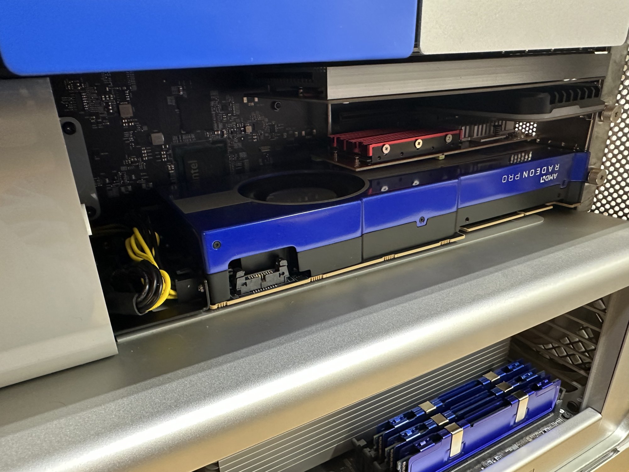

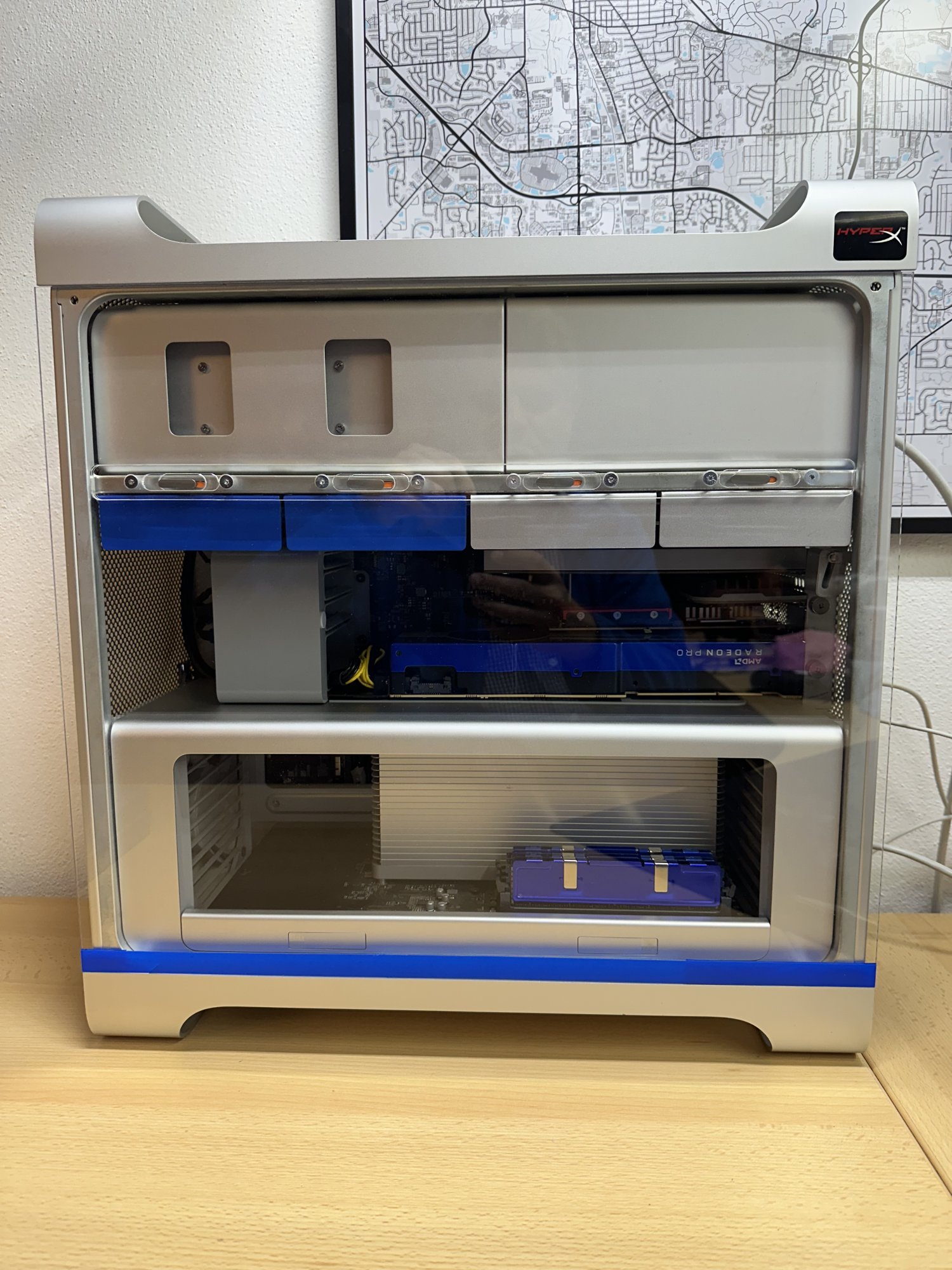

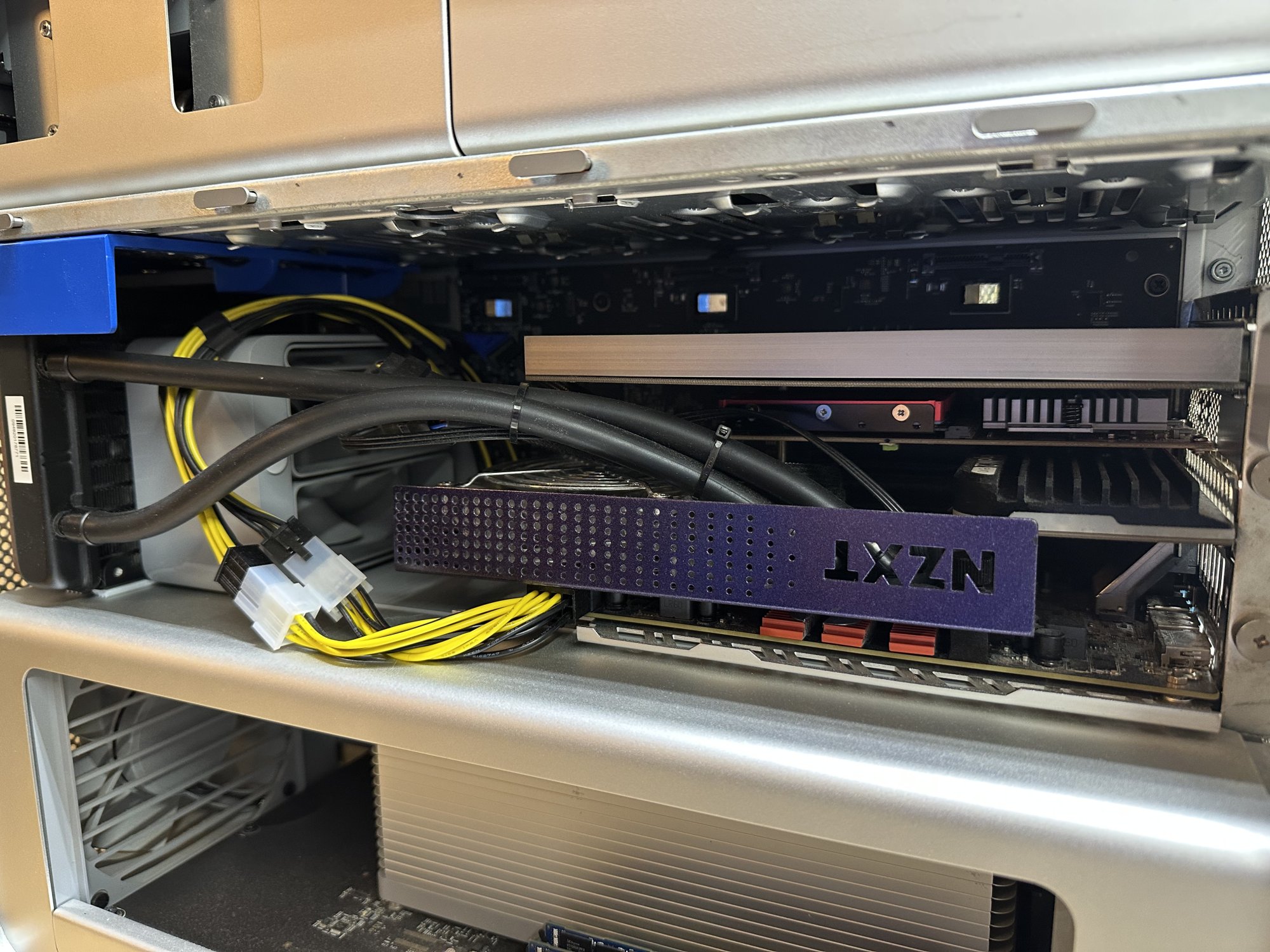

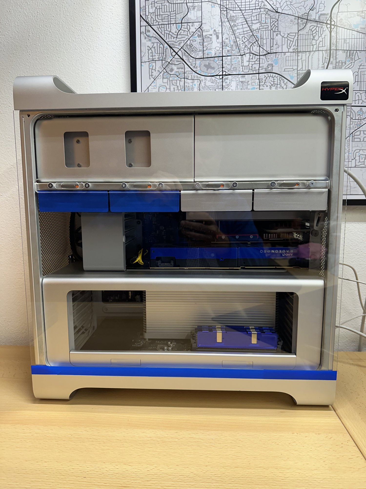

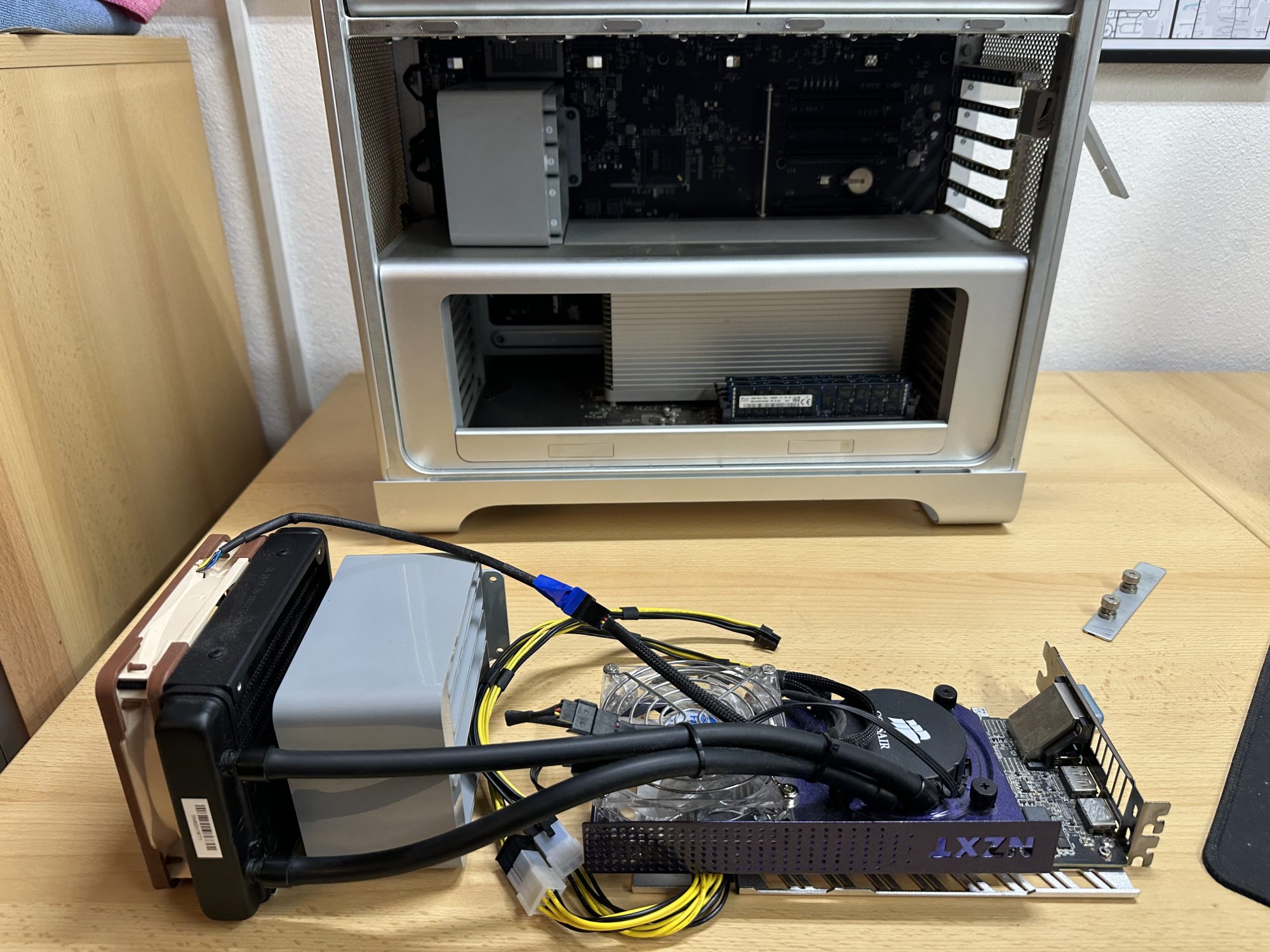

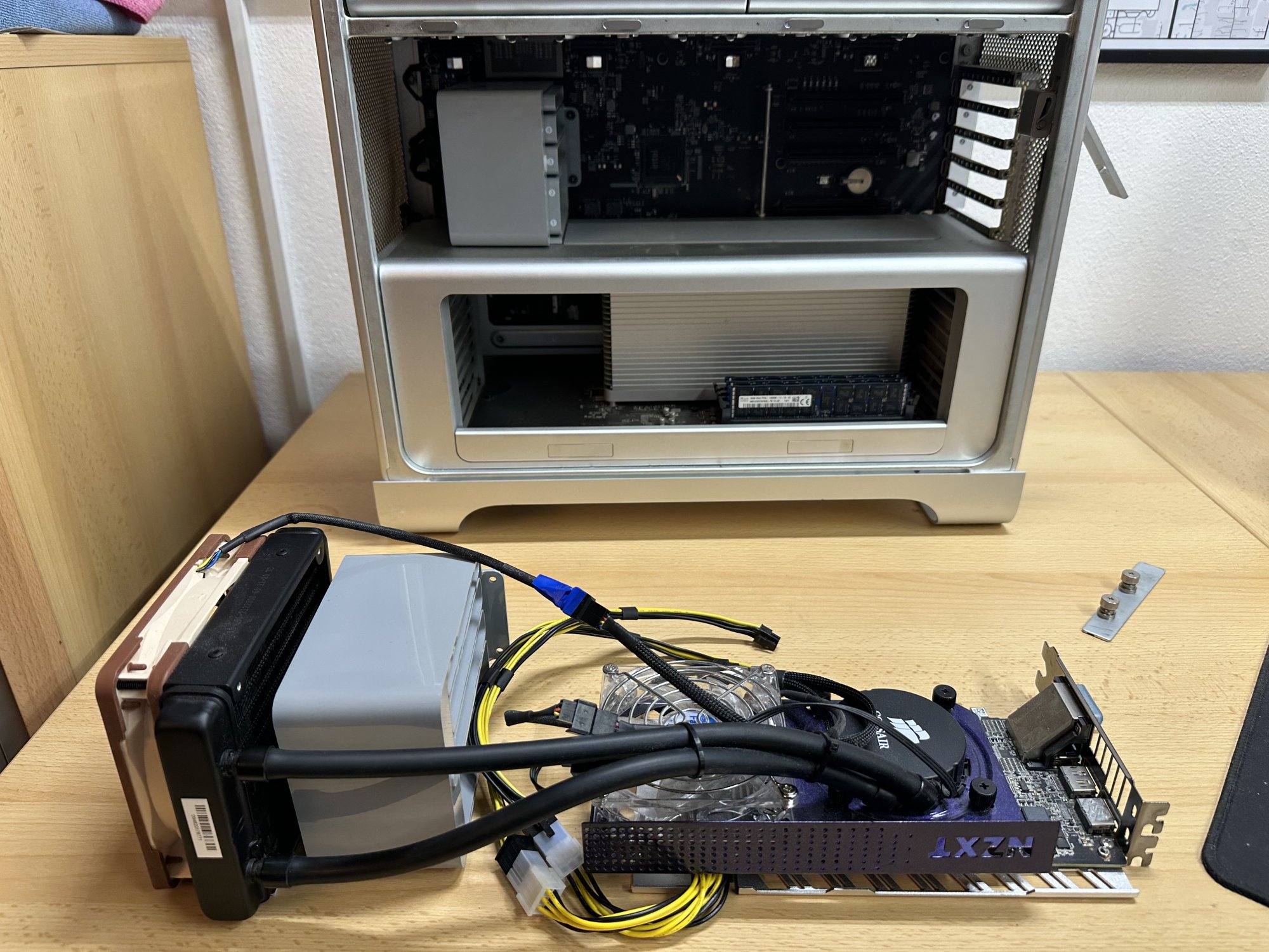

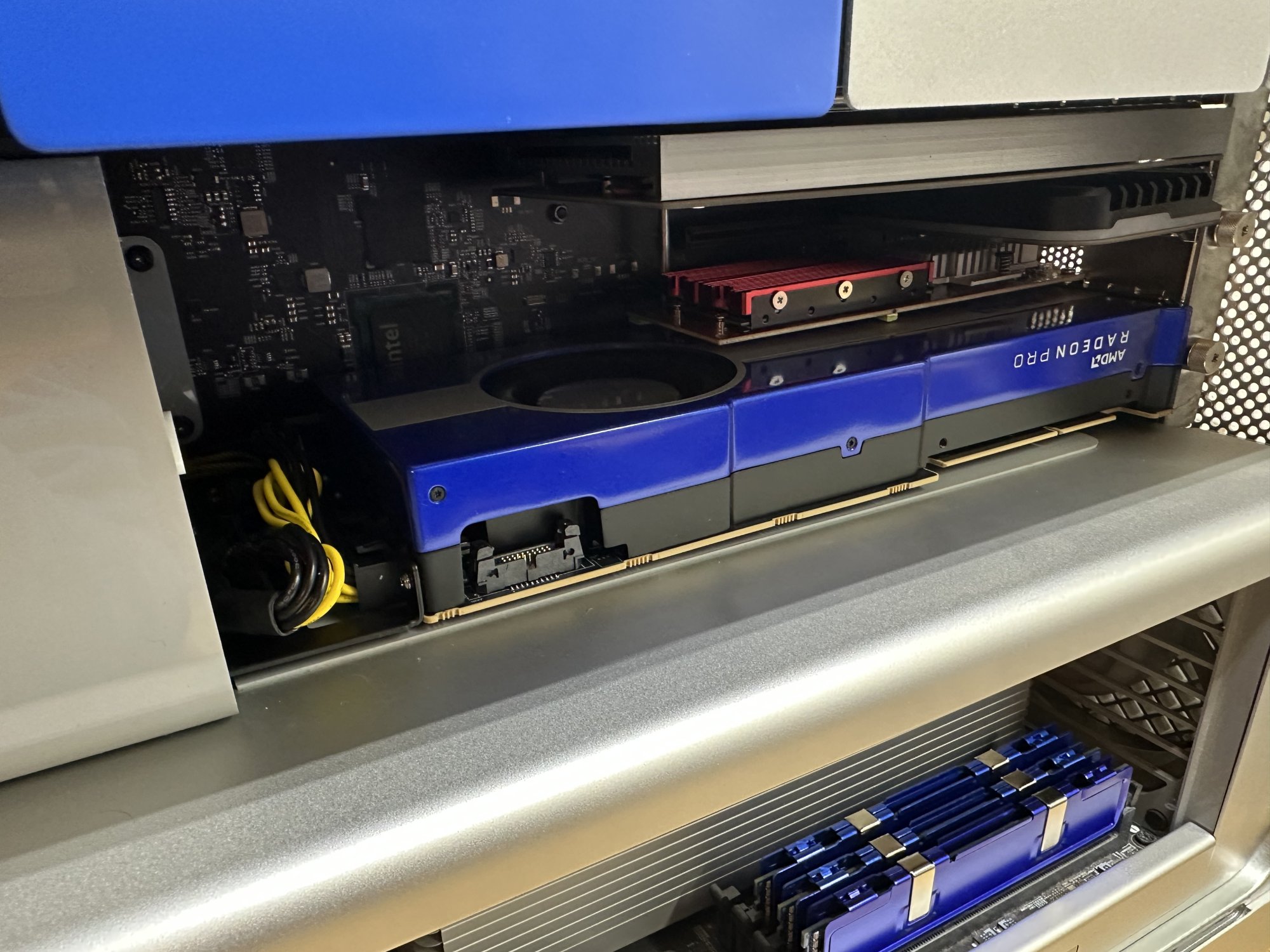

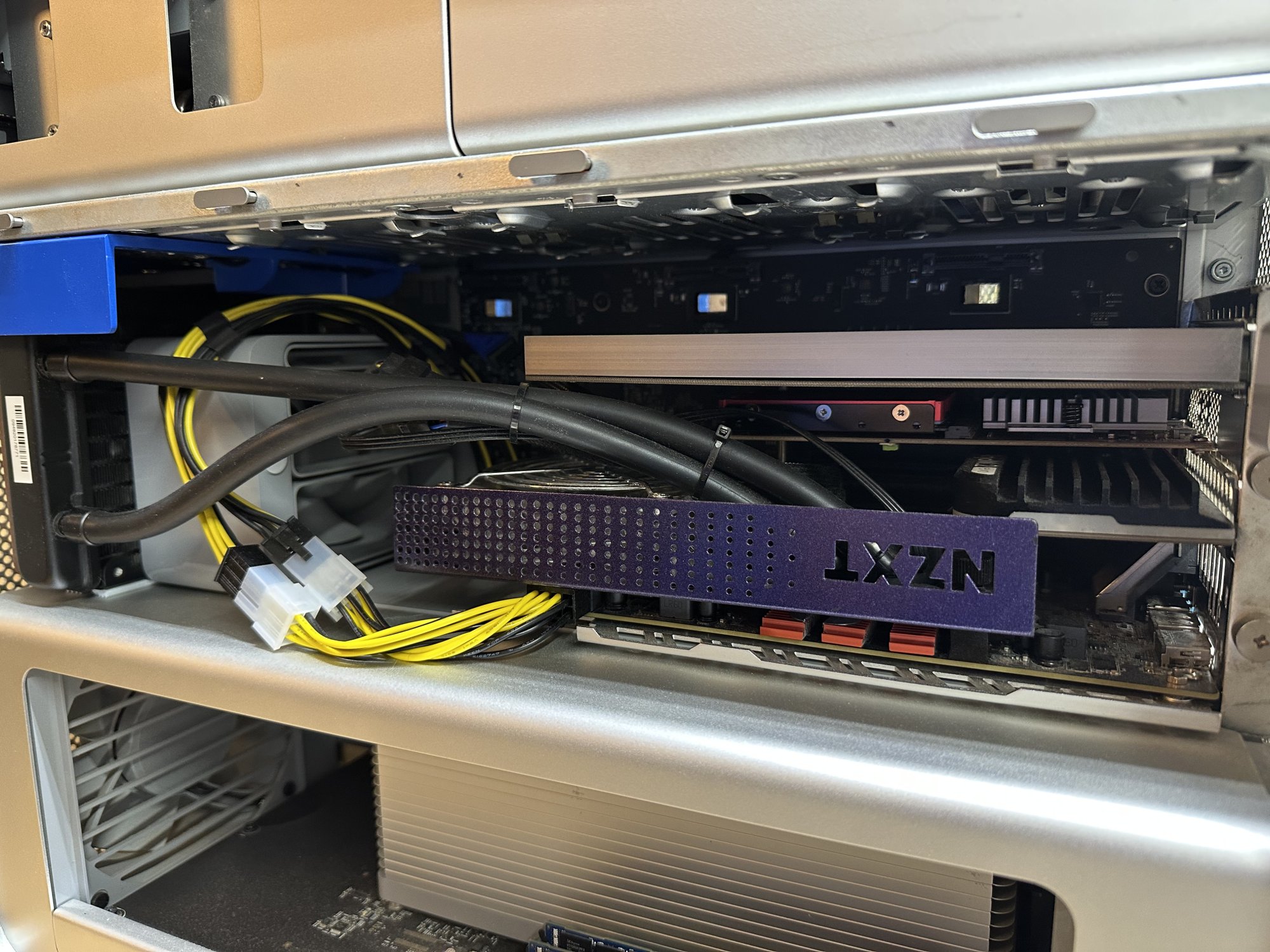

Answering your call a whopping 4 years later, I am delighted to report my upcoming project. About A week ago, I was able to snatch a brand new sealed in box Radeon Pro VII workstation card for 300 bucks. I did sent it to my friends in Poland to get it flashed with boot screens and modified device ID for a perfect fit for my 2012 Mac Pro 5.1.
More to come with a short performance review towards the end of October.
Ant
Anyone have a cMP and a Radeon Pro VII to try? I’m running an undervolted kext version Radeon VII in my own CMP 12 x 3.05. Very nice in DaVinci Resolve and FCPX. But there’s no more new ones available at less than 1000 euros these days.

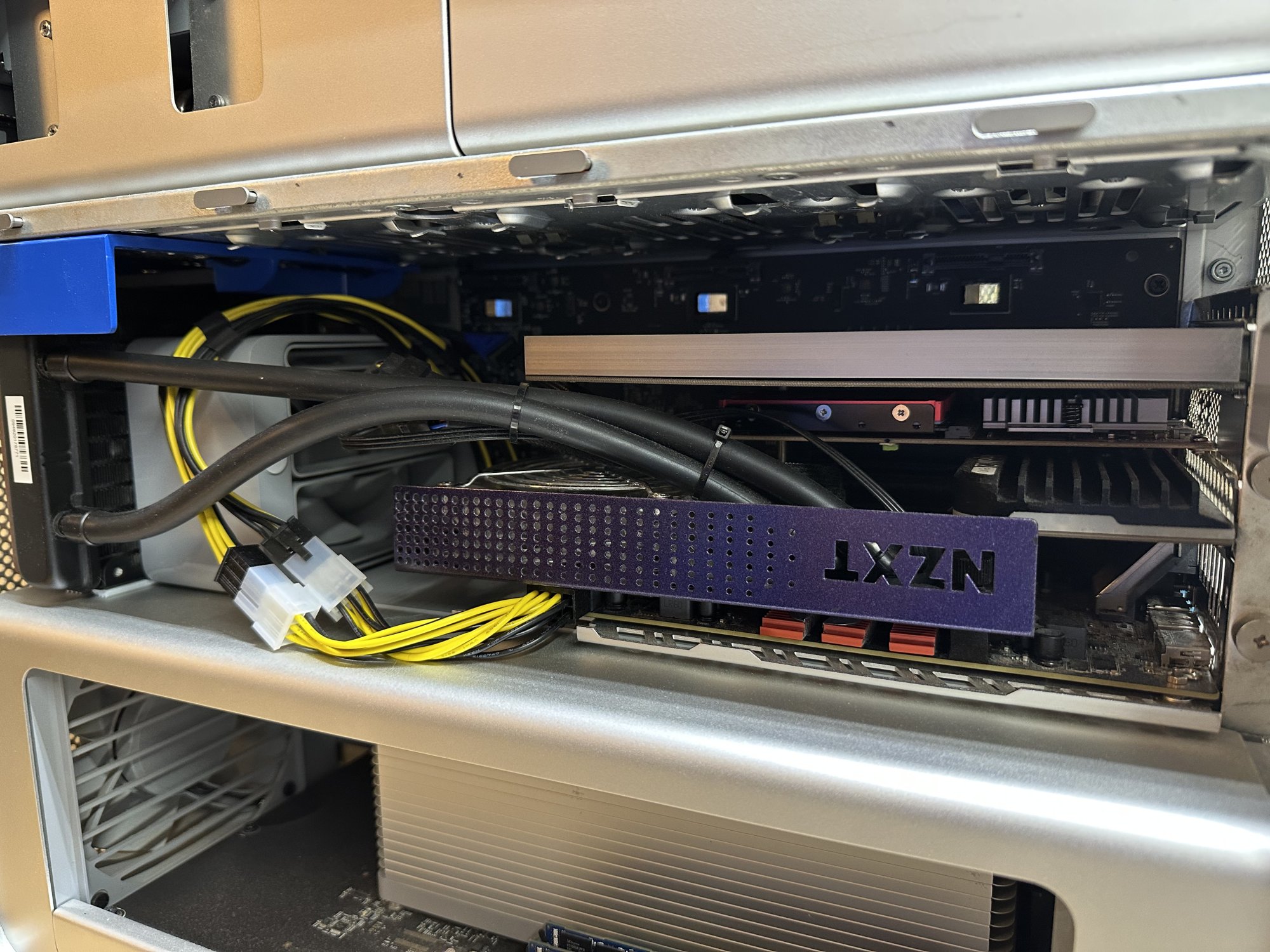

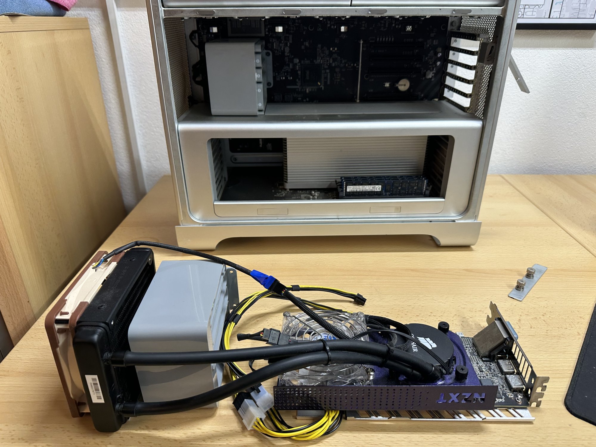

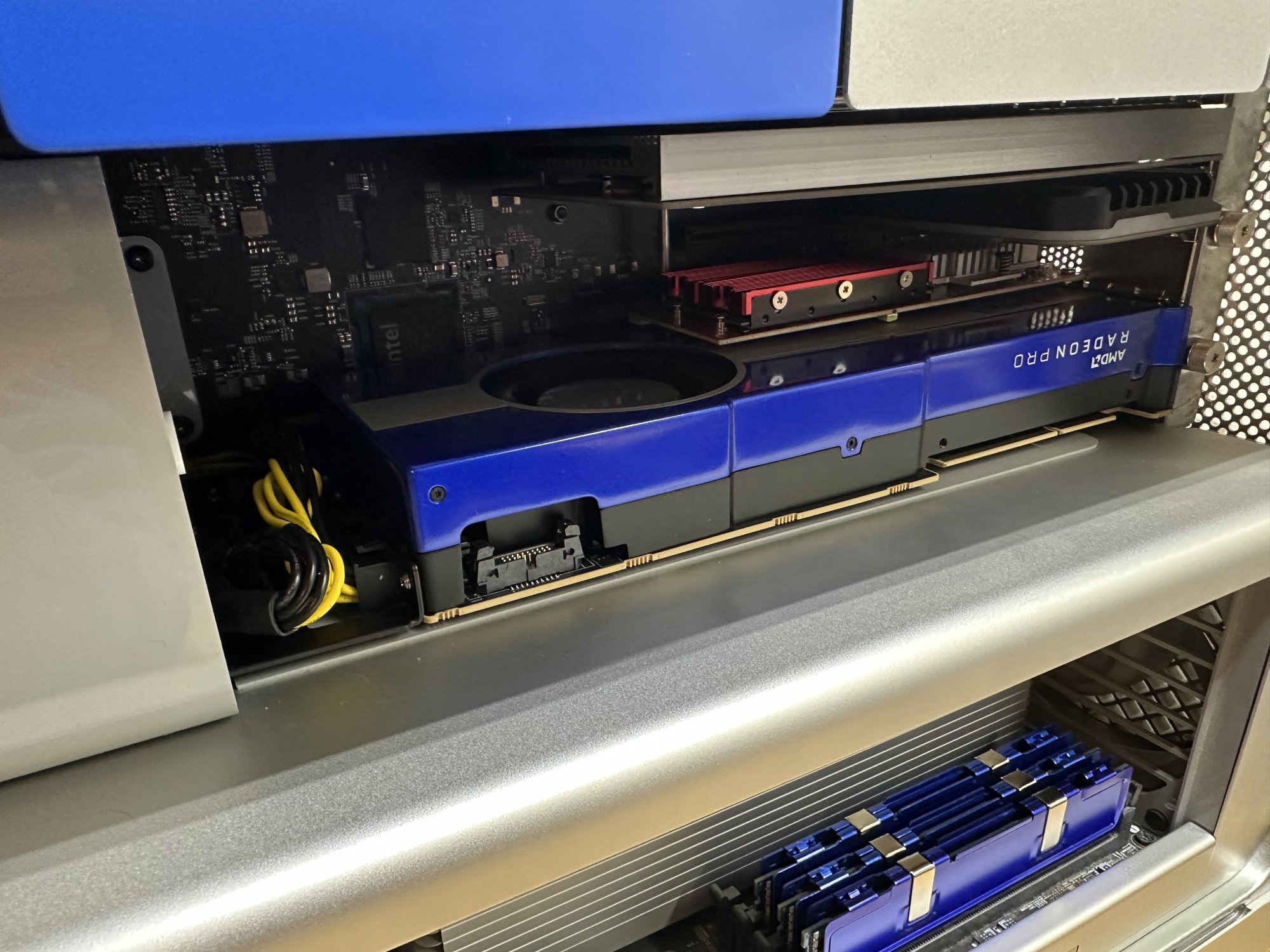

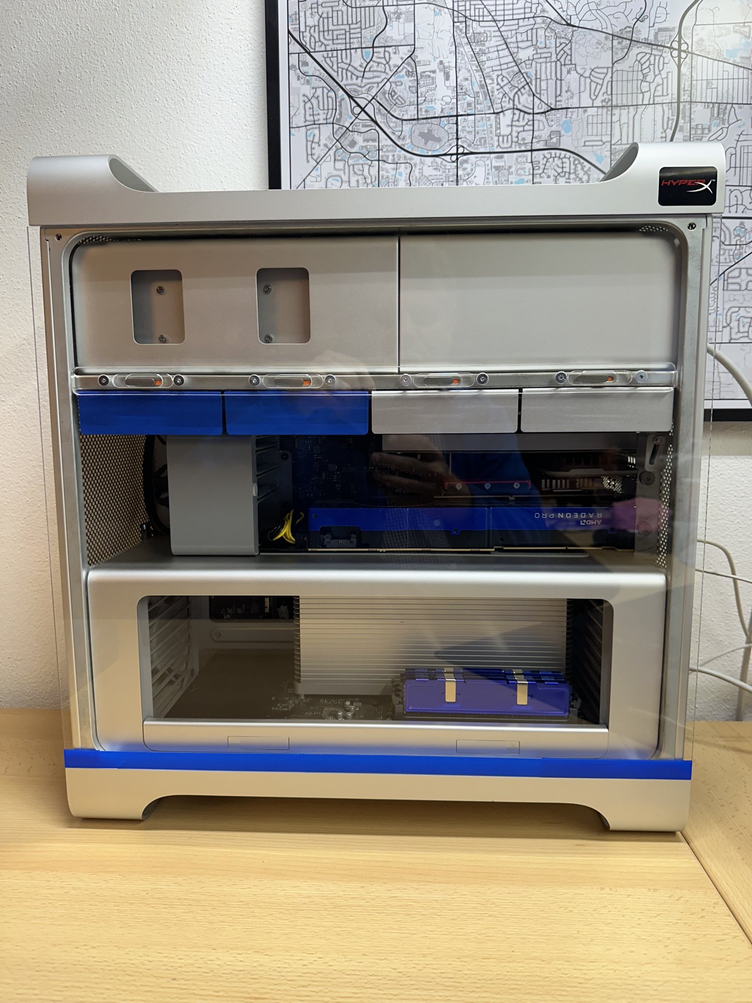

As promised, attached you see my new Vega VII workstation makeover with blue accents this time. (My dual tray is in storage at the moment)
Since I had many different GPUs in this thing I am used to the Vega VII level of performance or higher. What really really surprised me is the low noise duct fan. The reference Vega 64 / 56 back in the day was really a very bad designed and noisy card. Because of this I was very sceptical. However, since the 6800XT is not supported in the Sonoma, I sold my trusted mutant card and fell back to my 580 with AIO water block. But this time AMD surprised me full heartedly. The Radeon Pro Vega VII is very calm and the duct fan is not very noisy. I think that is the most important and surprising information. Big kudos to AMD Pro Series, they really did their homework when it comes to noisy duct fan solutions. Another surprise was the weight of that card and the fact that it's shroud is metal. It is really next level when it comes to AMD build quality. The hefty 1899,00 Dollar price tag did go somewhere.
Just for kicks, you will find my past RX 580 AIO setup attached as well.
