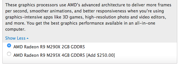

Playing a game every now and then =/= gaming machine. Say for example Simcity or something that isn't a crazy first person shooter with crazy high resolutions.
I think something like that would fall under what Apple advertises.
Source Apple.com
