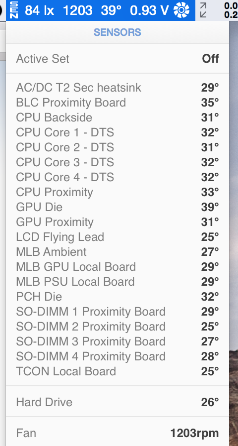

I downloaded Macs Fan Control (no desperate tries to make any bad taste humour of it this time), set the fan to constant maximum of 2700 rpm, it took only 5 minutes of play with Tomb Raider (2013) to achieve GPU temp 104 C (and possibly it's not even top of it).
Also note that this temp was reached with fan running maximum (2700 rpm) which iMac nearly never puts (as the automated controlled maximum is usually 2300 rpm). But even with that maximum what fan is capable of this cooling system of Retina iMac seems complitely insufficient for any modern PC gaming. Also the air output in the back of this machine that is a size of an small matchbox is just a joke.

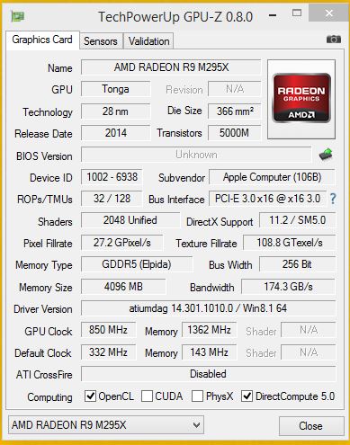

For those looking to run more benchmarks, a new version of GPU-Z appeared recently that now officially supports the M295X: http://www.techpowerup.com/downloads/2463/techpowerup-gpu-z-v0-8-2/

I was using Win 10 with the last beta driver from AMD, with afterburner you can have that type of logs, let me know if you need other informations.
if you're going to do that, you should both make sure you record room temperature as well
I made a quick test also with that, I kept the heater on for a night reaching 30° in the room but with no difference under load (only a slightly higer ilde temps), consider that I live in a hot place where even in winter is difficult to have less than 10°C outside and I keep usually an inside temp around 23°C
Are you refering the new AMD Omega drivers, that does not yet officially support m295X but can be installed by instructions here?
Or possibly the AMD's official Bootcamp drivers published in Dec 2014, listed here?
Currently I am using the original bootcamp drivers Apple provides, but it's not a problem to upgrade them. However I hardly believe drivers would affect the temperature at all.

For the record, my idle temp are very low:
