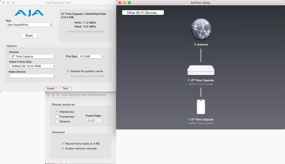

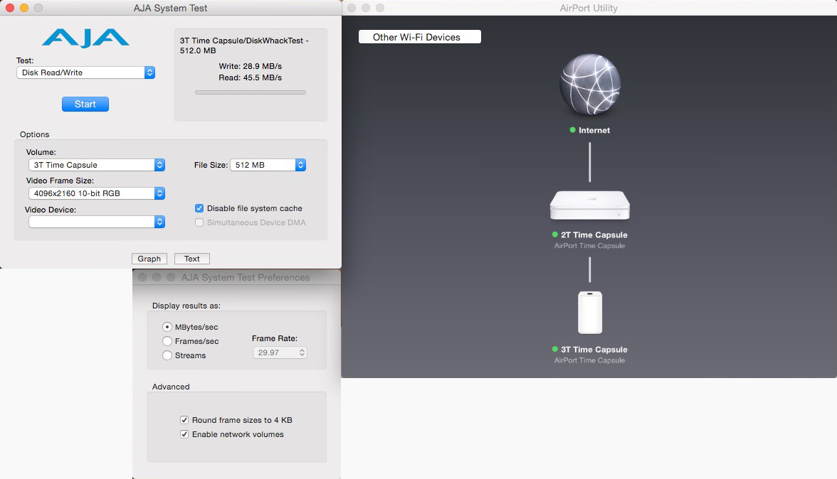

2) Ethernet to TC for media storage...
If you only use the TC as media server, should not be a big problem, but the read/write speed will be slower than normal HDD operation due to the ethernet speed limit (and TC is not design for high performance network storage operation). The 1000Mb/s is theoretical limit, you will never achieve that speed. Speed test in my current generation 3T TC shows the following figure. (This TC is not full yet, still has 128G free space, so this number is more or less the same as what you can get).
It's good enough for streaming, but it may be relatively slow when you managing the video (e.g. copy a large video to the TC).
However, if you use the TC for backup as well, then it's another story. There will be end up lots of fragmentation in the TC HDD, and it will make your TC getting slower and slower for media operation. The following figure is from my 2T TC, which is fully loaded for years, so lot's of fragmentation. And this is the performance you can get from the same test when backup also in progress.
As you can see, not much better than a USB stick, and imagine how frustrated will be if you want to copy a 10GB video to that TC with this speed.

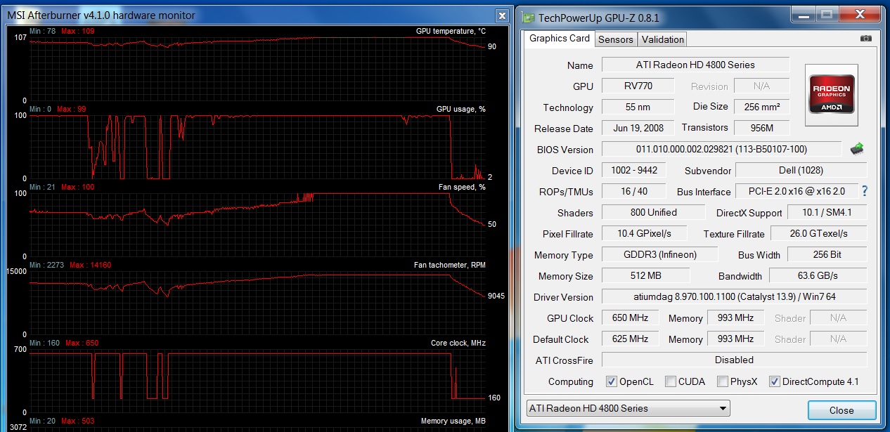

Two weeks ago I had the occasion to do a test on a 5 years old Dell Studio Xps, with the AMD 4850, the temperature in games was constantly at 108°, we are talking about a 5 years old mainstream and gaming unit, bought and used for years by many thousands of users and nothing happened in all these years.
You can talk about fan noise, but when there's no performance issues or fried units it'all paranoia.
The Dell's card is a Reference design 4850 desktop board:
And at 14K rpm it's loud, a lot loud, not even comparable to the 5K
[url=http://s16.postimg.org/5686h1hb9/AMD_4850.jpg]Image[/url]
Wow, more FUD.
Did you stick a pencil in the fan to get it that hot? Or maybe you are looking at the Fahrenheit scale?
Interesting in that Tom's Hardware did find the 4850 to be hottest card in this test:
http://www.tomshardware.com/reviews/radeon-hd-4870,1964-17.html
But somehow their record heat production on this card was 87C. Note that the chart's last number is 90C and no cards posted numbers past 87.
So, just 21C cooler than yours. Hmmm....
Meanwhile, 2 inches away on the 1 piece logic board it is only 50-60C. This is referred to as "thermal stress". Similar to the radiated heat hitting back of that pricey 5K display less than 1 cm away. That is called "cooking".

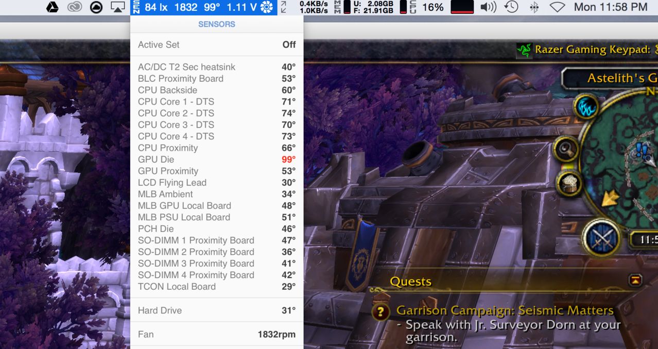

According to iStat menu everything but the GPU and CPU inside the 5K is running under 50/60C even after hours of stress, have you ever read the average temps on a macbook air or a macbook pro ? Now I'm using a MBA 2012 with is way hotter than my 5K, If I run WoW here I can have even 105 in the CPU with all the other components very hot too.

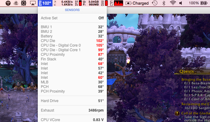

Honestly, I'm more concerned about my Air than the 5K ! :)
MBA 2012
[url=http://s3.postimg.org/f3yo62sqr/Screen_Shot_2015_03_17_at_00_14_12.png]Image[/url]
5K
[url=http://s3.postimg.org/bcon0dy4j/Screen_Shot_2015_03_16_at_11_57_35_PM.png]Image[/url]
