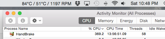

I just installed an update to iStat Menus. The GPU die temperature seems to have dropped by 5C...
Tests run:
Gaming, GPU hit 100C at 2300rpm, where before it would reach 105C
GPU benchmark: 102C at 2300rpm, before would go to 106C or so
GPU + CPU benchmark: up to 103C at 2700rpm, fan drops to 2300rpm when CPU benchmark finishes
All done in OSX. The CPU temps didn't change much from what I remember. Maybe it is just different room temps, so maybe someone else can have a new look?

This is interesting, in my case I have no difference after the update.
Maybe the difference in the iMacs are just the sensors and we are all running the same real temps :)
AMD Radeon R9 M295X Core Clock Throttling, Heat, and Performance
At this level, a difference of 3-5C becomes irrelevant.
The thermal throttling exists, regardless of what temperature is reported. The components are still over 100C, the fan is still at max speed, and the core clock speeds of the i7 and M295X are being reduced as they reach these extreme temperatures.
Does it really matter? Probably not, unless it bothers you.

I also tried that - result: nothing changed
Like i said: Lets wait for a smc update ;)
