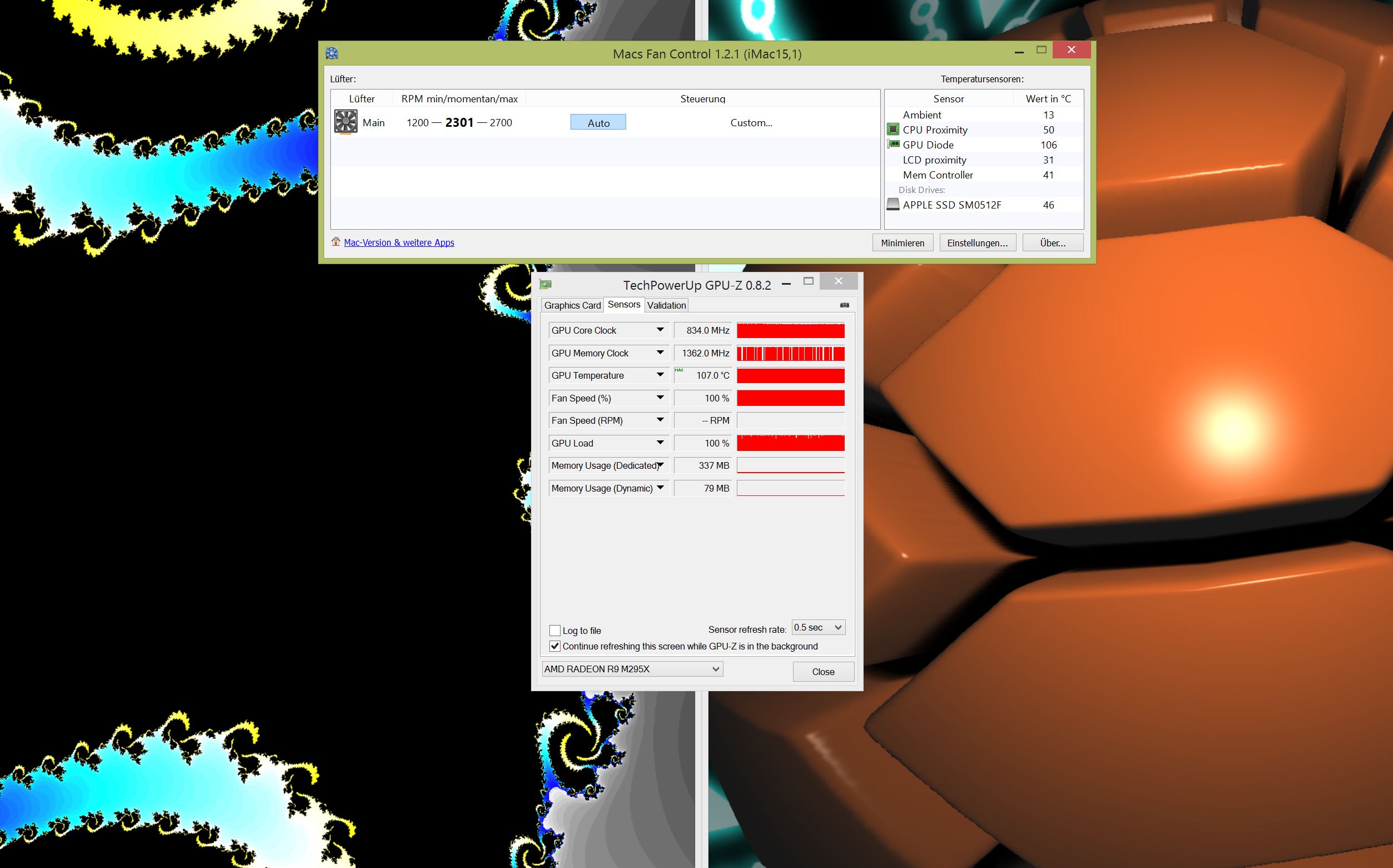

Hi folks, i ve made a 24h stress test marathon. Yesterday on the Bootcamp partition (Windows 8.1) i started Tessmark64 and PixMark Julia FP 64 at the same time and let them stress the m295x for 24 hours. I guess thats more interesting than a 30min-2h short time test.. here is the todays result:
Everthing seems ok, the stress test was still running - no restart, BSOD or sth else ;)
Same 107°C reached like ioxakoyba but obvioulsy not the heavy "throttling" point of 108°C (i know its a dynamic clock rate - no throttling in the original meaning) so i wouldnt have noticed any framerate drops in this specific run :)
