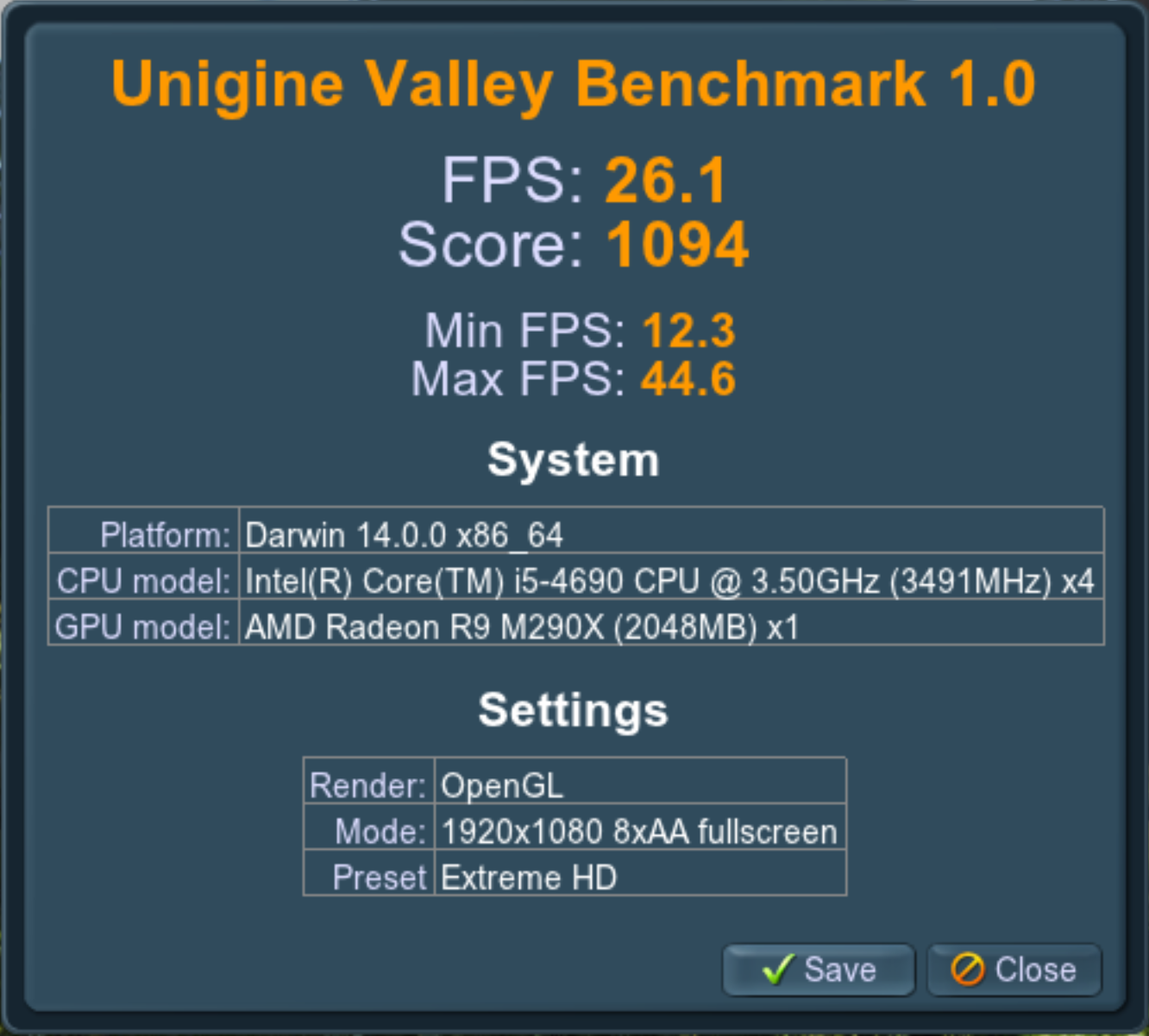

I have the i5/M290X combination.
Can't help you with wow, but subjectively even the maximum GPU heating situation is really not bad. For instance, running the Unigine Valley ExtremeHD preset (easily enough to throttle an M295X) for 45 minutes and then benchmarking I got fan speed ranging from 2004-2124 RPM (checked it 6 times throughout). It was different at different points in the benchmark but you could not hear it changing.
Temperature was 86-88C throughout.

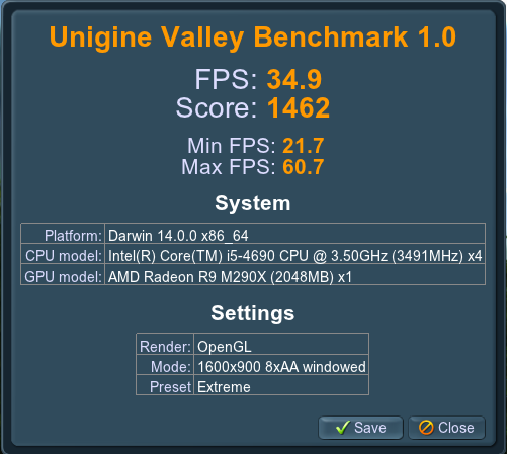

Interesting! Would you mind running it in 1600x900 windowed? Same quality settings. I'm interested in how it compares to the others.
Here you go. Same fan and temps observed. Although since the average FPS speedup for games from the M290X to the M295X has been shown to be about 20%, and the Unigine Valley benchmark speedup was pretty negligible, so it's a little unsatisfying.
Thanks a lot! Yeah there's barely any difference between the different iMac GPUs at those settings. That's really interesting. Especially since both 780M and 295x are supposed to be upgrades. I know, you can't base it all on one benchmark. Still interesting though.
GTX 780M - 34 fps
GTX 775M - 37 fps
R9 M295X - 37 fps
R9 M290X - 35 fps
