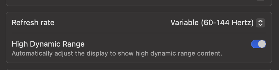

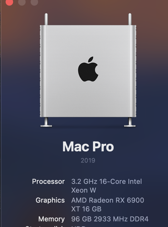

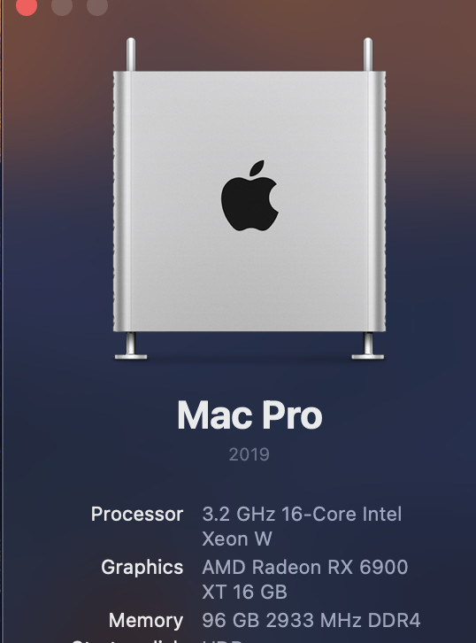

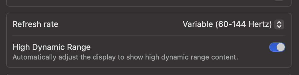

Courtesy of @caingraywood:
1650536306200-png.1994480
1650524931122-png.1994432
1650524963695-png.1994433
