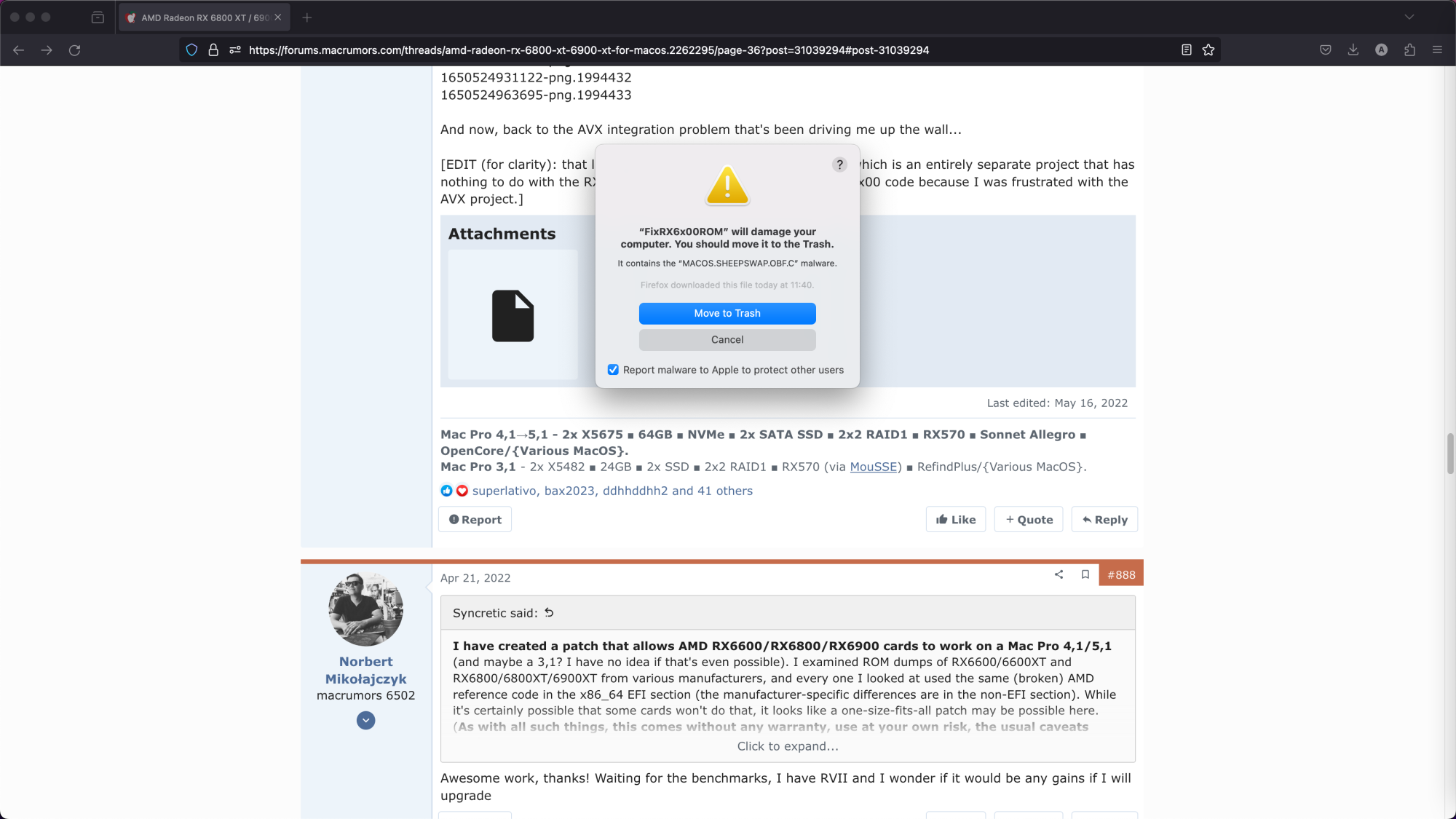

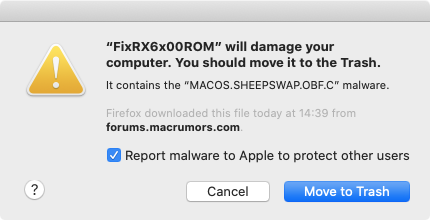

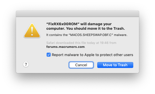

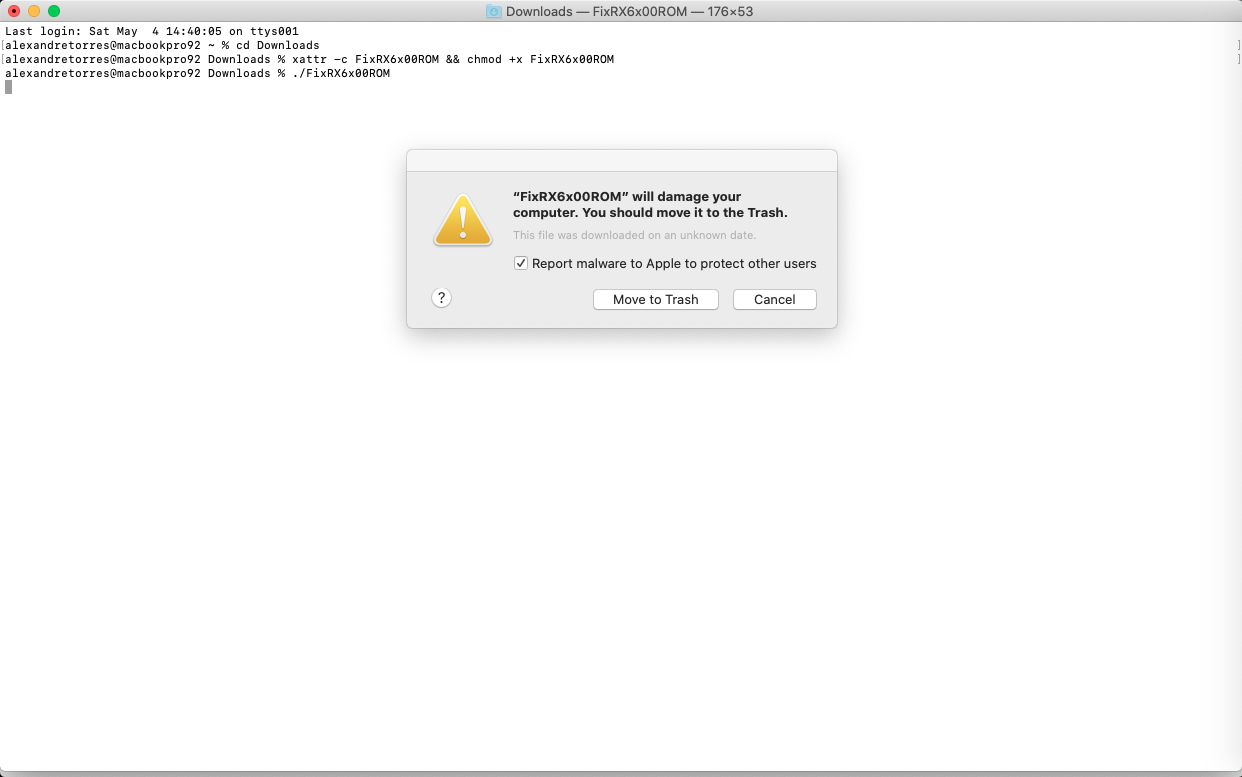

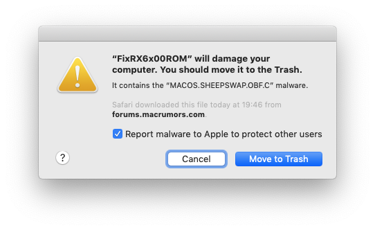

Apple started to identify FixRX6x macOS binaries as malware, after searching about it this is happening since January XProtect update:
Just updated xprotect, for me it works on Mojave:
Code:
$ xattr -c ~/Downloads/FixRX6x00ROM
$ ~/Downloads/FixRX6x00ROM
FixRX6x00ROM v0.11
Usage: /Users/username/Downloads/FixRX6x00ROM {ROM filename}
Worked also on Big Sur 11.7.6 after Xprotect updates on a MBA 6,1
Seems it depends.
Also discovered: When I run the tool directly in Terminal it worked on Mojave and Big Sur (before xattr -c).
But if started via Finder it gave the Xprotect message.
Code:
% xattr -l ~/Downloads/FixRX6x00ROM
com.apple.quarantine: 0083;663679e8;Safari;0AD332A4-6003-4B47-B6B8-DB49BBC4B9F3
% ~/Downloads/FixRX6x00ROM
FixRX6x00ROM v0.11
Usage: /Users/user/Downloads/FixRX6x00ROM {ROM filename}
edit:
what we also can try, if it don't works that way:
Code:
xattr -d com.apple.quarantine ~/Downloads/FixRX6x00ROM

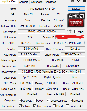

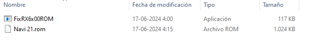

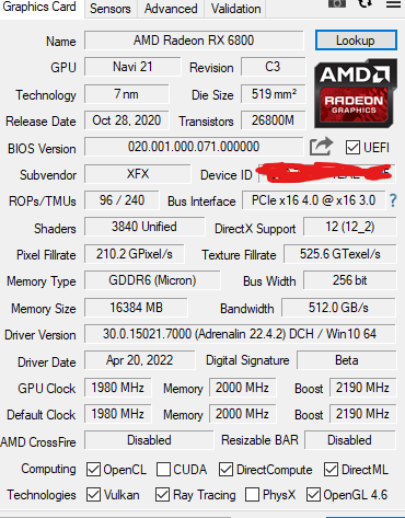

I'm trying to flash a Radeon RX 6800 Swift. When I load the Navi 21 ROM into the Syncretyic FixRX6x00ROM tool, it doesn't produce the patched BIOS. According to the Mac Sound Solution video, I should just drop the Navi ROM into the Syncretyic tool for it to patch, but nothing happens. Should I uninstall my antivirus software? I've tried everything, including installing the 2022 drivers for the 6800 and the 2022 versions of GPU-z.
View attachment 2389575View attachment 2389576
are you logged in as administrator? When I did this I was using Windows 10. The drag and drop method worked for others as well. But you can try the method Syncretic shows in his OP.
Yes, I'm logged into Windows 10 as an administrator. I think I'll need to take the long route. Is there a YouTube video that shows someone doing this process? I apologize, but I'm not very good with codes.
Send me your rom and I can see if I can patch it on with my 7,1 with Windows 11. macsoundsolutions@gmail.com normally you just drag it on syncretics patcher and it creates a copy. I am not aware of a video that shows how to do it via the command prompt
Thanks Lance,
I really appreciate you taking the time to help me out with this. It's going to be a lifesaver!
I've attached the RAM to this message and I'm also sending it to your email.
  • Navi 21.rom.zip
Thanks Lance,
Ok so seems there is an issue with your .rom file. I was able to patch my old rx6800xt file again with know issue in Mac OS using terminal in Mojave, Apple sees the patcher tool as malware in Monterey 12.7.5 and wont run the app, but I did get it to run in Mojave and it shows the issue below. Did you buy this card used? I just went through hell and back with a RX580 that had a modded bios and once I finally flashed it back to it's original bios all was good. I think your bios has been modded and you will have to first flash it back to its factory bios / rom or download the factory bios and then patch that, or Syncretic has some patched roms on his post with the app and you could try one of his pre patched files but thats a bit more risky. I tried in Windows first and then in Mac OS so I think it is your bios, as mine patched again without issue. UGH! To patch in Mac OS put the .rom and the patcher tool in a folder on your desktop then launch terminal and just drag the patcher into the terminal window and then drag the rom in the terminal window and hit enter and bingo it creates the patched rom. I would just grab your cards rom https://www.techpowerup.com/vgabios/ and try patching it, then flash it to your card. The only problem you might run into is you need to use the older ATIFLash version or you may get the miss match error and it won't let you flash the card, this is what I learned yesterday the hard way.
Here is the message that reports the problem:
"FixRX6x00ROM v0.11
The file /Volumes/SYNCRETIC/Navi 21.rom does not appear to contain a copy of the reference RX6600/RX6800/RX6900 code.
This patch could not be applied. No output was generated, no files were modified"
Reactions: AlexMaximus
Hi there,
I encountered a problem with the Syncretic tool as it wasn't patching my ROM, and I wanted to share how I fixed it. My issue began when I tried to flash my RX 6800 on a PC with Nvidia drivers instead of AMD drivers. This caused my card's BIOS to become corrupted. When I tried to restore the original BIOS from [TechPowerUp](https://www.techpowerup.com/vgabios/?architecture=AMD&manufacturer=&model=RX+6800&interface=&memType=&memSize=16384&since=), I used AMDVFlash but got the "Subsystem ID P/N Mismatch ERROR".
Many videos suggest forcing the flash using CMD with the -f command, but I kept getting an error saying the command didn't exist. To solve this, you need to download the latest version of AMDVFlash, run the installer, and open CMD as an administrator. Then, type `cd` followed by the directory where your AMDVFlash folder and the original ROM are located. In my case, it was `C:\Users\ADMINISTRADOR\Desktop\flashfolder`.
After pressing enter, type `./amdvflash.exe -p 0 XFX.RX6800.16384.201112.ROM (the ROM you downloaded) -fv -fp`
Some videos mention unlocking the ROM, but for the latest version of AMDVFlash, this command isn't necessary. Once you've done this, you can follow the steps in Mac Sound Solutions' videos on his channel. It's important to use version 3.31 of AMDVFlash for this final step.
Additionally, if you are doing this process, I don't recommend installing the 2024 amd drivers for your card. Instead, use the 2022 amd drivers.
