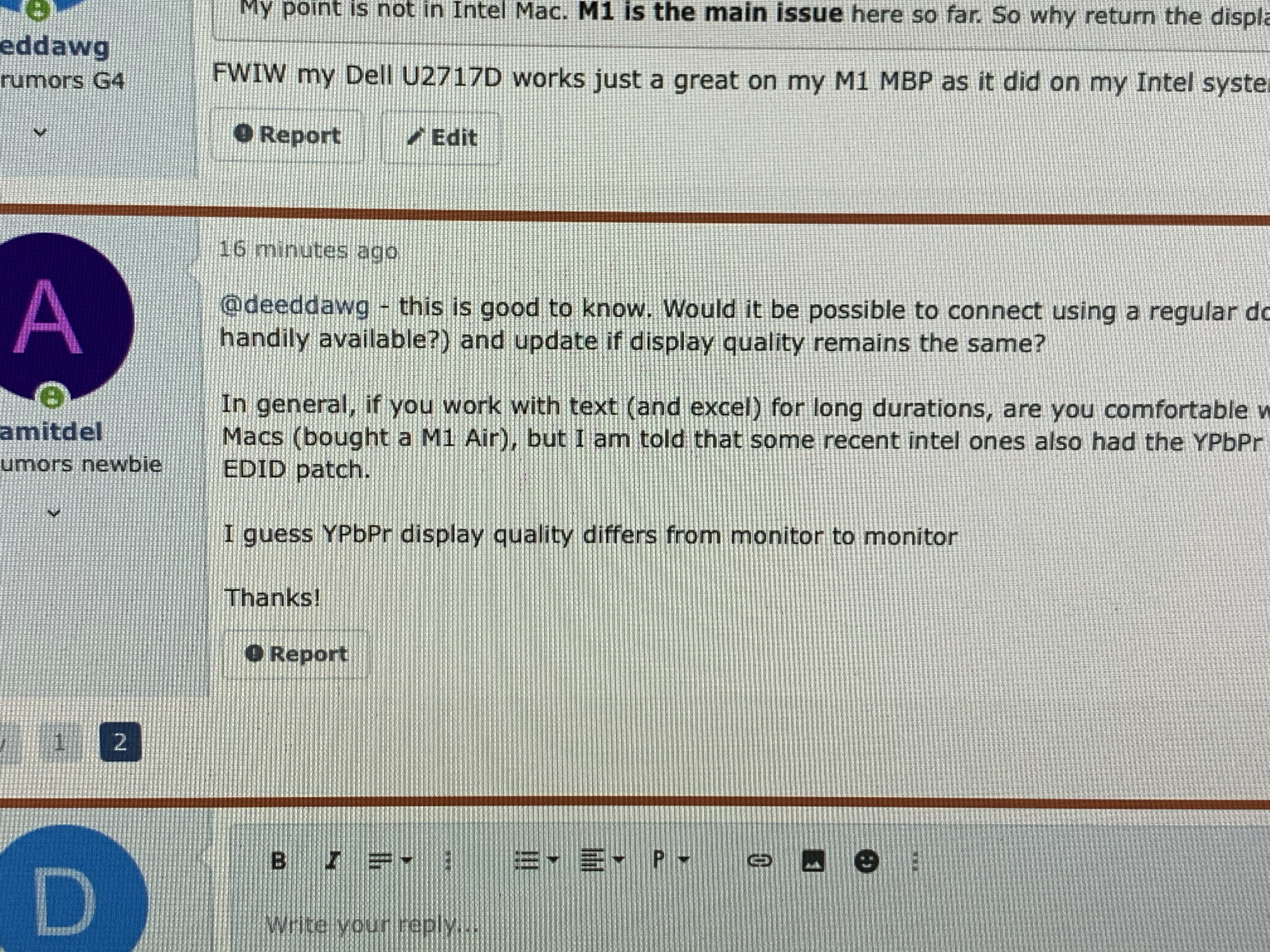

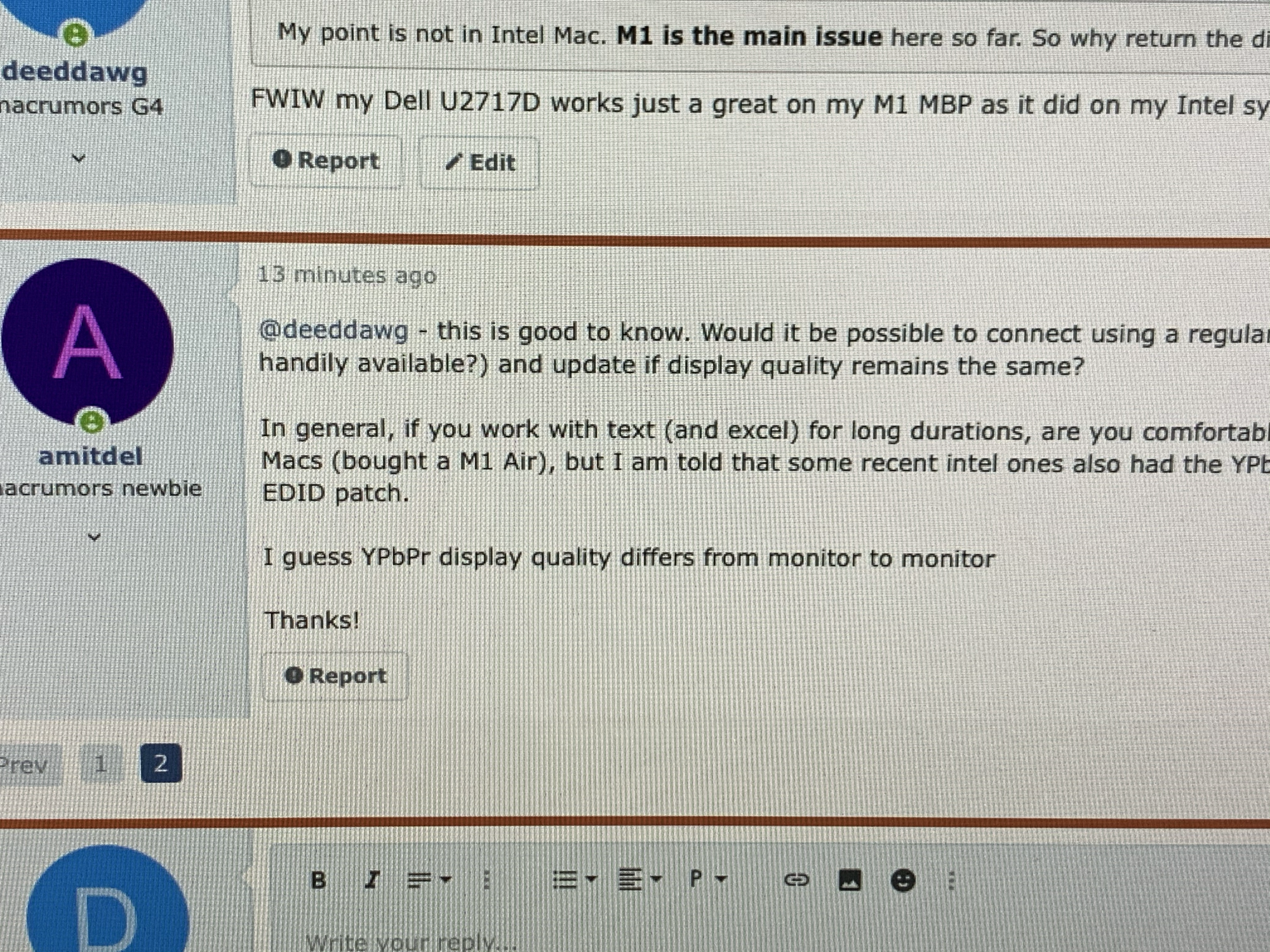

Your lucky day, I happened to know where my direct USBC to Displayport cable was sitting. :p
No apparent difference to my eye. Snapped a couple handheld phone photos that may be helpful. One using the direct cable and one using the TS3+. Both are Displayport and I verified YPbPr via OSD. Note - any color differences would be due to autowhitebalance; the monitor was visually identical whichever way I had it connected.
Although I don't use Excel on this monitor, I do lots of text based stuff (web / email / etc) and it's been perfectly fine.
Note - I've adjusted my font smoothing as mentioned before, and I've also tweaked the "sharpness" setting in the monitor's OSD controls. 50% seems to be the sweet spot.
