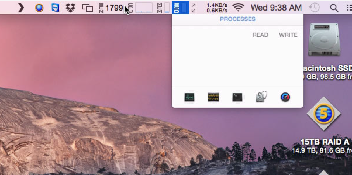

Disk temps = yes. Disk activity = nope. I also recommend turning off iStat Menus SMART utility, because SoftRAID has its own - once per day, and iStat polls far too often, causing many, many spin-ups and spin-downs of disks throughout the day.
I'm attaching the issue with iStat and disk processes.

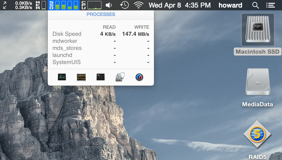

I have currently have 4 disks active and showing capacity in iStat here:
I only get 4 disks in the temp list however, perhaps that is all that have readings.

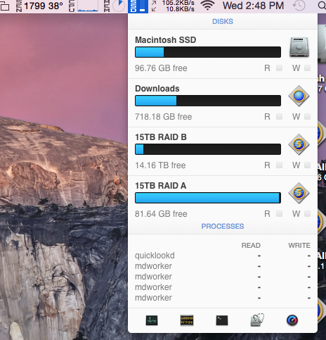

Right, but that's not what you're supposed to see. :) This is what you should see.
Ok ... I see what you are missing. :eek:
I thought you weren't getting the bar-graph disk capacity symbols on the menu bar. You are correct, I don't get the pull down report with the update either, which I did previously (I don't utilize that function all that much myself).

Well, this is getting a bit confusing. I loaded the iStat update on 3 machines so far and the disks display properly in the iStat pulldown on all but the iMac.
So ... I went back to the Retina iMac where it didn't show the disks in iStat, and I ejected my SoftRAID 5 array ... and the disks are now displaying properly in iStat. But ... this SoftRAID 5 system is NOT using a ThunderBay, it is using a QX2 in JBOD mode over eSATA (via Caldigit TS2 dock) ... so it may not be the ThunderBay but SoftRAID 5 causing the problem?
However, my cMacPro is also using SoftRAID 5, and it DOES display the disks in iStat properly after the iStat update. The difference is that the SoftRAID5 disks are "internal" disks rather than "external" disks on the PCI or Thunderbolt bus.
More testing is in order ...
EDIT: after loading the latest build provided by iStat (tnx to WilliamG :) ), the problem is resolved and this system also works properly
