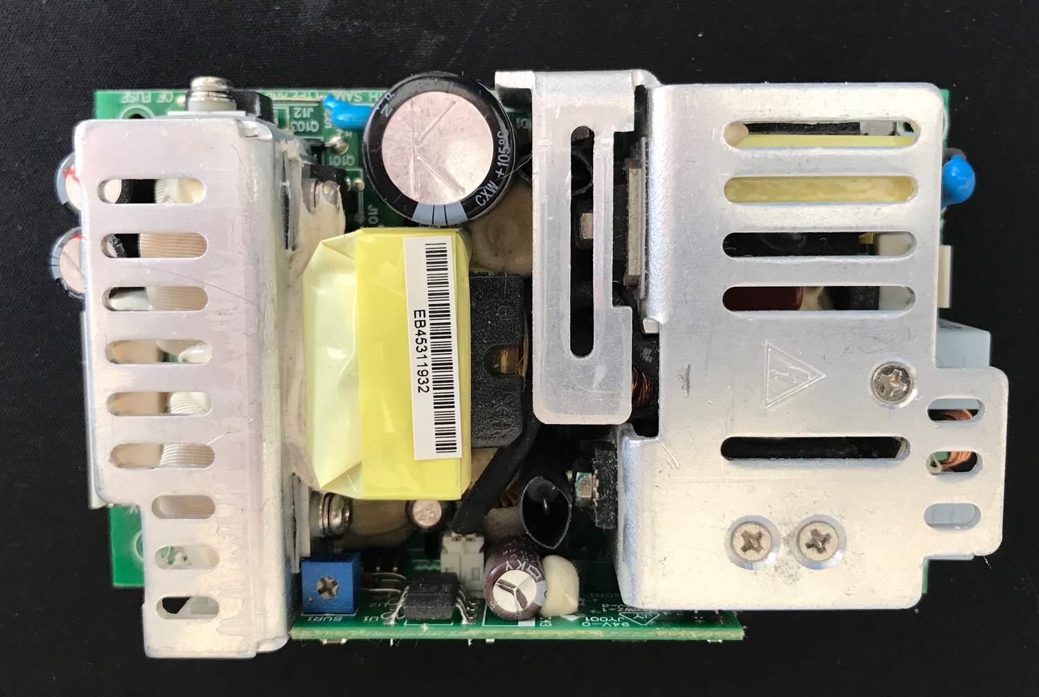

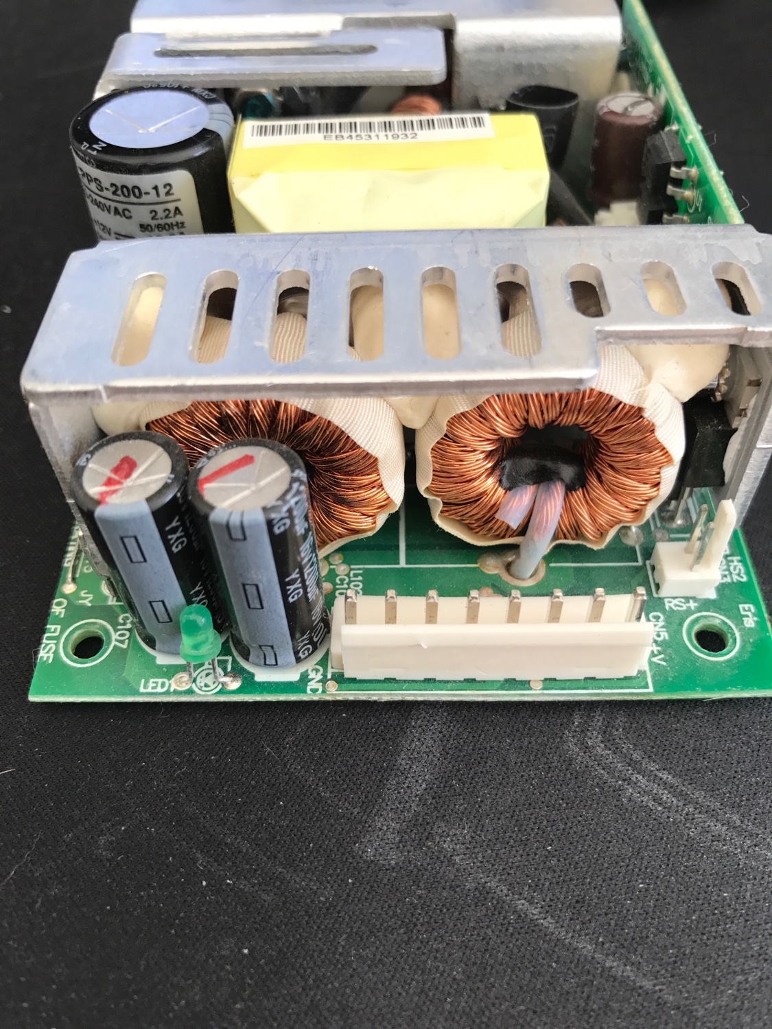

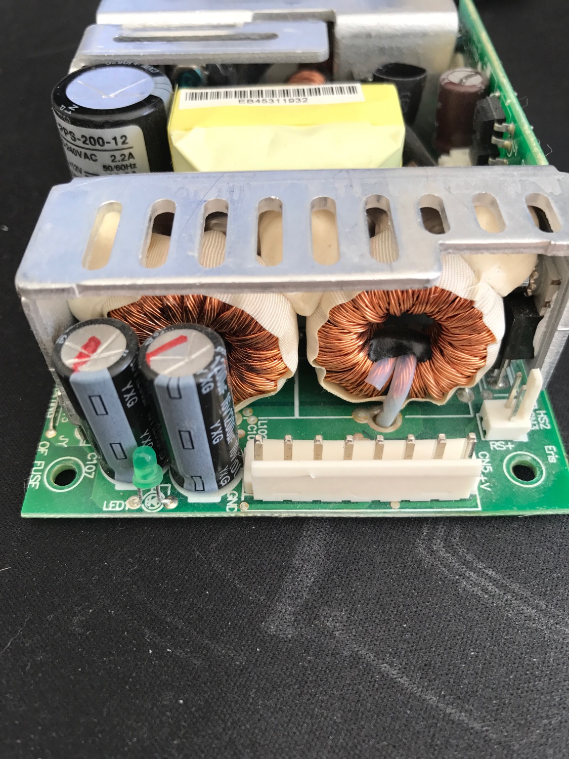

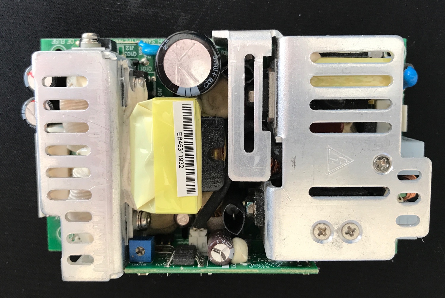

One of my Thunderbay 4 units failed today. I presume it's the internal power supply. Unfortunately, the warranty is only 1 year, and OWC don't offer any kind of repair, or parts such as replacement power supply. Such as waste having to put the device in the bin.
I had 2 of these units set up with 3 drives in each in a RAID 1+0 in SoftRAID. Whilst it seemed to work well, I'm very reluctant to buy another unit after only 2 years.

I've dismantled the unit. There is a circuit board connected to the thunderbolt ports, which attaches to a circuit board that attaches to the hard drives; this receives an 8 pin cable from the power supply (but may also be an integrated controller?).
The cable that supplies this 'power supply' gets mains voltage, and the 8 pin outputs don't have any voltage. So it's definitely this board that has failed.
Good info. That's still a bummer. Is it modular enough that if the part were available an end-user could replace it?
There isn't by chance a simple fuse somewhere on that power supply board, directly in line where the AC power is connected?
Thanks for the reply. Interestingly it does say on the power supply board something along the lines of 'risk of fire replace fuse with the same type'. However, I don't see anything on the board that I recognise as being a fuse, unfortunately.
