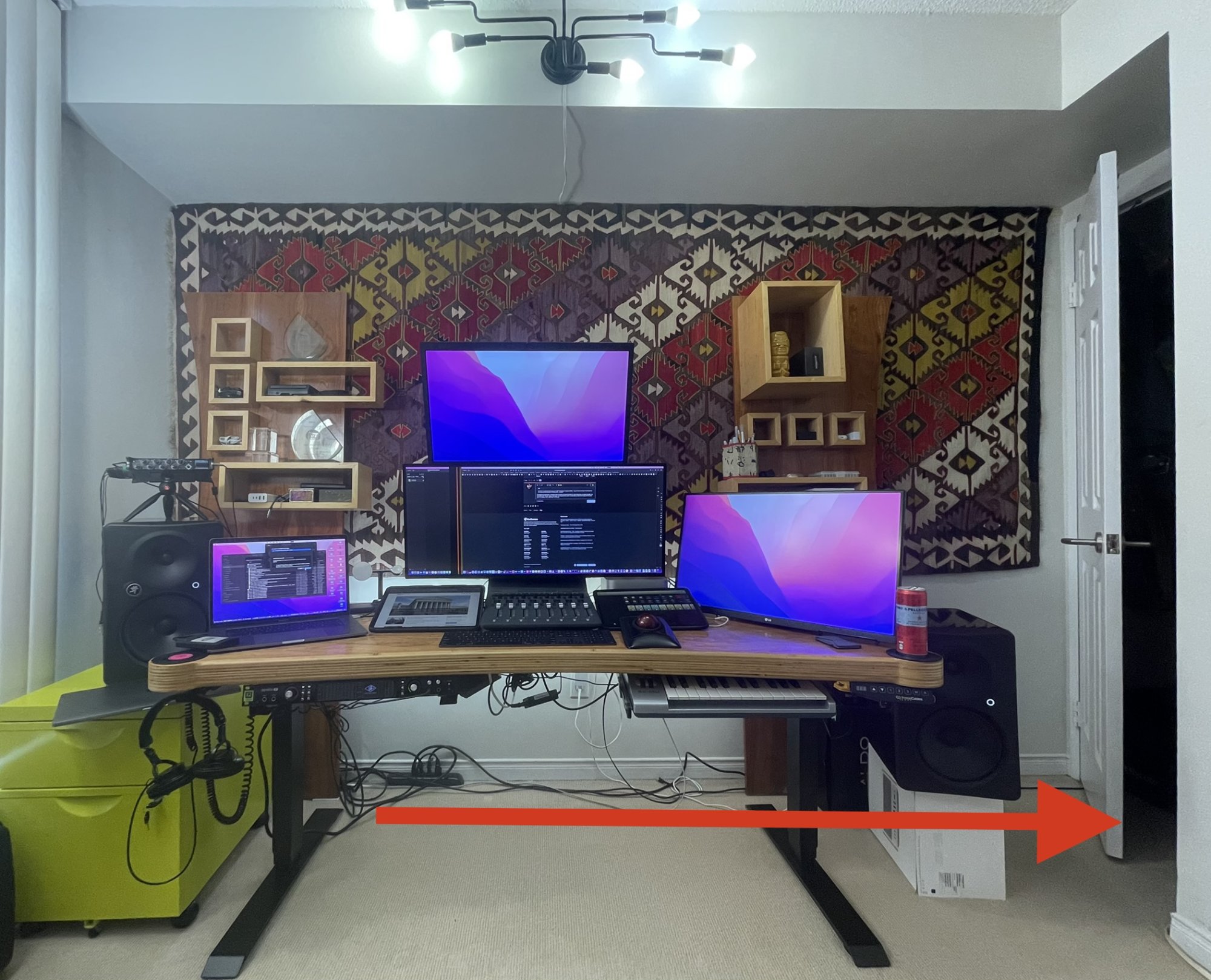

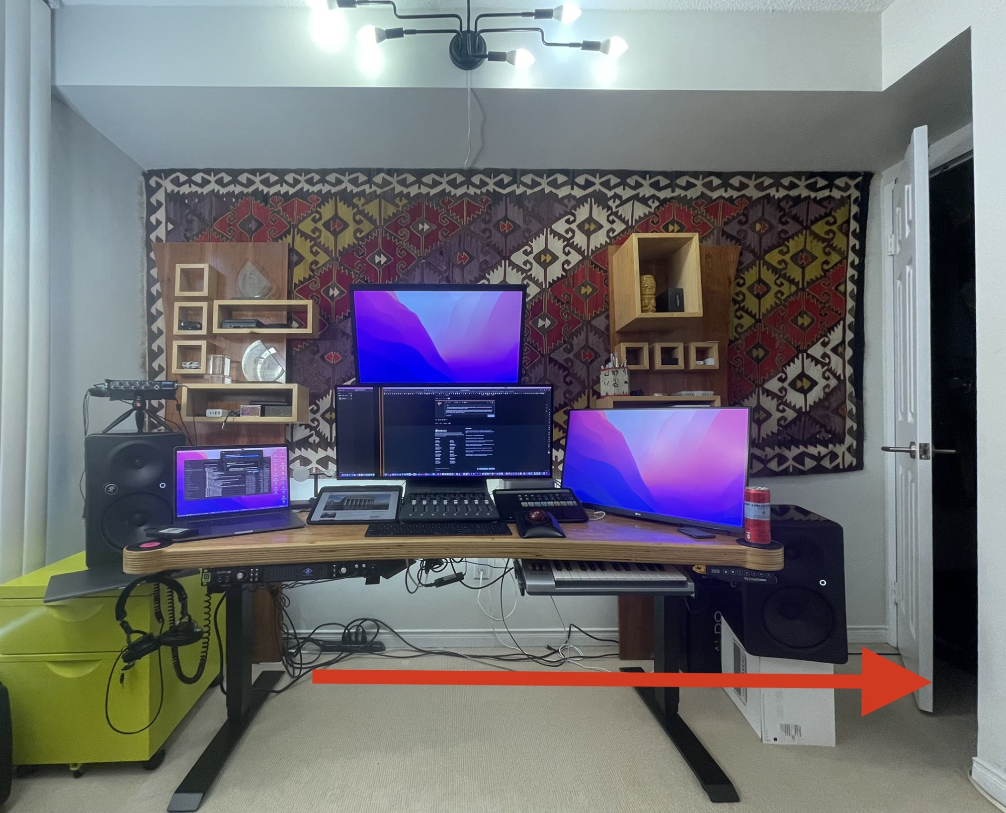

No issues at all with heat or annoying noise, but with my recent purchase of a Mac Studio Max to replace the MBP, it is once again the "loudest" thing in the room. I've moved it from under my desk into a closet 5 feet away with the door ajar for venting. I can't really hear it at all now.
Your desk looks like it could use a few more displays. :p
