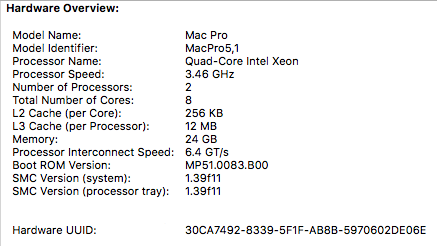

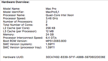

Well, I have cMP 5,1 with Dual X5677s and an MVC flashed Gigabyte GTX 1080. So, I can not use the 10.13 Beta because no Nvidia Web Drivers. But, I tried the firmware update, and it worked:p MVCs EFI worked just fine. The only odd thing that happened was that both my optical drives opened for a brief time, then closed. Other than that no issues.

As stated above, I can't use High Sierra because of my GTX 1080, so I'm still on Sierra, 10.12.6. I downloaded the full Public Beta from the App Store and started the update process. I then got the Firmware Update box and proceeded, shut down, waited for the pulsating power LED and restarted. The firmware update was applied and the Mac restarted. When I reached the desktop, the 10.13 Beta was ready to be installed, but I declined.

Ok, figured it out and got it to work:
1. The App Store Update from a previous beta does not seem to trigger the FW update, it has to be the current, full installer.
2. I ended up booting of a regular spinning Sierra drive connected to the main SATA ports to initiate the install.
3. RTFM, I had forgotten how you have to let the system shut down and then press the Start button until you get the flickering light and special tone. If you get the primitive funky progress, you are in business.
My non-standard Radeon card with EFI flash and older machine (mid 2010 5,1) was not an issue.
I have two High Sierra partitions, will try APFS conversion on the throw away one next.

Same as Flowrider, I use the official but free way to do it. Go to Apple beta programme webpage to download and install the beta tester software. At the end of the installation, the software will automatically open Appstore and go to the HS public beta page. Download the HS public beta 5 from there. Run it, it will prompt you a firmware update is required. So, I just follow the procedure to shutdown.
After that, I re-installed my self flashed 7950, then keep pressing the power button until the beep sound (took quite a few seconds after the normal "don" sound, should be depends on how many hardware installed). Firmware update normally. After that, the Mac reboot back to Sierra desktop and continue the beta OS installation, but I cancel it from that point. Shut down, and re-install the non-flashed R9 380. I have no intention to run that beta OS as my daily OS at this moment.
