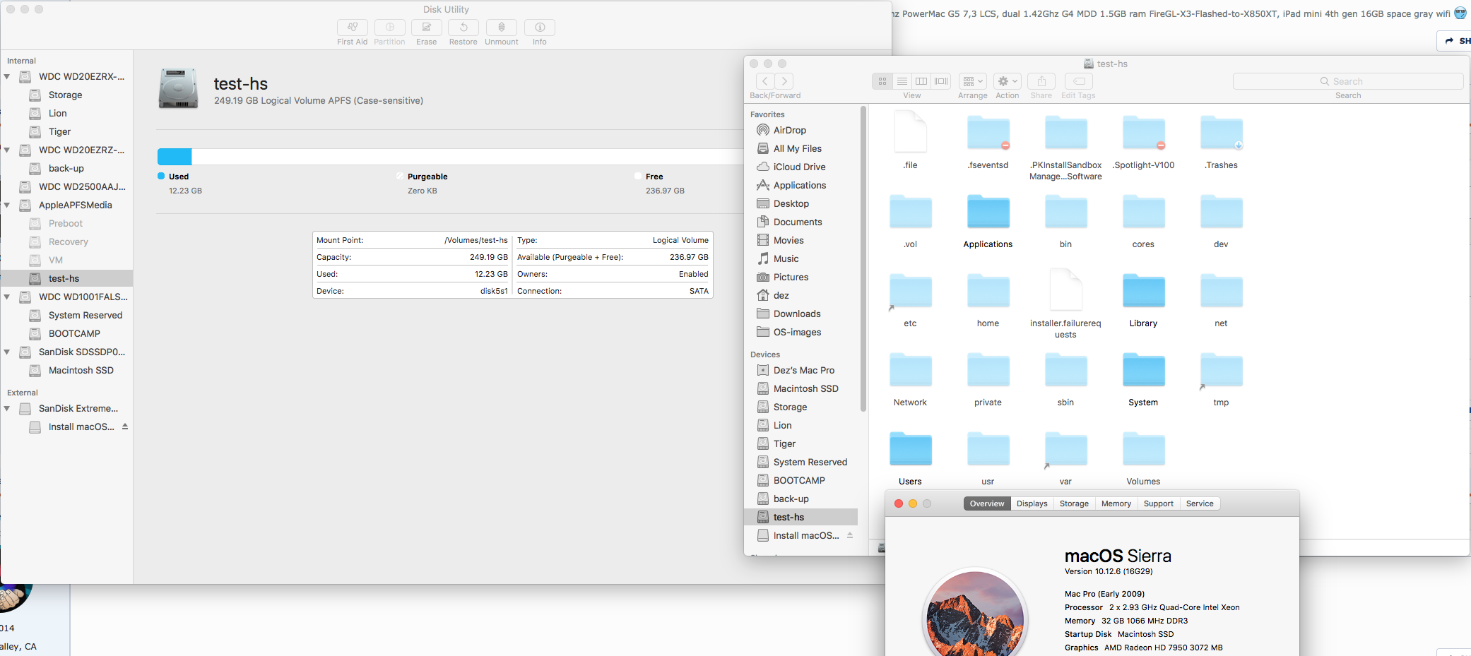

So, when you boot back to 10.12.6. Sierra can read / write the APFS partition, but cannot check / first aid via disk utility, right? Also, is it correctly identify it as a case non-sensitive file system?
seems like 10.12.6 will happily RW to the APFS volume, but oddly 10.12.6s DU says its case sensitive, im pretty sure i explicitly formatted the disk as case insensitive in the 10.13 installer...
Yeah, I think this is a bug. Which makes APFS is a very risky file system under Sierra. Even DU can't identify it correctly.
If I'm remembering correctly then case-insensitive APFS didn't exist until 10.13. The older Disk Utility is presumably reporting it as case-sensitive because it doesn't know any better.
Edit: Apparently I'm not remembering correctly! This blog says that it came in 10.12.4.

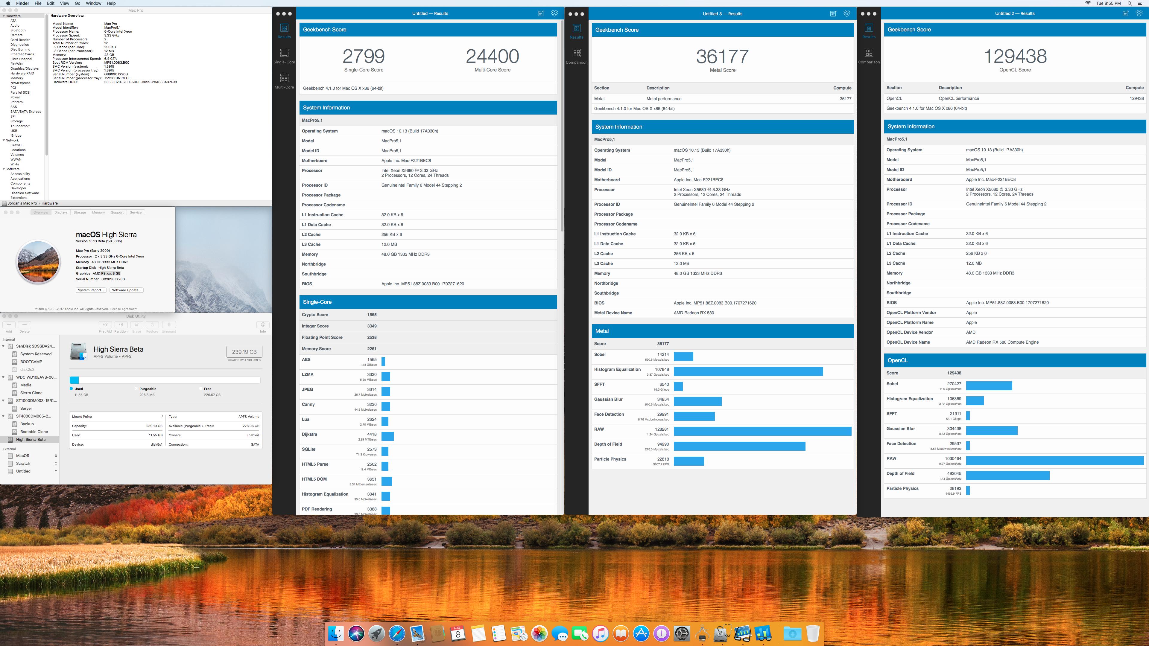

Another working flashed 4.1, everything went really smoothly. Def not ready to use it as my main OS but this is cool.
When system can't name the card correctly but Geekbench can. Please send this as a bug to Apple so that they implement proper card identification. Now that they officially supported the use of the RX 580 (and so on) and eGPU, they will need this feedback from users.
