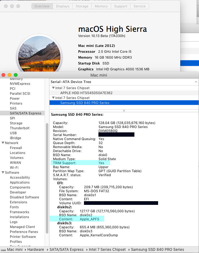

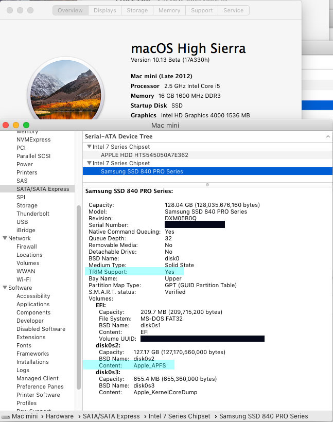

Regarding Trim and APFS:
On a Mac Mini though.

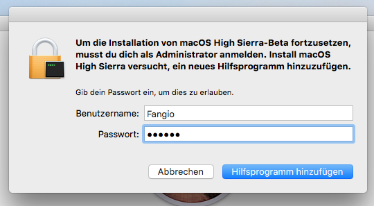

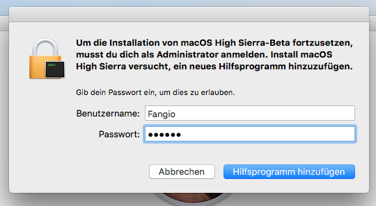

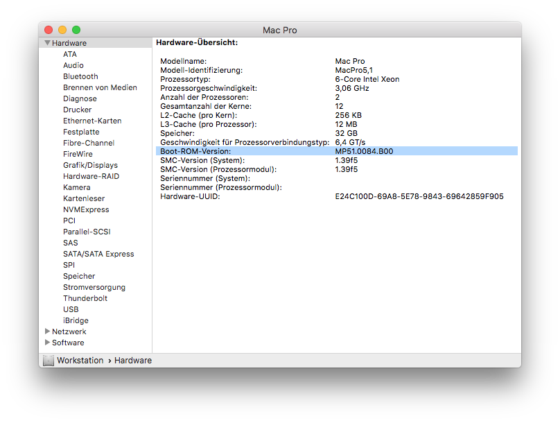

Yes indeed, there's a new firmware upgrade coming with DB6.
Again, the download of full 17A344b installer is required. It then asks for admin permission to install a new helper app
When allowed, the firmware upgrade runs just as before. And you'll get this

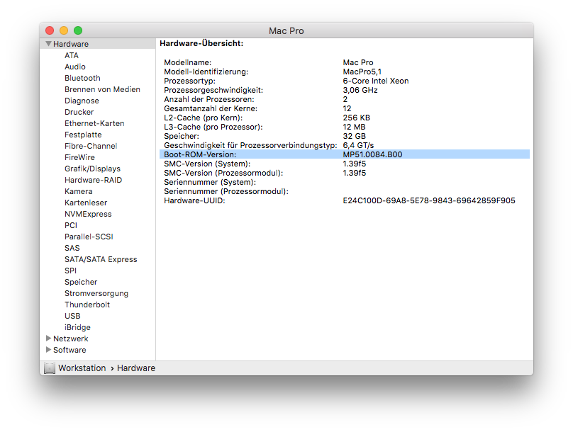

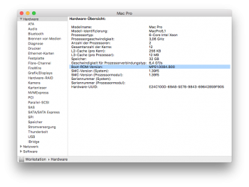

Last Firmware had at least one bug in it, I got a EFI. dump Notification, if I wanted to send it to Apple, I did and we got new Firmware again after just 1 week.
