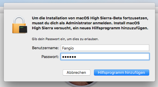

  • Yes indeed, there's a new firmware upgrade coming with DB6.
    Again, the download of full 17A344b installer is required. It then asks for admin permission to install a new helper app
    When allowed, the firmware upgrade runs just as before. And you'll get this

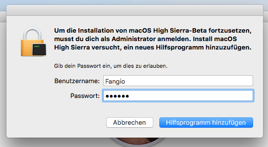

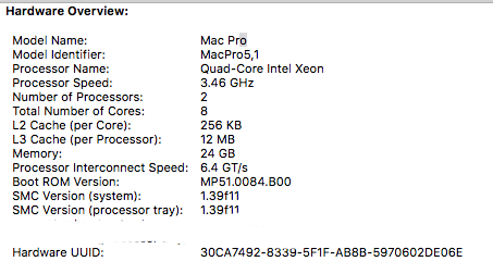

Just downloaded the PB, the new firmware is in it. As you reported MP51.0084.B00. I'm still on 10.12.6 because of my GPU.

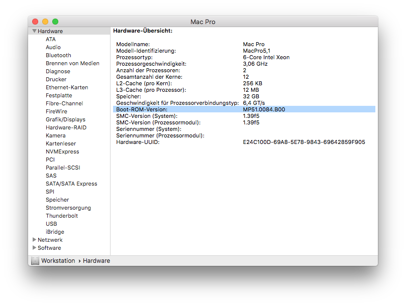

I can confirm that I also got the firmware update on my flashed 4,1 and I was able to install it no problems :) it did the same *CLICK* Power off and reboot at 80 percent as last time btw

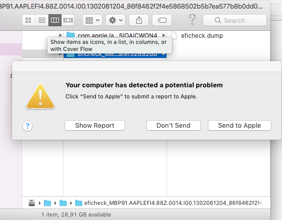

I got notification, see below, as you can see there's an EFIcheck.dump file, it's all gibberish even when I open it with a hex editor.
im curious where did you find that dump, do you have a path to where i might find it on my own system? also what does "show report" show? do you have a screen shot? :)
I also noticed that the picture, shows firmware of a MBP9,1 (2012 non retina MacBook Pro 15 inch), not a Mac Pro 5,1...
