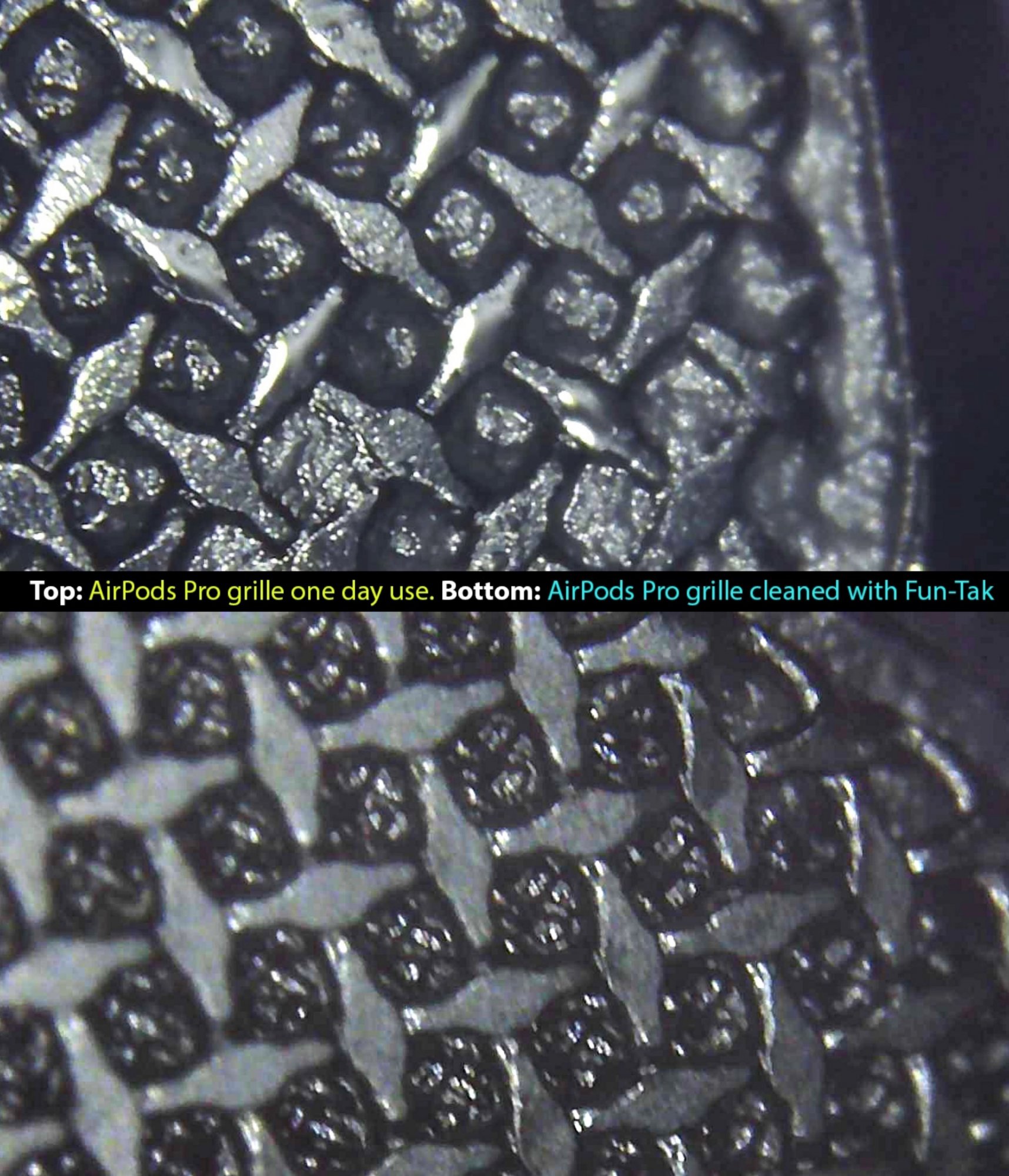

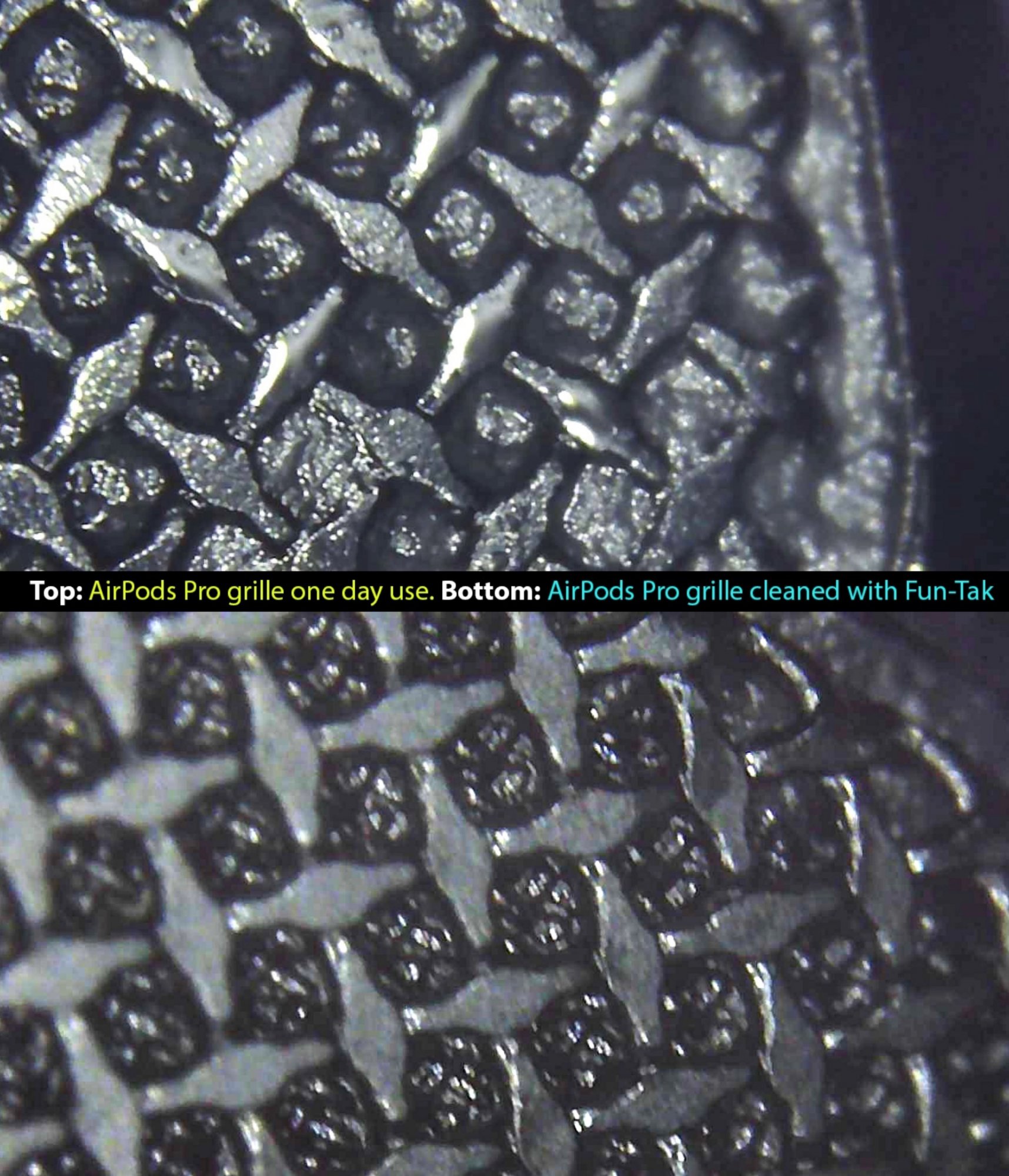

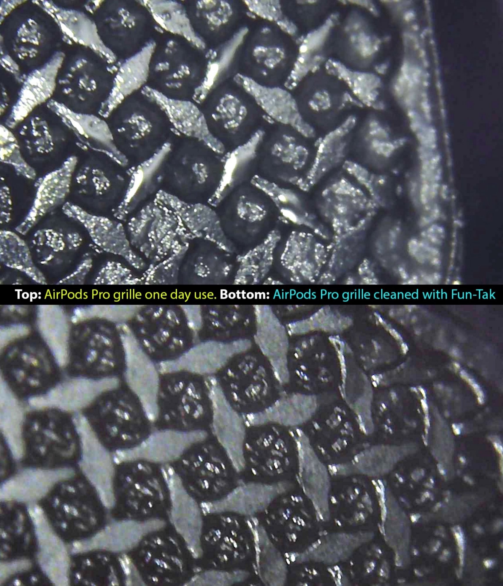

Another user posted macro photos of the inner ear grills after a SINGLE DAY of use, vs. just recently cleaned with Blu Tack, and the difference is stark.
Given the success reported by users cleaning their units with Blu Tack, and the above photo, If you think yours have reduced ANC performance, for whatever reason, chances are they are just dirty and need to be cleaned. Only Blu Tack or similar products seem to have the "reach" required to get inside the grille and clean them properly.
This is ridiculous. Apple’s (nor any multi billion dollar company’s) QC wouldn’t have ok’d a device that requires cleaning every day to prevent its main selling point from working properly.
Many are saying the blu-tak method hasn’t made a difference, so it’s not the common cause everyone is hoping for.
Apple released a phone with an antenna design that wouldn't work if you covered it with your hand, so don't be so sure that real-world use wouldn't reveal something they didn't consider. Samsung released a folding phone without realizing that people might try to peel off the non-removable protective layer on the screen. These things happen.
The AirPods Pro DEFINITELY need regular cleaning to work 100% as intended, depending on your personal genetics and amount of ear oil secretions, etc. It's objectively true that the fit test will eventually fail if the vent gets plugged with ear oil/wax, or other contaminants, and the sound quality will degrade as well.
If the blu-tak method doesn't work, there are really only a couple possibilities.
A) Blu-tak method often requires a firm, consistent cleaning for best results. If you don't take the time to do it properly, then it might not have the intended effect.
B) Or one of the MEMS microphones has broken, resulting in poor performance.
And the firmware thing is kind of bizarre if you think about it, because all Apple would have to do is increment the firmware one step and re-release the old version. Easy. Why in the world would they make users sit on a firmware update that breaks anything, if they could roll it back just as easily?
It sounds ridiculous, but it is absolutely true. For months I felt the same way and said so vocally in the APP threads. You can check my post history. I was pretty sure that the failed fit test coincided with a change in firmware. All of the other cleaning methods, sucking, etc did not produce any consistent change for me. The blu-tack however, works 100% every time. I wear my APP’s 6-9 hours every work day, and wear them while working out as well. After ~3-6 days of use, they will begin to fail the fit test. 30 seconds of careful cleaning with the blu-tack makes both of them pass every time - and this has been repeated too many times now to be a coincidence.
I posted my experience a few weeks ago in another APP thread and the number of users trying this method has really grown since then - I was not the one who suggested this method - but I was a vocal detractor who decided I was wrong. The number of people reporting success with this method has grown rapidly, and the number of people claiming they tried it and it didn’t work remains quite small.
There is clearly something unusual going on here.

Since we've had a forum member post before and after pictures taken of the APP grills, would it be possible get similar photos of the Blu-Tak tape showing the gunk that was removed?
(Apologies, but I remain skeptical as to whether Blu-Tak really fixes this issue. And even if it does, how lame is it that we would need to do this to make our APPs work as advertised? This seems like a hillbilly duct-tape fix.)

It’s been about 3 weeks with the 2nd replacement AAPs. After a week, foot stomps and low frequency engine noise became an issue, again. More on the right than on the left. 2B588 firmware.
Encouraged by those before-after photos, I bought some new Blu-Tack to make sure it’s clean and dust-free. It actually worked this time. I used canned air before and after the Blu-Tack treatment. I have no way to verify if these are as good as new, but they are very good again. And most importantly, ANC is symmetric again. I used canned air from the side direction, thinking that direct airflow might push any garbage deeper into the mesh.
So yeah, I guess this will be the new weekly routine from now on.
It's a putty, not a tape. And yeah, if I have time some evening, I can put the Blu Tak under the microscope too.
I don't know why anyone would be skeptical about this, though. Apple designed a vent grille that's positioned in such a way that, for most people, it sits against the skin and gets dirty and plugged up because of it. If it's plugged up, it's not going to work as intended (if it wasn't necessary for operation, Apple wouldn't have put the grille in the design in the first place).
