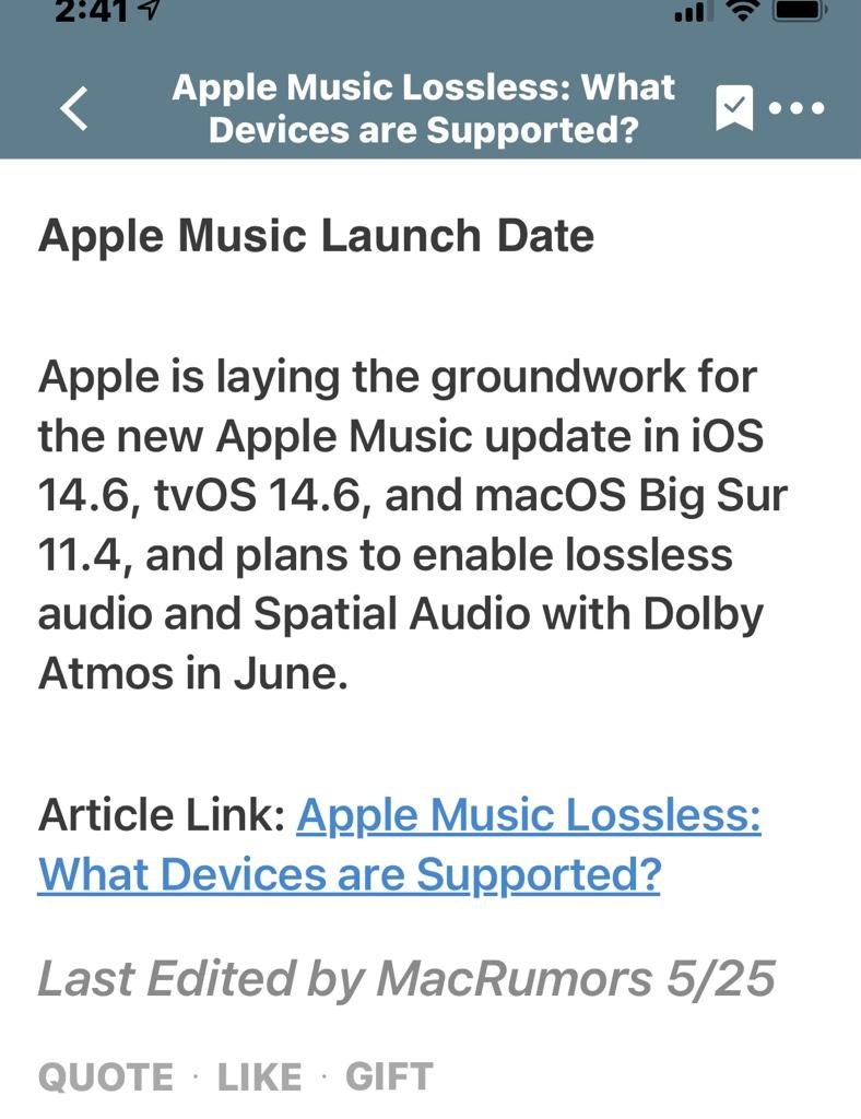

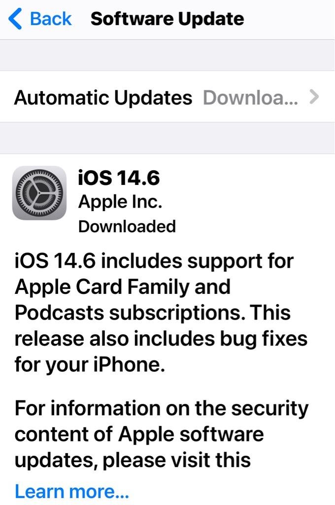

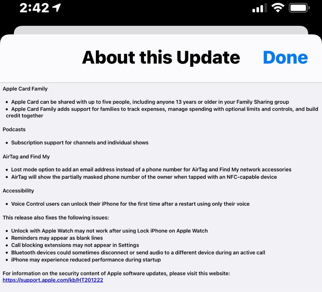

I see 14.6 iOS is out, in the article say related to the launch.
But I see nothing in the 14.6 description itself

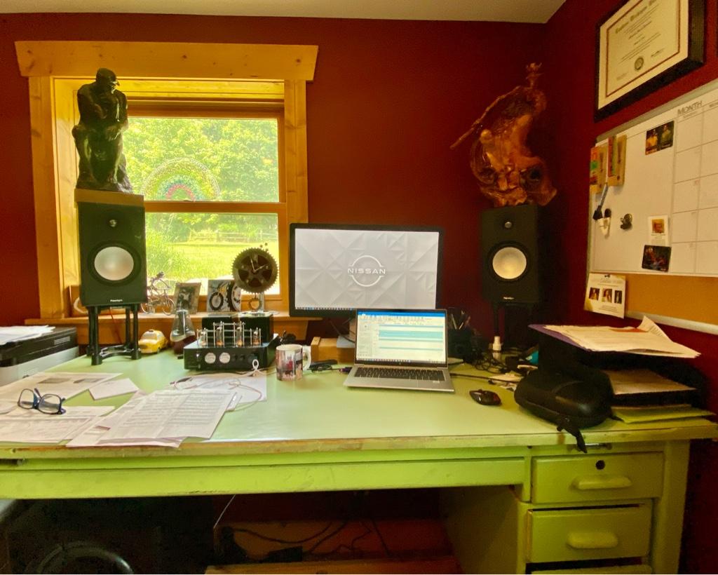

I have a 2.1 system in my tiny basement office, as seen here.
Actually thx to the Covid19 pandemic and working home 14+ months I’ve re-discovered stereo listening.
Yea, nearfield setup at ear level , truly the imaging is dialed.
I’m using a parts express hybrid amp, it has BT 5.0 and my iPhone 11 does ..

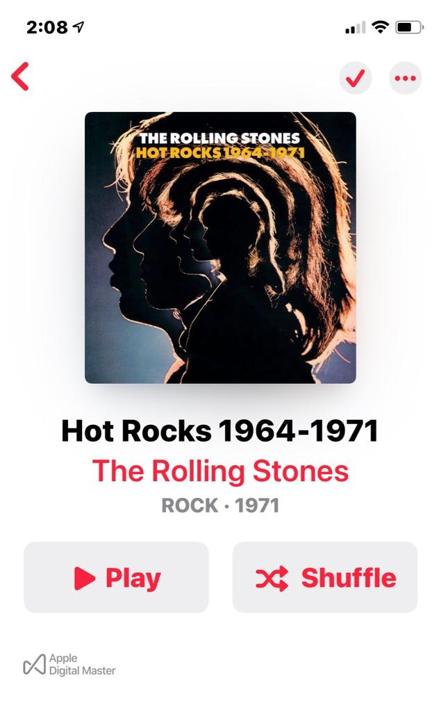

Right now I’m listing to this classic album, not Apple Music streaming , I purchased it and it’s downloaded onto my iPhone.
But … am I’m leaving something “out”? Some audio?
Should I be hard plugged iPhone to the back of the hybrid amp?

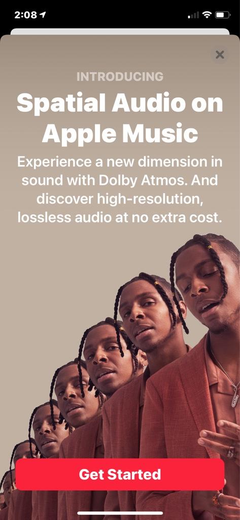

Oh, this just showed up on my screen, but it’s for streaming only right?

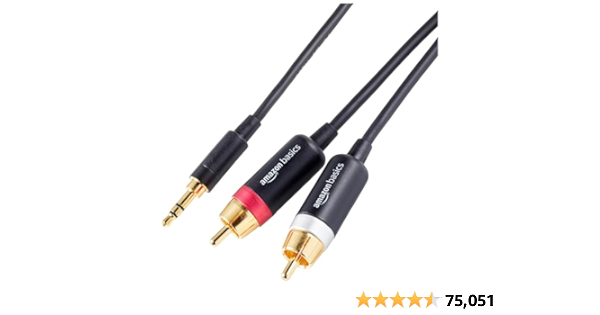

There’s not 3.5mm input jacks, so I ordered this instead to go into the Aux input directly.
Getting tomorrow.
Getting tomorrow.
Or buy something with that has no specs whatsoever :rolleyes:. No doubt it'll work fine.

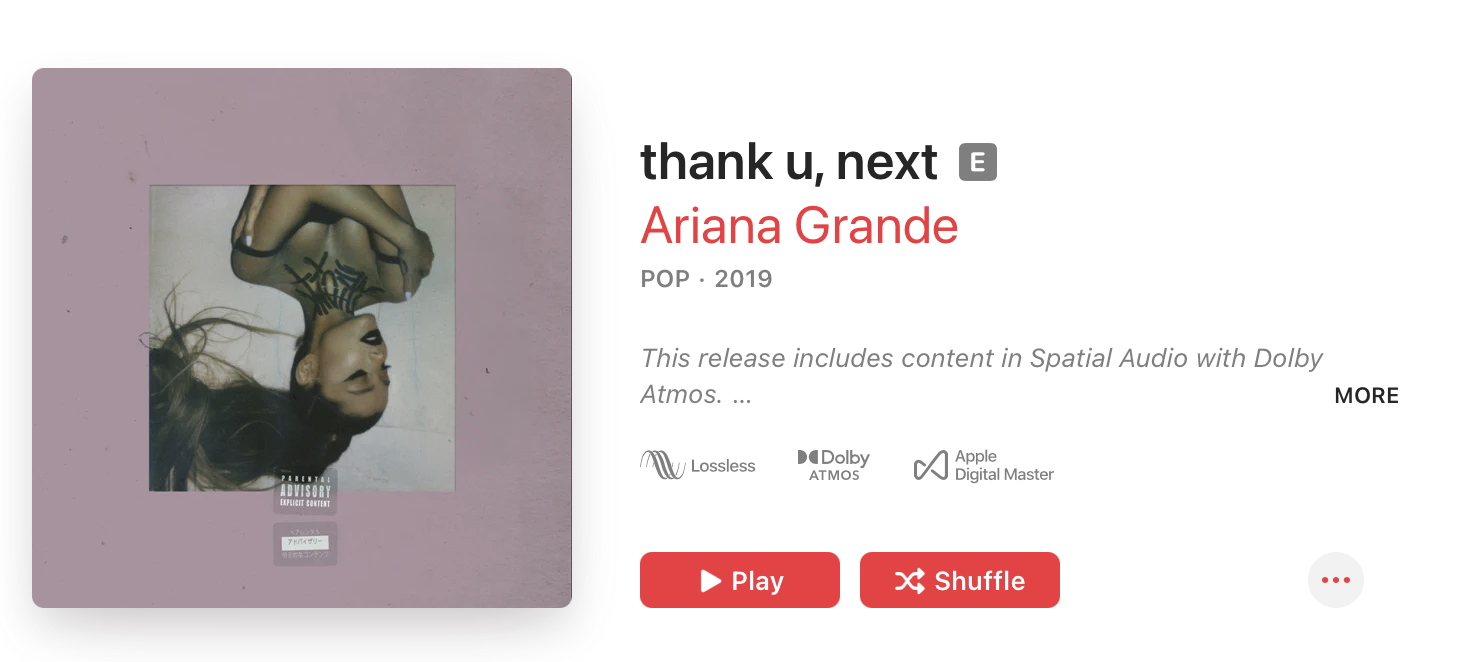

On Apple's Made for Spacial playlist:
Dolby Atmos is AAC.

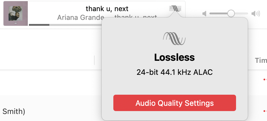

That said, are you sure that you actually hear in Dolby Atmos when the lossless logo is shown? You shouldn't.
The first time I tried your playlist/track I got no symbol at all (neither lossless nor Dolby Atmos). I've restarted Music app and then I got Dolby Atmos.
I've restarted Music app again and I still got Dolby Atmos.
Lossless icon popped out instead, as expected, when I switched to an AirPlay 1 receiver.

Dolby Atmos is AAC.
Not sure I follow why Atmos and lossless are mutually exclusive. For video Dolby TrueHD is lossless and it includes Atmos. The album is labeled lossless and spatial.
Dunno. It is Apple's playlist so they are advertising the tracks as being spatial. I haven't found spatial to be that compelling. For me the quality of the original recording is an order of magnitude more important.

I don't doubt that it's possibile to have a lossless Dolby Atmos.
In the case of Apple Music I think that Apple decided to keep Dolby Atmos in AAC for now. Probably for bandwidth. I'm not a Dolby expert. I see that it can carry up to 128 channels.
I've downloaded on my Mac Ariana Grande's track imagine from thank u, next album marked, as you stated, lossless and Dolby Atmos. I think it's rather lossless or Dolby Atmos.
The downloaded file 01 imagine.movpkg is a package which contains a subfolder Data. The .data file inside it contains, among other things, an index of the various versions (emphasis is mine to spot easily main informations):

The codecs of the two Atmos versions are marked as EC-3 which is a lossy format. The only ALAC version is the 44.1 kHz/24 bit.
I've downloaded then another song from another album which isn't Dolby Atmos. It contains of course only AAC and ALAC versions.
