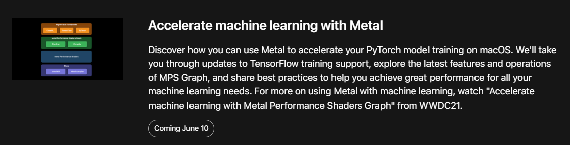

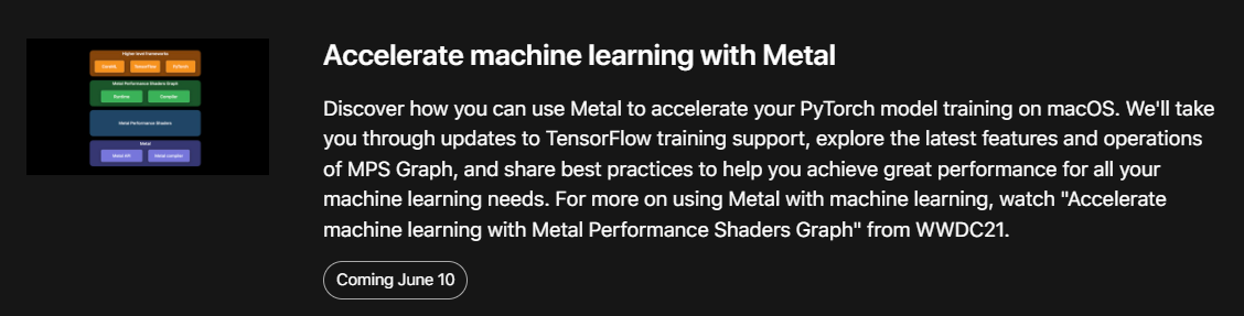

Apple will have a session on Pytorch and Tensorflow on Friday. 🤩
Thanks for posting the link. Looks like Apple has a ways to go. The numbers were a bit shocking, especially compared to old GPU cards like the Nvidia 1080. That is 3 to 4 generations old.
Yeah, cuda is Nvidia's secret sauce, but according to the platforms state-of-the-union video Metal 3 will accelerate PyTorch mps significantly. Looking forward to seeing the talk on Friday.
How is it possible that Apple has not explained this before? Apple needs to learn to write changelogs. ;)

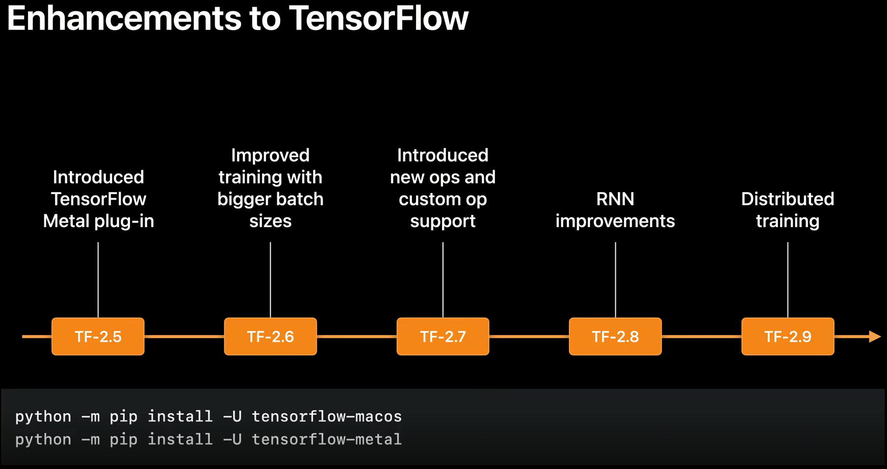

Distributed training is very cool!
Does it matter if one is using MacOS Monterey (or a "pre-Ventura OS" and Metal V2(?)) vs MacOS Ventura and Metal V3?
Will these tensorflow or pytorch plugins work over different versions of Metal? Or is that all hidden behind the API surface of MPS Graph?
I'm assuming WWDC 22 is all Ventura and Metal 3 on Apple Silicon.
The minimum requirement is macOS 12.0 for Tensorflow and 12.3 for Pytorch.
I think the performance (and reliability) of Tensorflow and Pytorch on macOS depends heavily on whether the op you want to use is well supported by the GPU and not on your version of Metal. People keep finding ops in Tensorflow that are not yet supported by the GPU.

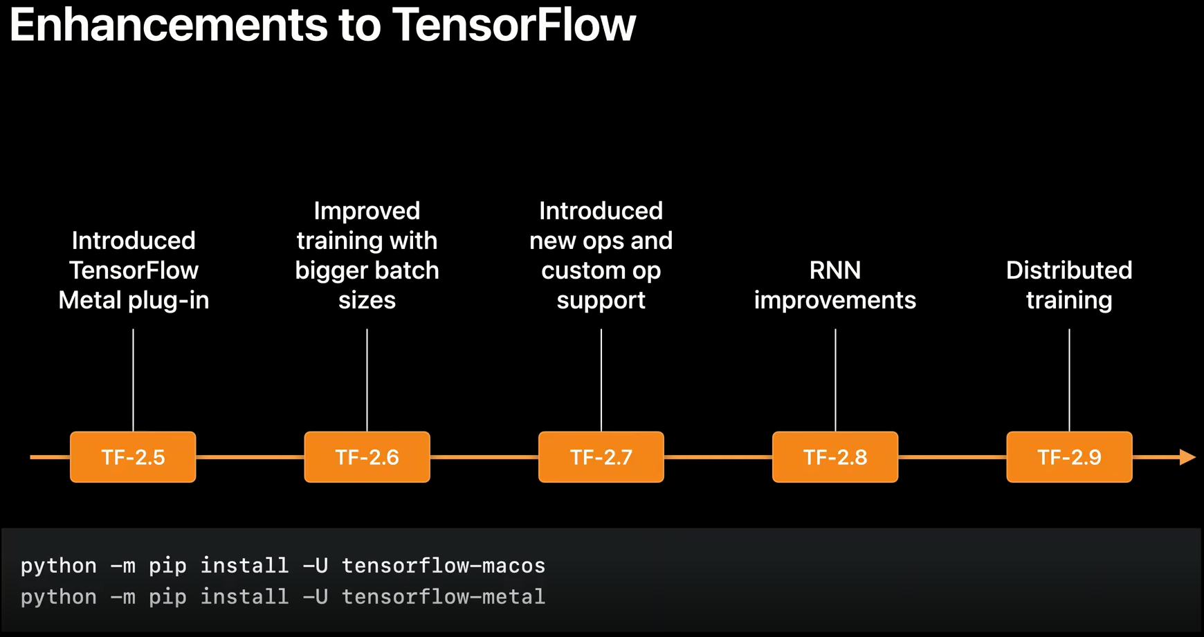

Apple hardware is very good at inference, but not so good at training. But Apple is getting better at training, and distributed training across multiple Mac Studio is now possible.
Does the M1/M2 SoC support native bfloat16 arithmetic?
Is there any benchmarking comparing Tensorflow and PyTorch on macOS?

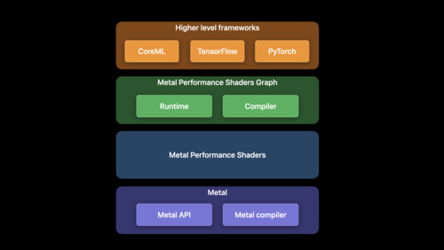

In the metal 3 overview PyTorch is mentioned saying it uses metal performance shaders then in the Metal shaders part Apple says there's a performance boost

That refers to the PyTorch 1.12 backend which comes with MPS out of the box. It's been available in nightly releases before though, so there should be nothing new here: https://sebastianraschka.com/blog/2022/pytorch-m1-gpu.html
