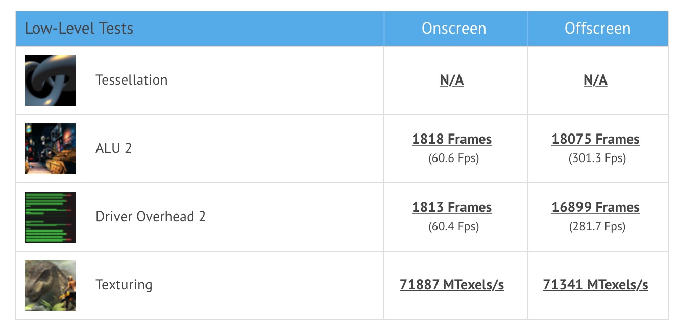

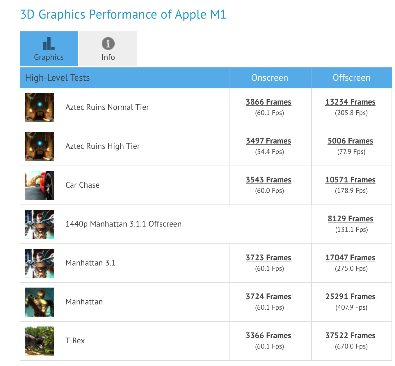

What a crappy results for a low end machine like the M1, don't you all agree :) https://gfxbench.com/device.jsp?benchmark=gfx50&os=OS X&api=metal&D=Apple+M1&testgroup=overall
Let's compare this M1 thing, this ENTRY machine of Apple to nr 5 graphic card in 2020, according to https://www.pcgamer.com/the-best-graphics-cards/, see https://gfxbench.com/compare.jsp?be...U&hwname1=Apple+M1&D2=NVIDIA+GeForce+GTX+1660 (M1 to the left., NVIDIA GeForce GTX 1660 to the right) ... amazing ...
What I find more interesting is the comparison with 1650Ti Max-Q: https://gfxbench.com/compare.jsp?be...=NVIDIA+GeForce+GTX+1650+Ti+with+Max-Q+Design

Note how the M1 is punting on a 1440 screen here .
Yeah, it gets a big hit on 1440p — I am fairly sure that this is a memory bandwidth issue. That's where the GDDR6 in the other GPU can show its advantage.
But I don't see this as a problem, a GPU of M1 class only targets full HD gaming or below that. It doesn't have enough horsepower to handle higher resolutions, so the fact that it is getting bandwidth starved trying to run them is hardly a disadvantage.

Those results make it seem that something (the display itself?) is capping the onscreen FPS at 60FPS, especially given how much variance there is with the offscreen results. If Apple really wants to target gaming going forward (the presence of Baldur's Gate 3 last week and Tomb Raider at WWDC indicates that is on their minds), they would need to either improve the refresh rates on their retina displays (which may be difficult given how many more pixels they push compared to a traditional 1080p display) or bump up the GPU itself. Even newer AMD and Nvidia cards can have issues with higher framerates at QHD (1440p) and 4k resolutions, so there may be a practical limitation at play with regards to the onscreen results.
It's basically vsync enabled. Can't get higher than screen refresh rate. This is why one looks at offscreen results — they provide the actual performance figures.
