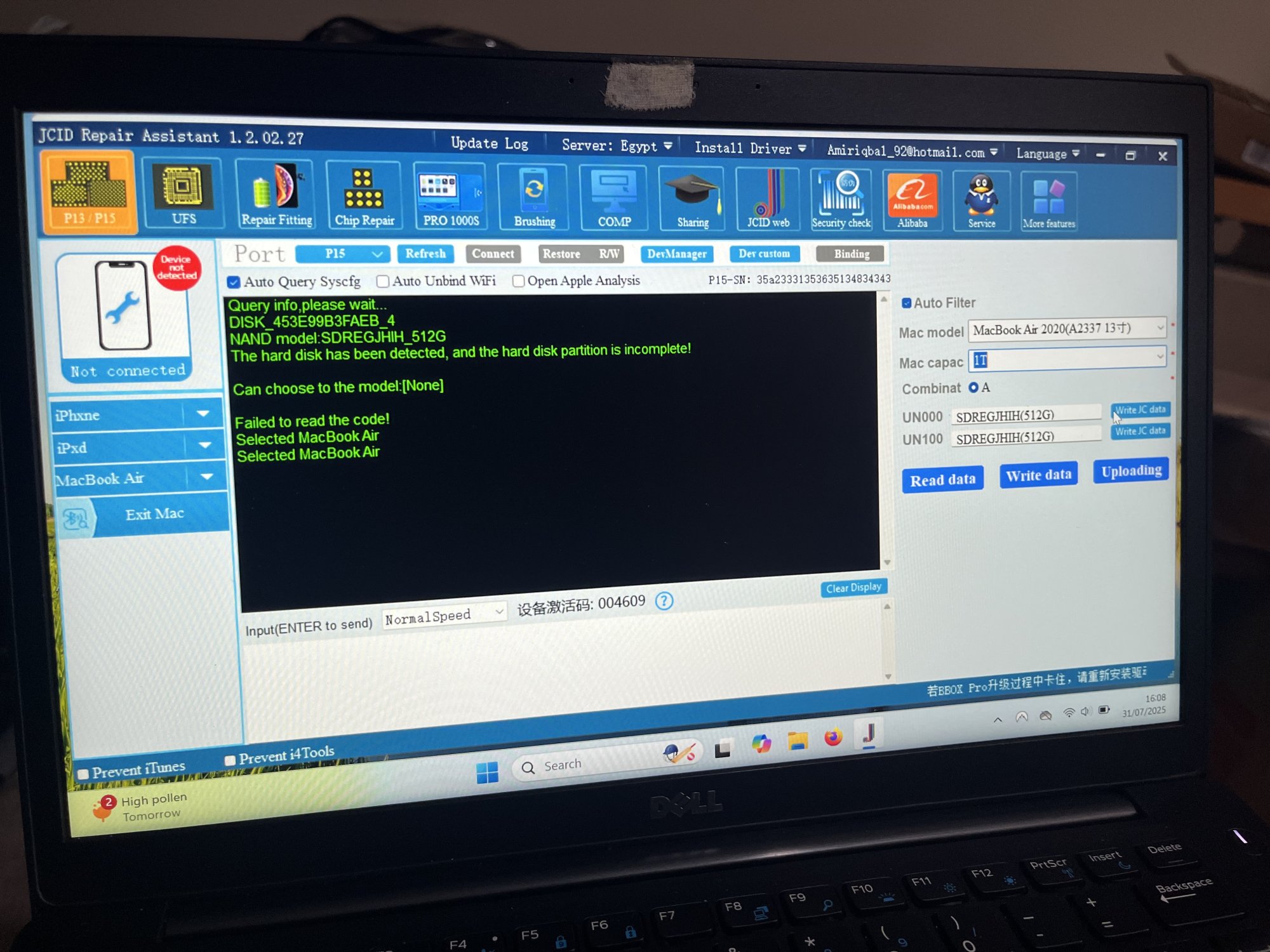

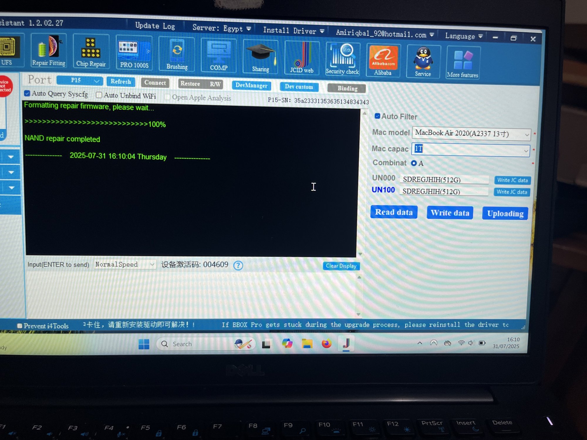

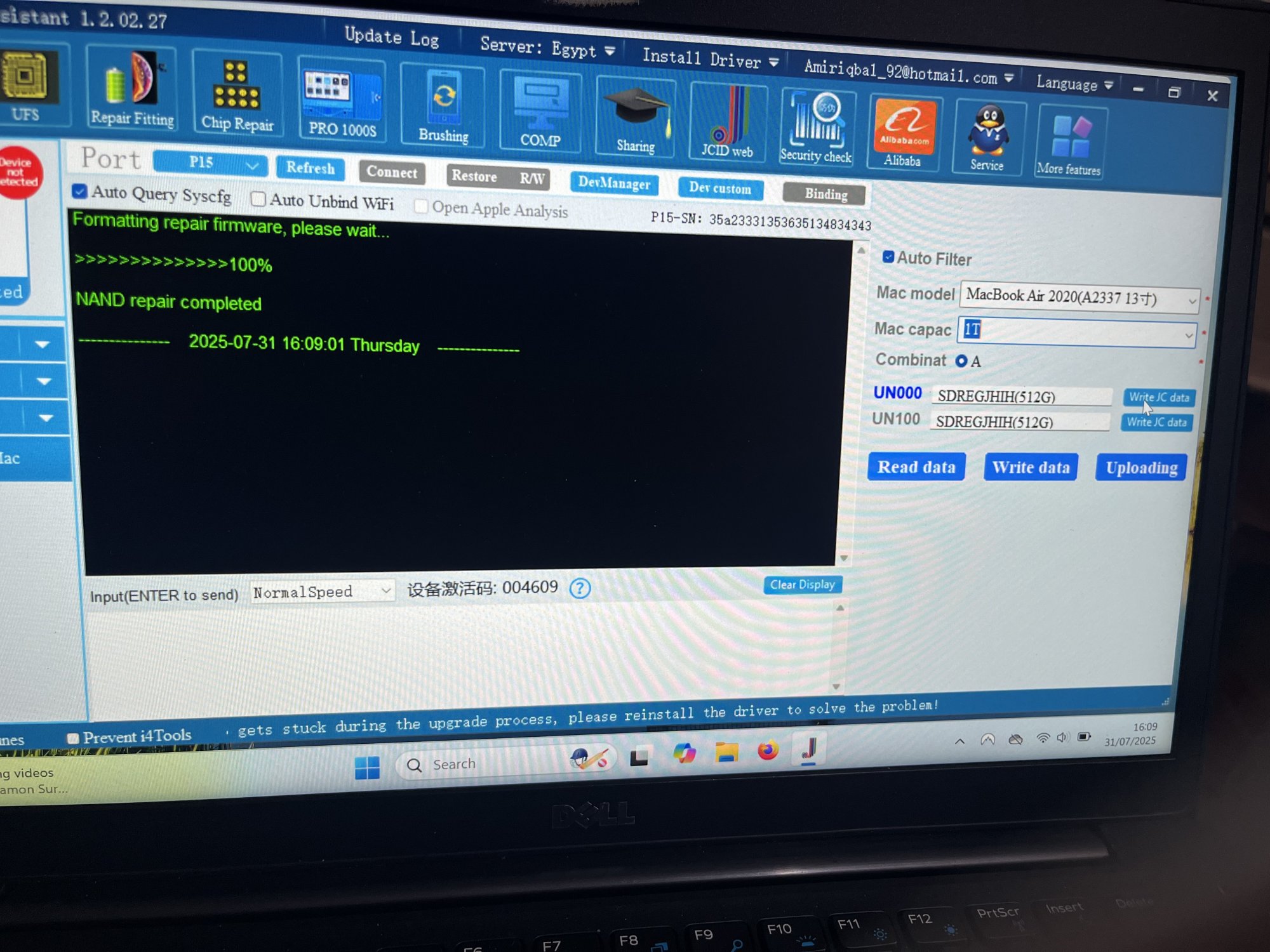

anyone ever used a p15 to program these sandisk 512gb nands for a2337 (m1 MBA).
seems to be able to complete a the writing of the data for each UN000 and UN100. however consistently fails the dfu restore.
have tried with two sets of nands and same result with both. then reverted back to the original Hynix nands (256GB) and machine works fine so the issue certainly to do with these nands.... any ideas?
