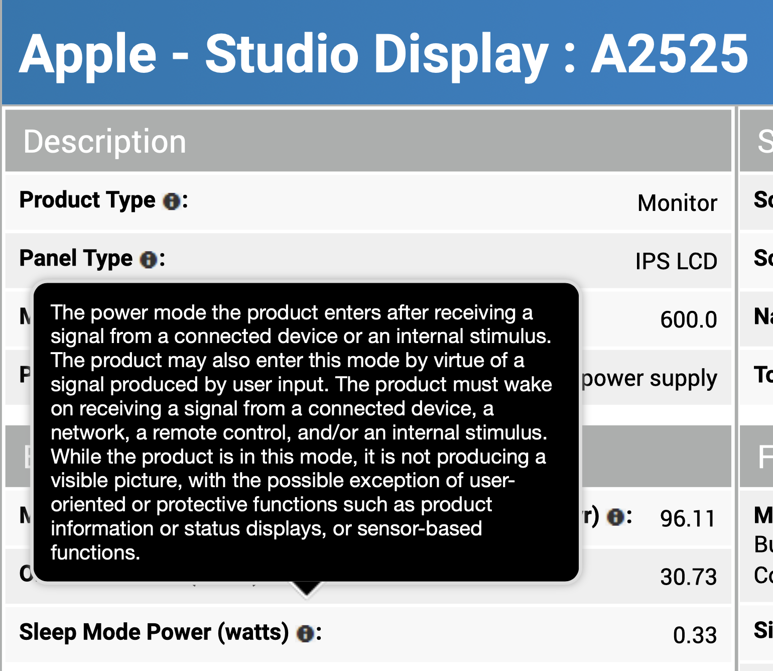

@C0re0 "Will the MacBook still be powered via the Thunderbolt cable despite the ASD is off..."
If the sleeping MacBook Pro is still charging whilst connected to the ASD, then the ASD's internal PSU will be providing that power, and the fans will be needed to cool it, so will be 'on'.
So that would be an expected behaviour...

To summarize, there is no real "sleep state" of the ASD - the fans will be running from time to time. Probably when the MacBook does some background activity but I do not know. But it's really some kind of frustrating that there is currently no real power-saving mode of the ASD in which the fans don't run in the long-term. Regarding power consumption, this is an issue.
I also did some research on the internet. Apparently, there are numerous threads describing the same problem, and it seems to be caused by MacOS, especially with the introduction of version 15.4.
Still not solution available. Therefore you either have to shut down your Mac, or unplug the Thunderbolt cable, or unplug the power cord of the ASD to really turn off your ASD.

Thanks for bringing this up and for your detailed observation regarding the ASD fans.
First, my setup is a Mac mini M4 connected to a ASD. The biggest problem is the difference between setups ASD with a Mac mini and setups ASD with a Macbook. Some users just connect the Macbook with the TB cable to the ASD so it is getting charged via TB from the ASD power supply. In this case it seems to be just logical that the ASD needs to cool his power supply and the ASD fans run all the time.
After reading how to setup clamshell mode (I don’t have or use a Macbook) it seems there is no need for the ASD to deliver power to the Macbook because it's connected to his own power supply. So if this is correct, the conclusion could be, a Macbook in clamshell mode connected to a ASD should behave like a Mac mini connected to a ASD.
Lots of if, could and would. You can read details about behavior of the ASD (with Mac mini) in this thread. https://forums.macrumors.com/thread...s-are-in-sleep-mode-since-macos-15-4.2457769/
There are still some important differences between Mac minis and MacBooks because MacBooks have additional and/or other settings in energy settings, what makes it impossible to compare a device behavior even with the same settings because there is always the chance that one setting the other devise doesn’t have makes that tiny little difference why or if the ASD fans keep running.
In fact I’m watching the ASD fans since December 2024 and it is 100% confirmed from other users, the ASD fans changed behavior right with / after the macOS 15.4 update.
Can you provide us a screenshot of your energy settings and what macOS you use (not sure what OS Apple did put on that brand new device or if you use any beta) Also pleas check the ASD firmware version.
I wasn’t able to find any Mac mini user with macOS 15.4 and later where the ASD fans stop after the background tasks of the Mac mini. Did not take any attention to Macbook users because of the mentioned differences.
We need to get rid of this unnecessary wear and tear. If the ASD Display is black and no power gets delivered to an other device, there is absolutely no reason for the ASD fans running.
It is interesting you found your ASD without fans running this morning. Need to know more about that. Thanks.

Yes, I noticed this too. ASD seems to be always on and maybe it is because Apple wants the monitor to turn on immediately when coming out of sleep mode. We might just have to accept this as I don’t see Apple changing this. If they did, then there would be a longer delay for the monitor to turn on.
As long as you’re aware and OK with nothing that is plugged into the ASD being powered when you do this, the solution I’ve been using for the last 3.5 years and change is to just plug the ASD into a smart powerstrip I picked up off Amazon. The one I got was just for Alexa (but I use Home Assistant so it works fine with HomeKit in the Home app) but there are decent HomeKit ones available now like this https://www.amazon.com/Tapo-Extender-Protector-Individual-P306/dp/B0CYGSFFFW/ — I have mine assigned and basically can say “Alexa turn on Studio Display” or “Alexa turn off Studio Display” — but you could do it with Siri too.
Then I just have it attached to a smart outlet and choose to manually power cycle it or turn it off when I’m going out of town. The one caveat is that it takes at least 5 seconds to turn on, when you power it from being off. Which isn’t the end of the world, but is a bit longer than other monitors that have an actual power button.
If you don’t need a full strip, you can get individual smart outlets too.
I think not having a power button on a display that has an old iPhone inside it and sometimes gets software updates is a bad design choice, even if the default option would be to leave it powered on at all times. I feel the same way about AirPods Max. I like the ease of use of always-on, but headphones should have a proper power button, even if the default way of use would be to have them go into deep sleep or whatever.
