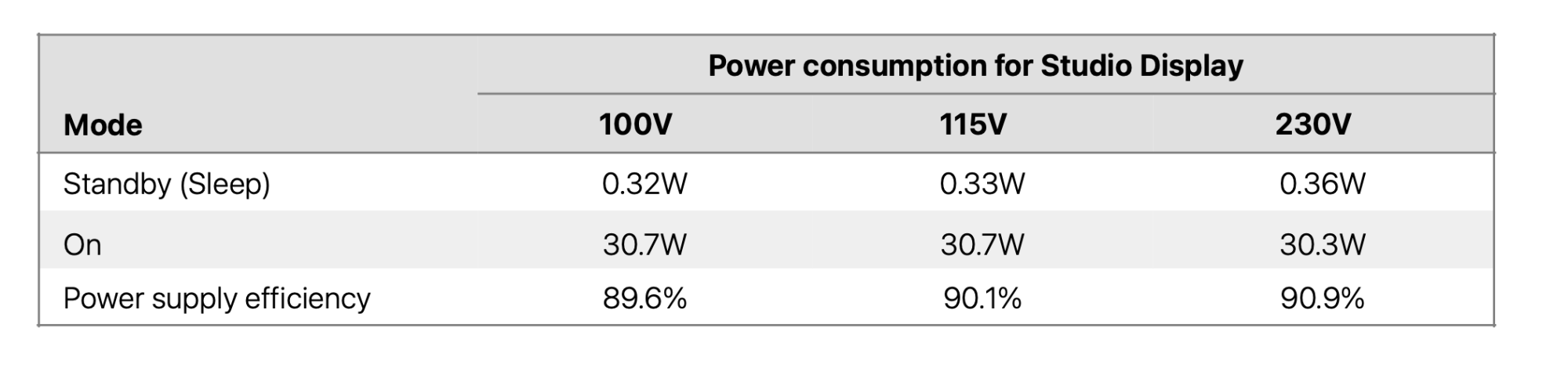

Here is what Apple is telling the user:
https://www.apple.com/environment/pdf/products/displays/Apple_Studio_Display_PER_March2022.pdf
• Standby (Sleep): Low power state that is entered after the display receives instructions from a connected host
computer set to off/sleep. This mode is characterized by a blank screen.

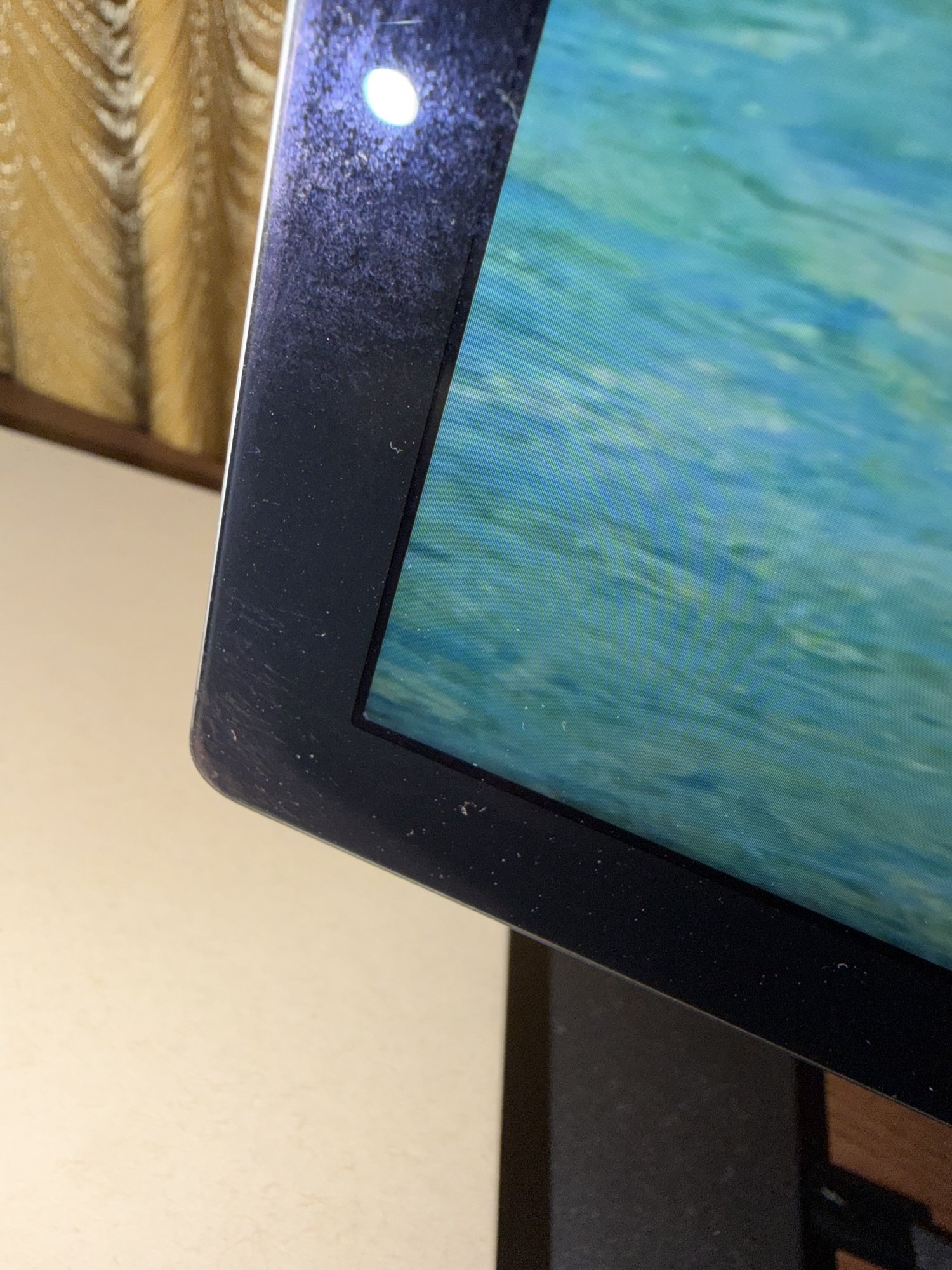

Brand new warranty display replacement. No crack on corners after carrying it home. Is this normal condition? Surface seems fuzzed out. Or is that some anti reflective coating ?

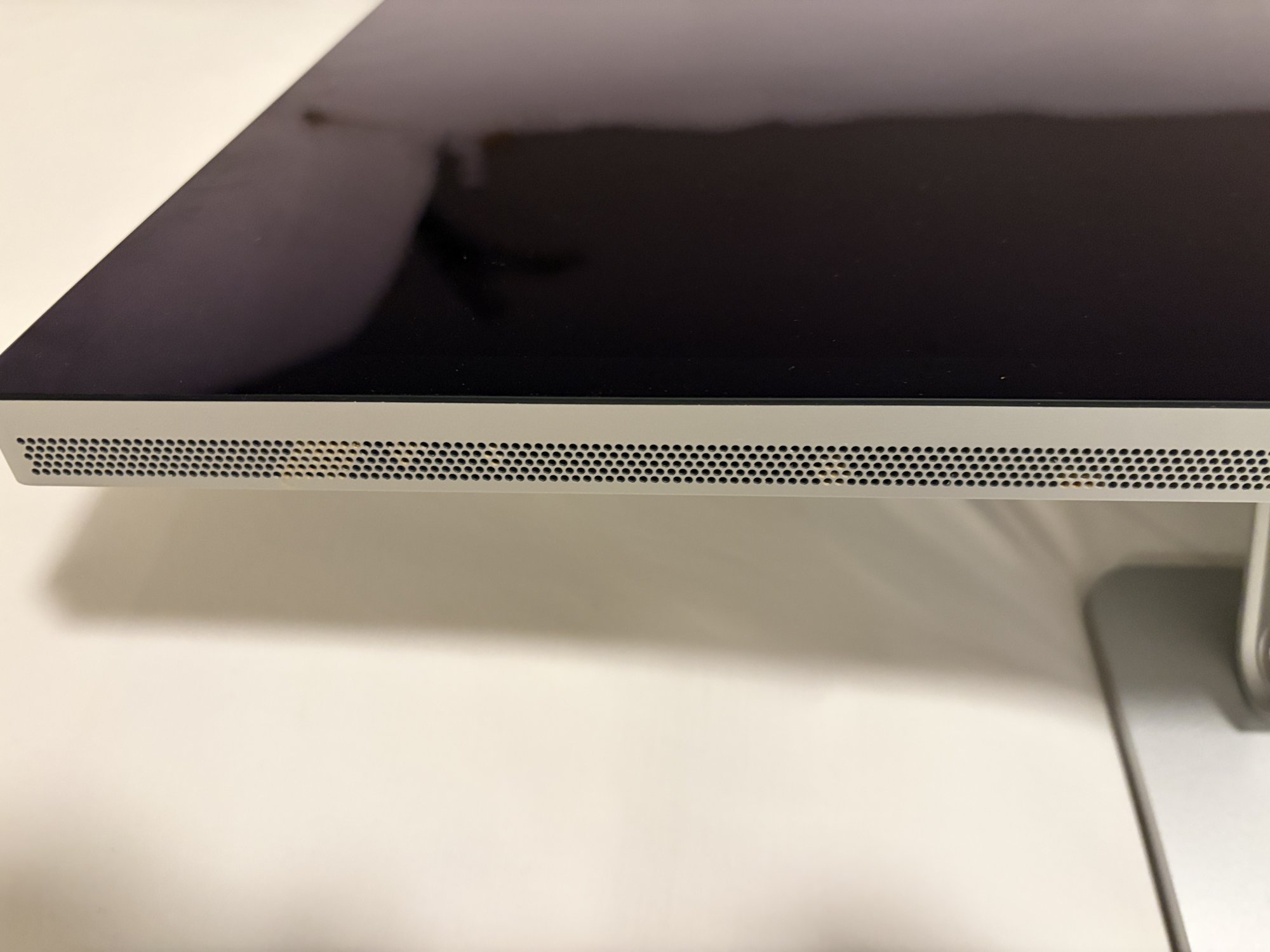

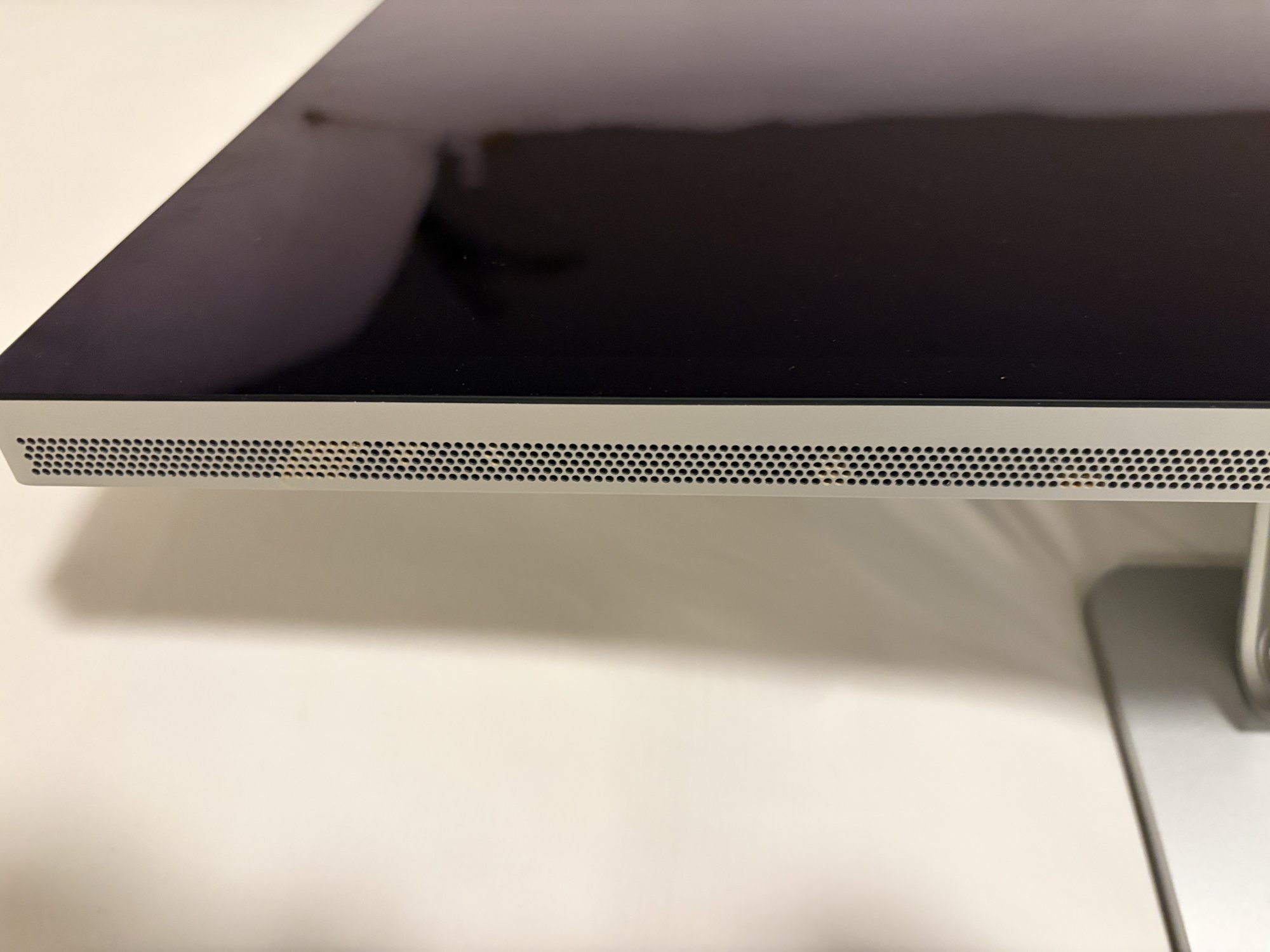

Hey everyone, I purchased a used Studio Display that has some marks/discoloration on the bottom of the aluminum frame. Anyone know what this could be and what might get it out? The rest of the display is in great condition, so not a huge deal.
Slight oxidation/tarnishing of the aluminum: Aluminum can tarnish slightly in small areas, especially if moisture or skin oils come into contact with it.
But since it's only visible on the bottom, I wouldn't worry about it at all if the monitor is otherwise in very good condition. How much did you pay for it?
