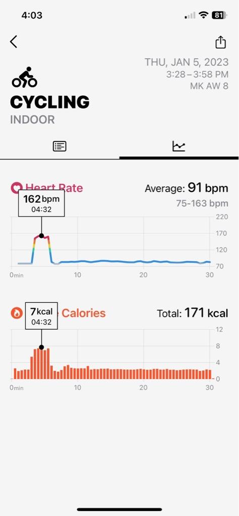

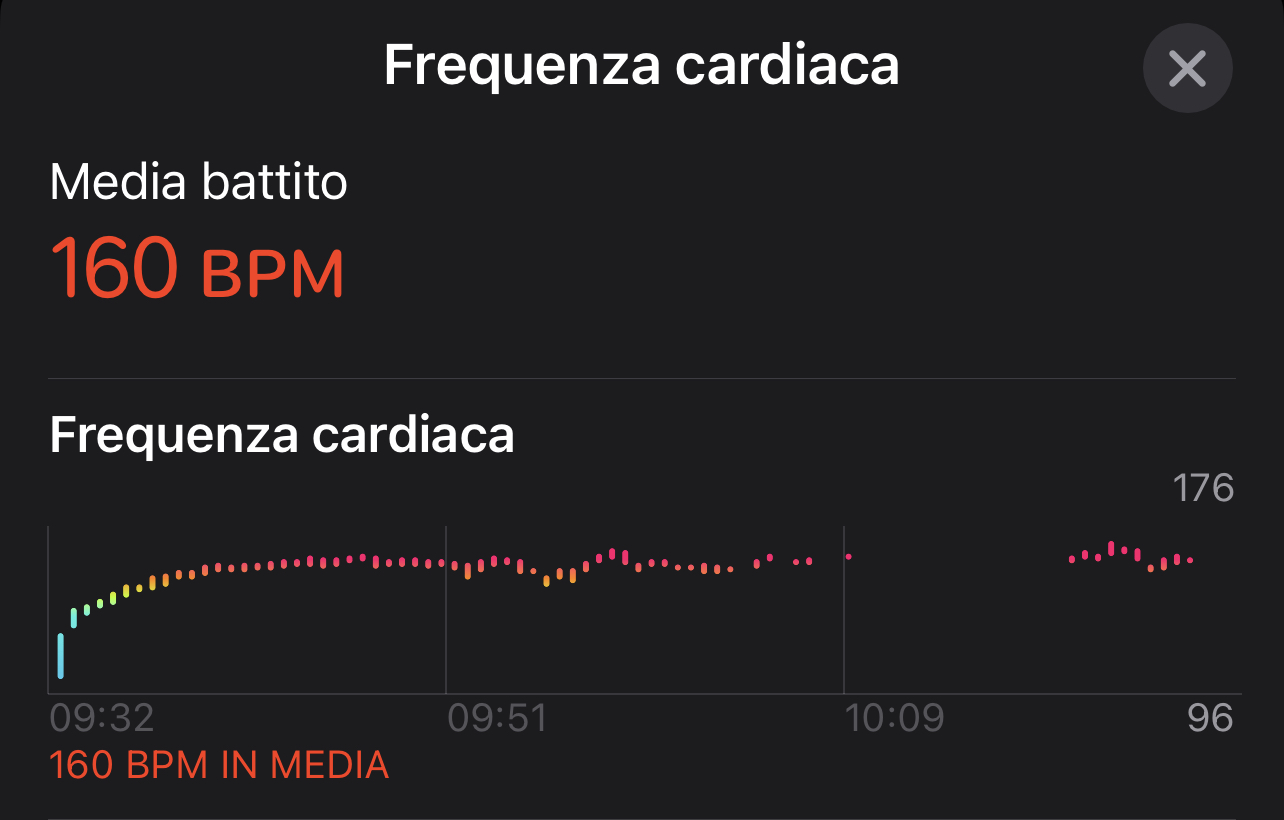

S8 here with the same issue, also had it on my previous S6. Yesterday I got a really weird readout while using a stationary bike. I was just casually pedalling while watching video on my iPad. I looked at my watch a few minutes in and was surprised to see 163 bpm. This screenshot is from Zones but I was using the workout app to record, this just shows the discrepancy better.

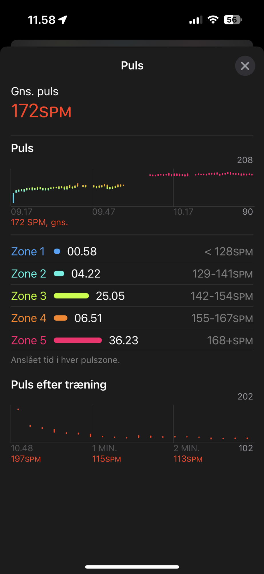

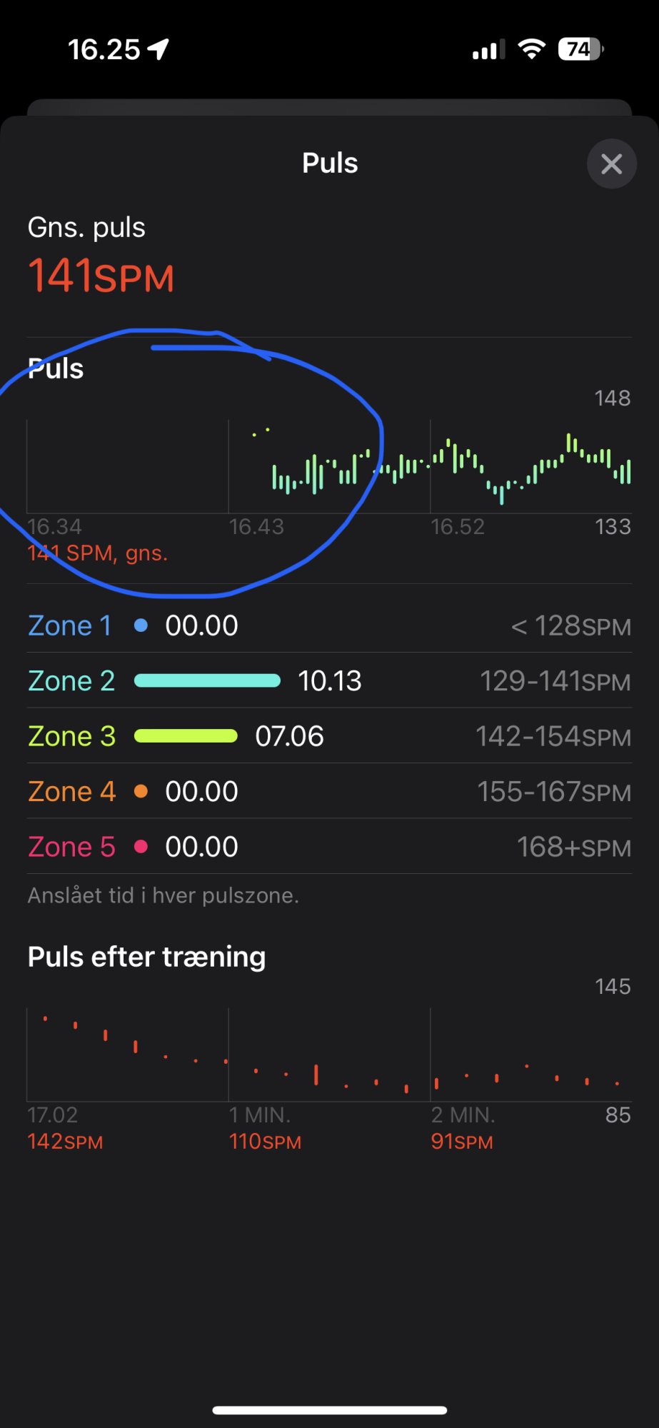

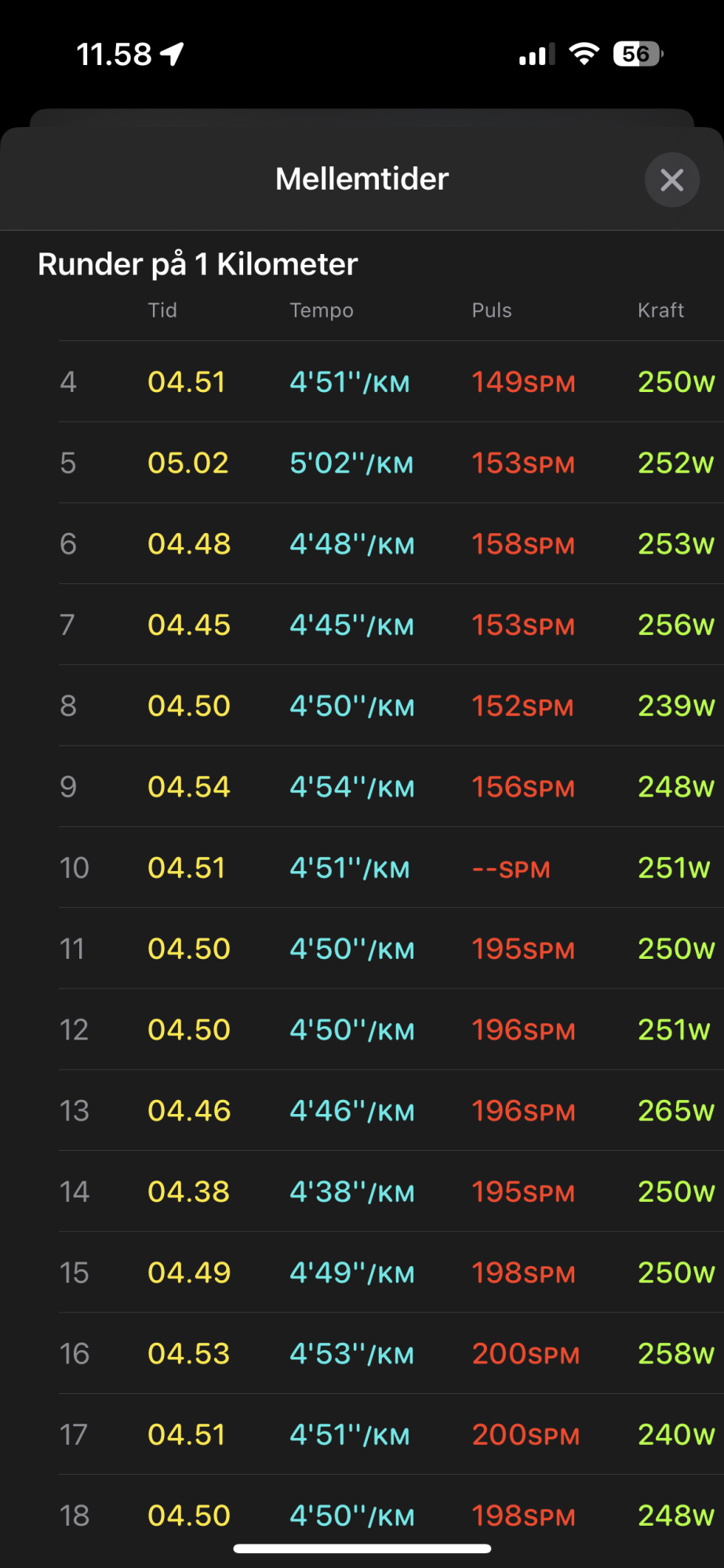

Just been out on a 18K this morning and this is weird - constant pace and heart rate all the run without any pause but halfway the watch looses my HR and when it gets it back it explodes (which I can assure you it didn’t.)

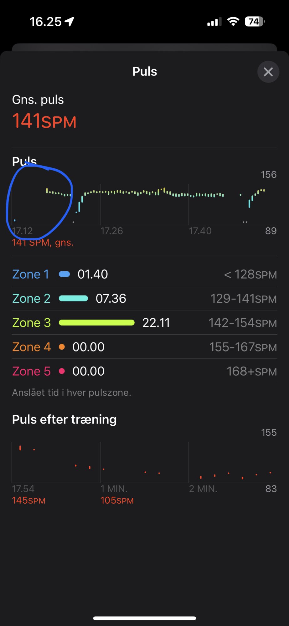

This pretty much described my experiences as well. Got my Ultra back in mid January. Everything worked great at first, then the past few weeks the HR keeps dropping during my runs. I run 3-5x a week. It picks up my HR for a while when I start my run, but within 3-4 or so minutes it's lost it, and doesn't pick it back up for another 5-10 minutes.
It seems to be getting worse though. During my 3.5mi easy run yesterday I lost my HR for almost the entire run. It would pick up my HR when I would stop, then drop again within a couple of minutes of running.

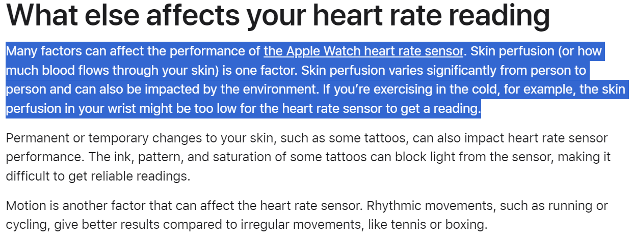

Wrist-based pulse optical oximeters, which is what the Apple Watch has and most fitness watches use, is not very reliable especially depending on the person's biology, activity, and skin tone. It is most reliable when the person is at rest. For people with thin wrists and who also have cold hands, it can be harder for the oximeter to read the pulse. Blood vessels at the wrist are much smaller, so pulse oximeters that you wear at the upper arm would be more reliable. Most reliable is using a non-optical heart chest strap monitor like ones made by Polar.
I've never been able to rely on the built-in pulse oximeter of the Apple Watch when I exercise (mostly running). I always use the chest strap. For me, the pulse oximeter works ok when walking except during cool to cold weather when it's harder for the Watch to detect my pulse at the wrist level (I have thin wrists and cold hands and that combined with cold weather equals even more constricted blood vessels and slower blood flow). It's just the nature of that technology and not likely the cause of a faulty device.

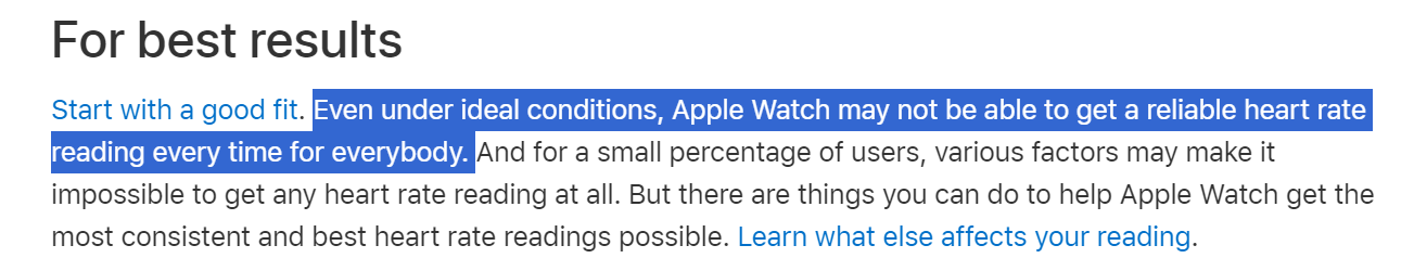

BUT What I found from apple website regarding this problem is :
