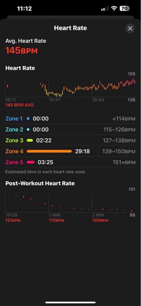

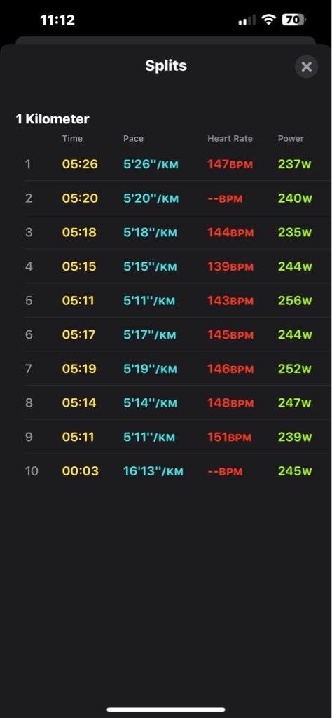

I didn’t want to start a new thread, this has happened on my last few runs. No heart rate recorded for the first 5-10 minutes. It doesn’t happen on walks, rowing etc only runs. Is this happening to others?

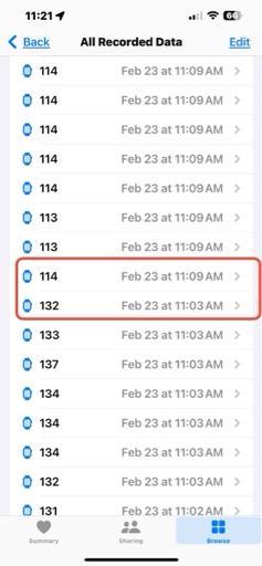

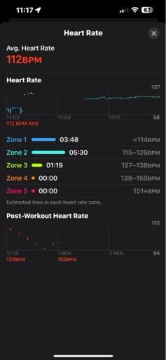

Another workout with a failed heart rate reading. A 15 minute session on a rowing machine. 6 minutes missing in the middle of the workout. As it was inside I can’t see temperature being an issue, also as you can see the watch was on pretty tight. Frustrating.
That looks really tight. Maybe it’s too restrictive?
