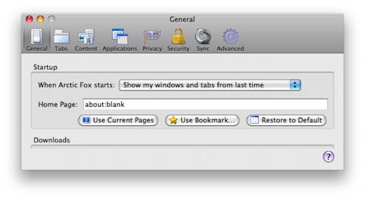

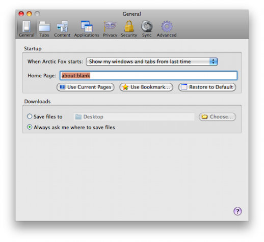

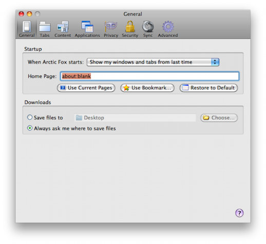

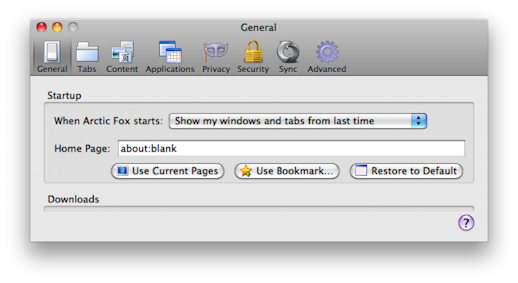

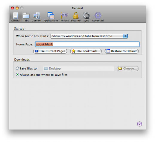

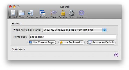

9. Cosmetics: usually, when I open ArcticFox's preferences, I get this:
instead of this (normal):
- which I only get after closing and re-opening the preferences.
