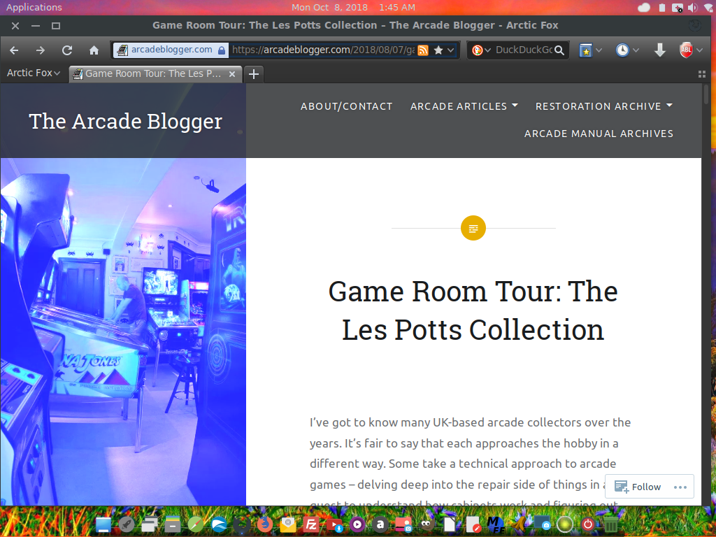

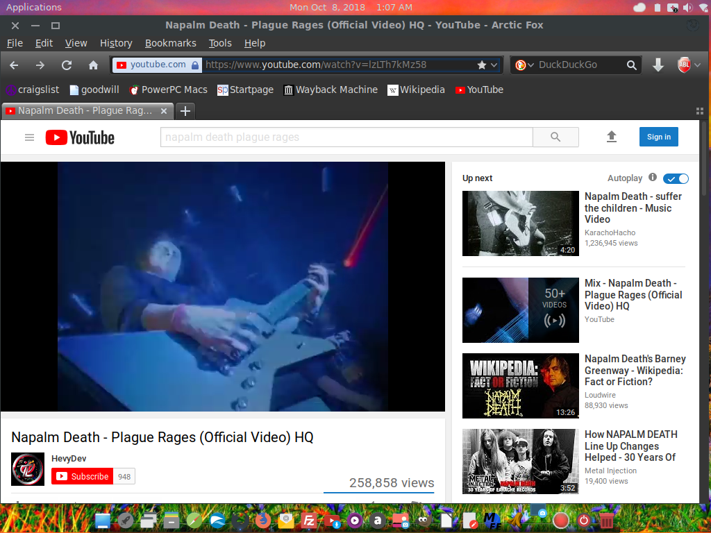

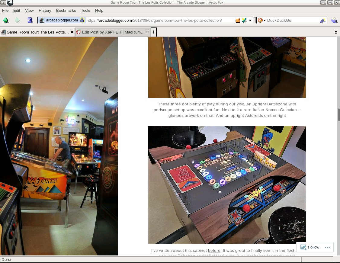

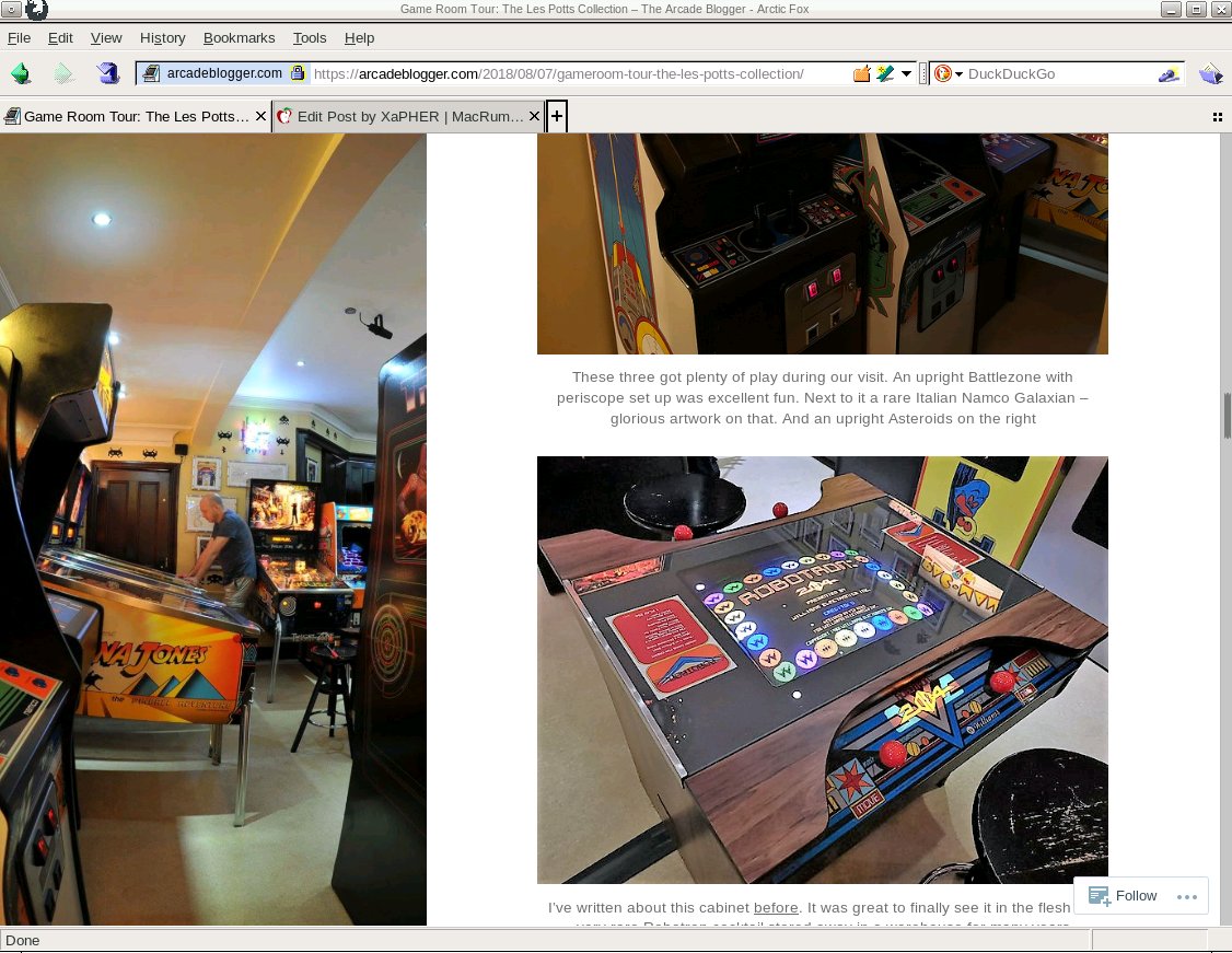

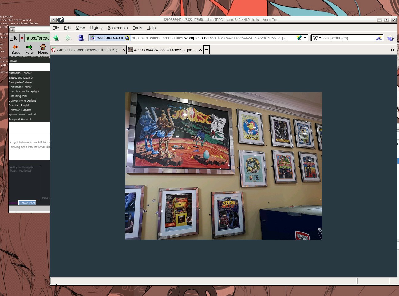

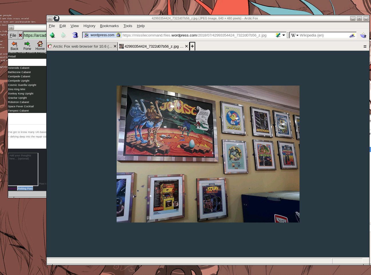

Screenshots:
The "blue hue" in the screenshot below is from the lighting in the video and not any browser issue. In older browsers, it's much more pronounced, and definitely an endian issue with those browsers that (upon pondering it) I could probably have fixed if I could find the color bit order within the older browsers' code... maybe?

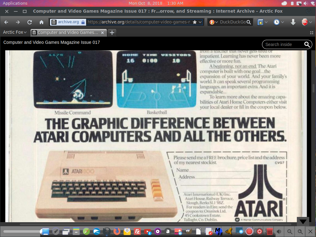

Testing archive.org's reader, which works perfectly:

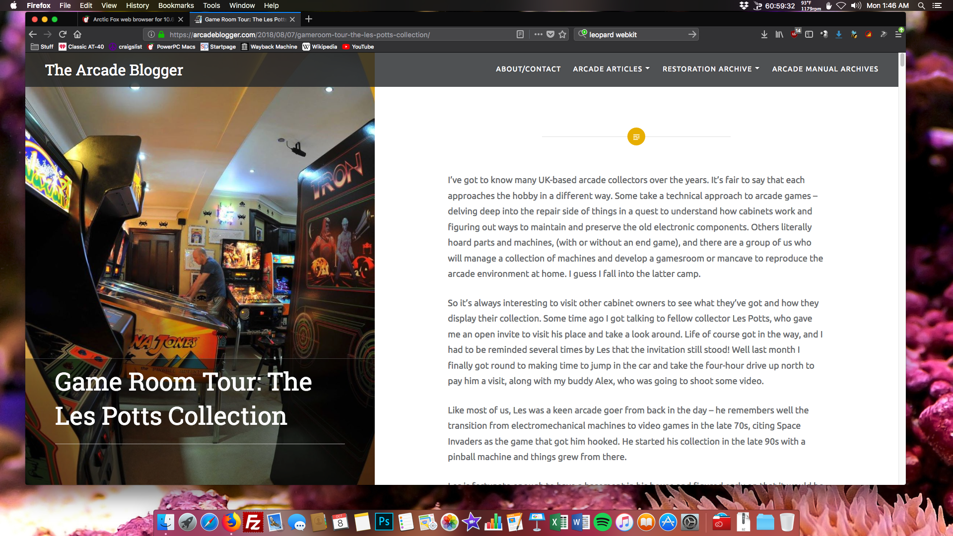

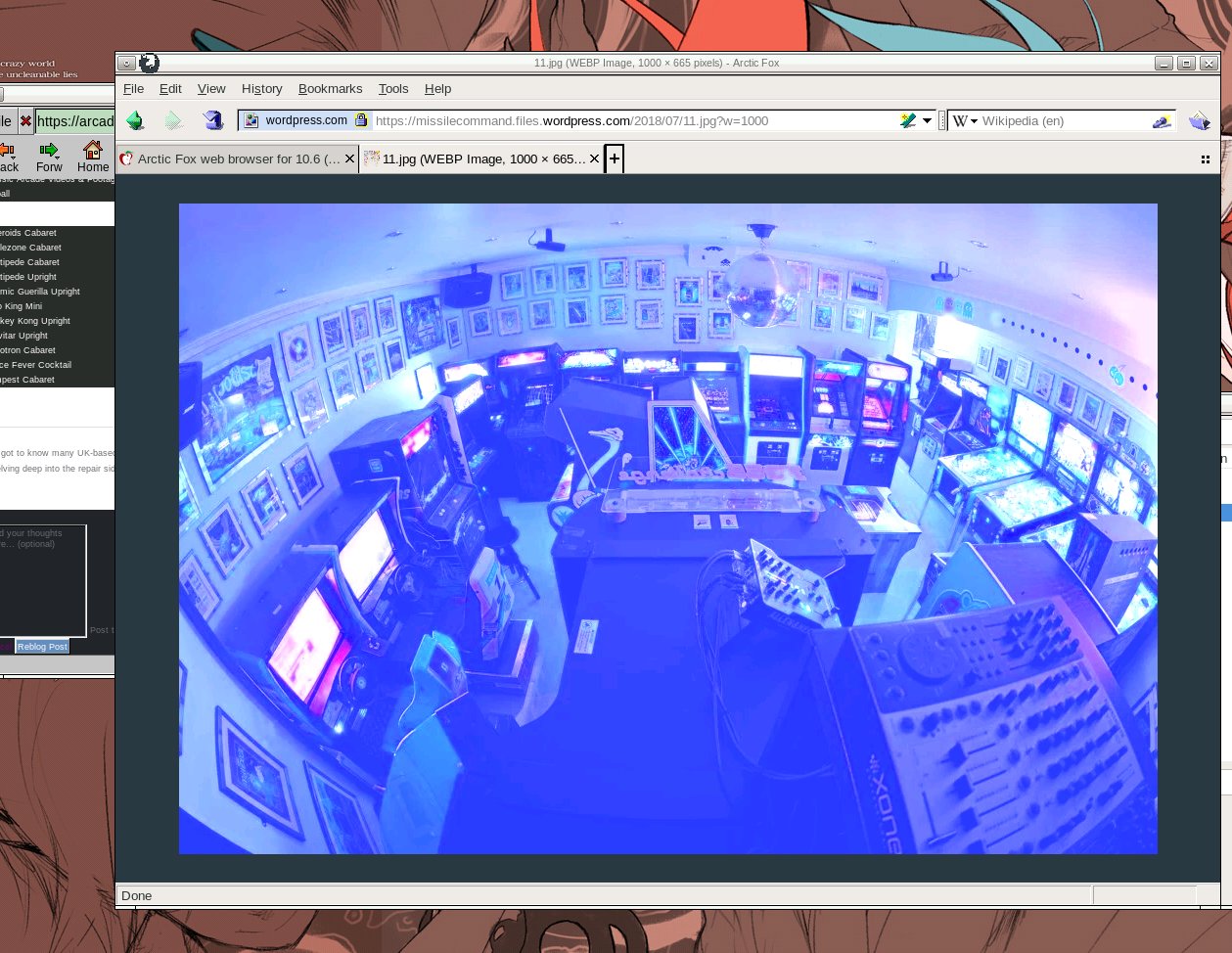

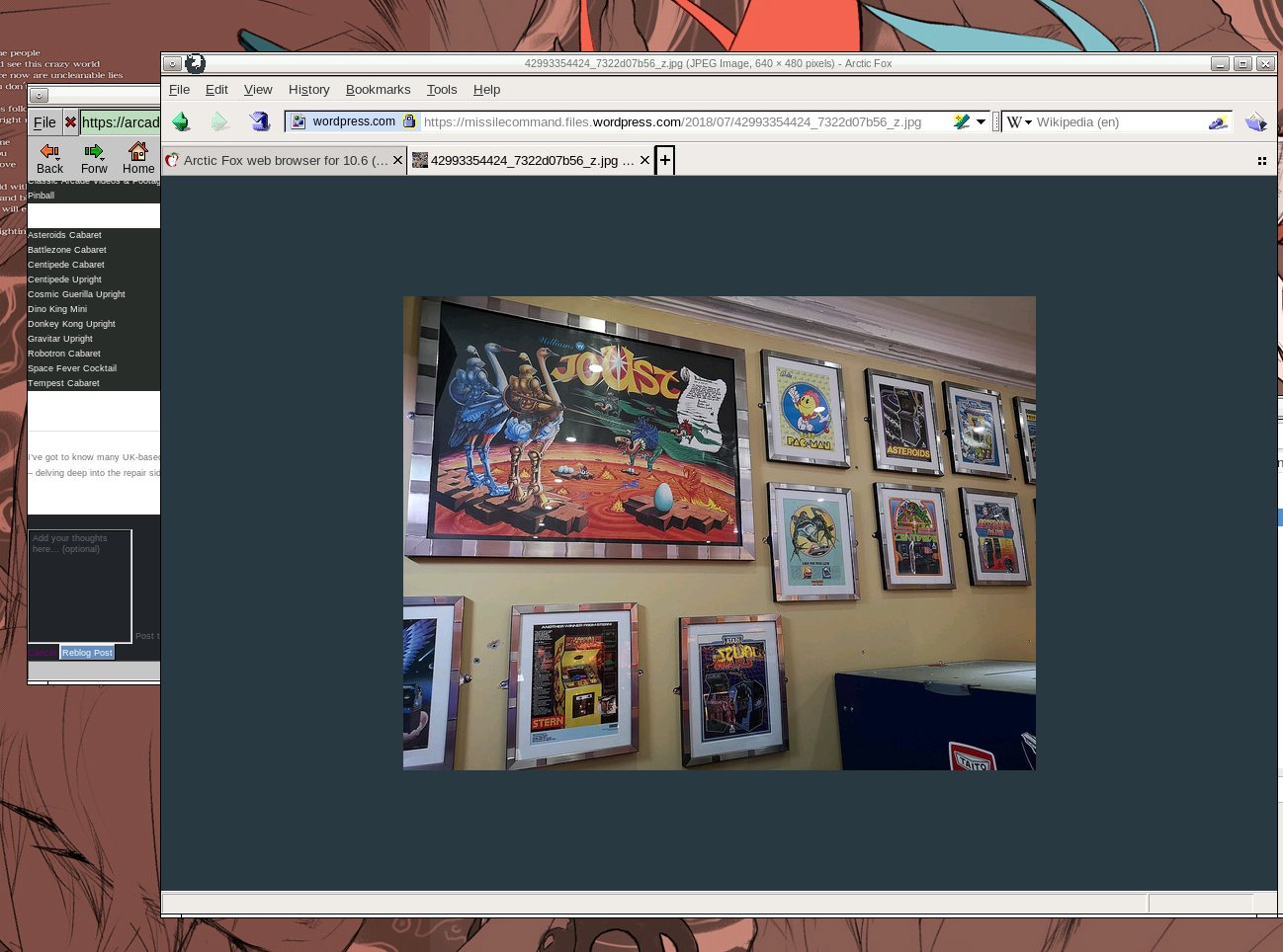

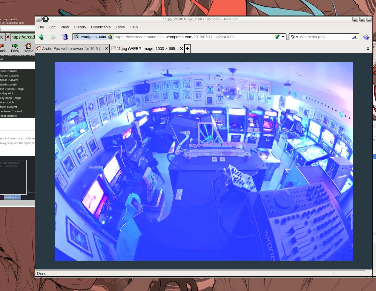

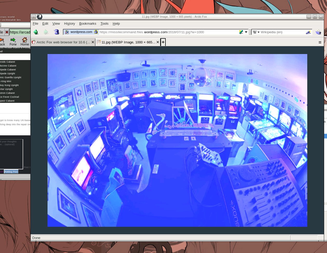

So... one issue I ran across was the blue hue issue in some pictures. Here's a comparison of a page with the issue in Arctic Fox on my iBook G4 with the same page in Firefox on my Mac Pro. The picture on the far left stays static, while the text and images on the right scroll. The images within the article itself are of the correct color, with a couple of exceptions that I theorize is due to the way that they've been resized. I'm probably wrong and need to test this theory more throughly:
I haven't come across this issue on any other page as of yet.

@swamprock Really nice to learn it works without any major problem. For the arcade blog you mentioned, it seems like the WEBP implementation is at fault (if you compare these two screenshots in title bar):
Lucky WEBP isn't that much popular... Well not enough for me to notice before now 🙂

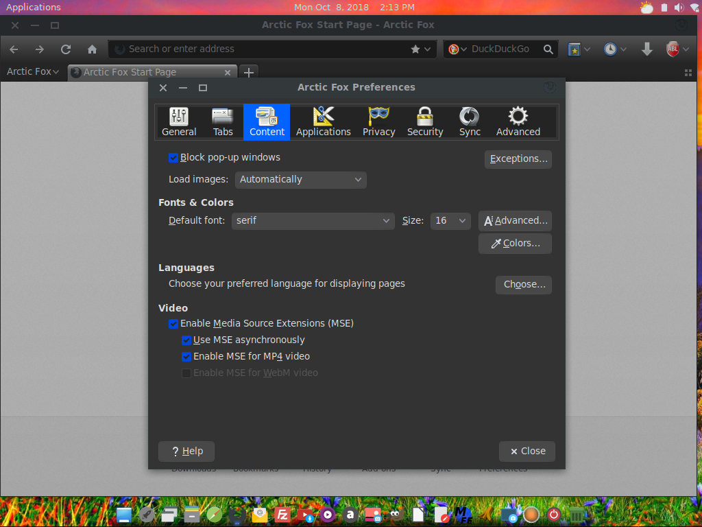

Hey, could you upload a screenshot of the video pane in preferences>content? Just to see if you have different available MSE options than me. Thanks!
View attachment 793149 View attachment 793150
Sure will. Give me a few hours and watch this space...
EDIT: Here you go:
No MSE for webm.

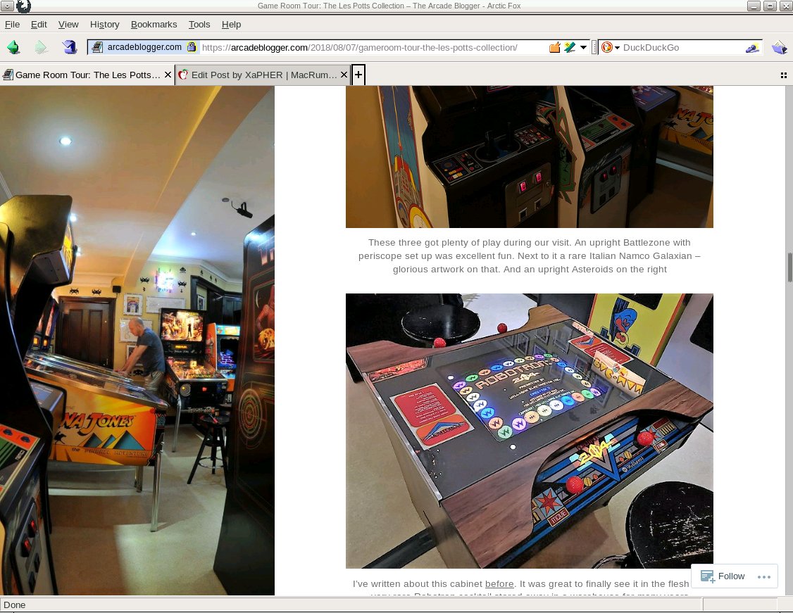

There are a few other sites where I noticed the hue issue in sporadic images, such as arcadeheroes.com. I'm not up on current web standards, so I'm glad someone knows what they're talking about. The older browsers that I have on my iBook (Midori, Qupzilla, luakit) don't have that issue in images (but have it in streaming video), just so you're aware...
I can't say I'm any better at web standards, it's just that lately I've spent so many hours on building mozilla forks that I can't really help but become more aware of the internals.
Thinking about it a little bit, since WEBP support is not universal, nearly all sites should be able to replace it with a jpeg equivalent. So I just altered the image-accept part of the http header in about:config (pref name image.http.accept) from
Code:
image/webp,image/jxr,image/png,image/*;q=0.8,*/*;q=0.5
to
Code:
and arcadeblogger.com no longer serves WEBP. Should be the same for any "reasonable" server.
Probably the best 'immediate' way to solve this.
Code:
to
Code:
Yep, that fixed it. Thanks.
