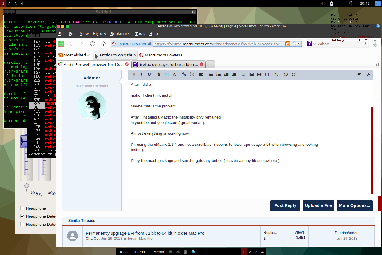

Hi wicknix,
I did the build wth ( mentioned somewhere in this thread )
make -f client.mk build
After I did a
make -f client.mk install
Maybe that is the problem.
After I installed uMatrix the instability only remained
in youtube and google.com ( gmail works ).
Almost everything is working now.
I'm using the uMatrix 1.1.4 and noya scrollbars. ( seems to lower cpu usage a bit when browsing and looking
better ).
I'll try the mach package and see if it gets any better. ( maybe a stray lib somewhere ).
Another thing is sound gets changed the selected output changes and I loose sound.
Have you seen anything similar?
Best regards,
voidRunner
