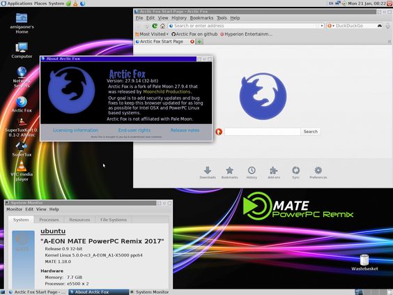

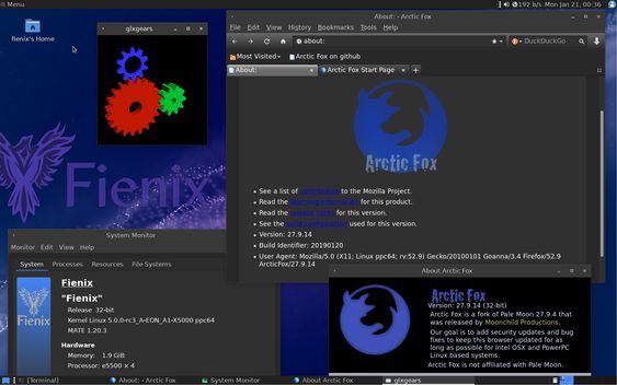

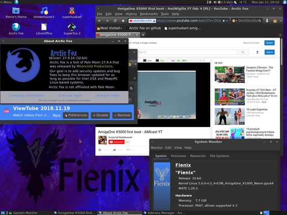

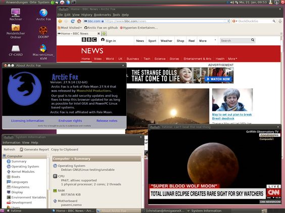

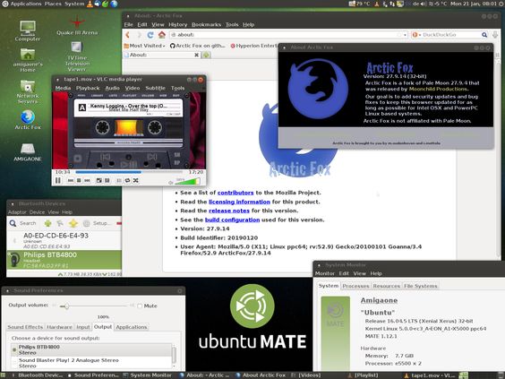

Hi Wicknix,
Thanks a lot for compiling Arctic Fox 27.9.14 for Linux PowerPC 32-bit! :)
I successfully tested it on the following Linux PowerPC distributions today (see screenshots below):
  • ubuntu MATE 16.04.5 LTS PowerPC
  • Debian Sid PowerPC
  • Fienix PowerPC
  • MATE PowerPC Remix 0.9
It works fantastic and it is really fast! Many thanks for your great work!
Cheers,
Christian

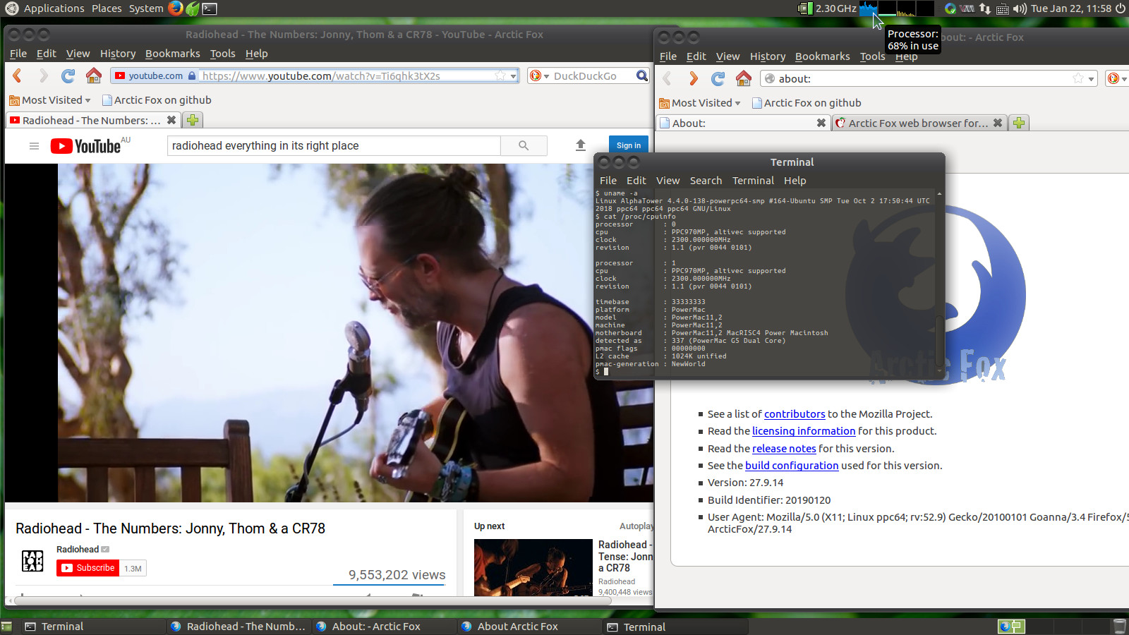

Just a quick report to say that Arctic Fox 27.9.14 is running perfectly on my Dual Core 2.3GHz G5 under Ubuntu MATE 16.04.5 LTS
Screenshot at 2019-01-22 11:58:01.jpg
The bundled old version of Firefox (v47.0) wasn't ever able to load YouTube videos in the browser. Arctic Fox appears to handle it with ease! No signs of the fans reving up. CPU usage is a steady 60 - 70% for 480p and plays in the background fine while I am doing other tasks on the system and browsing other sites (all stock settings - no javascript optimizations or other extensions).
Thank you to all contributors! This is a fantastic browser!
Glad to hear it. You could probably knock that cpu usage down to below 50% on your machine if you install grease monkey, the viewtube script, and vlc browser plugin. It made a huge difference on my mini g4. 90% cpu on 360p videos via html5 vs about 60% cpu use with the plugin active.
Cheers

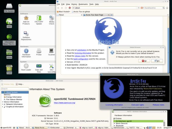

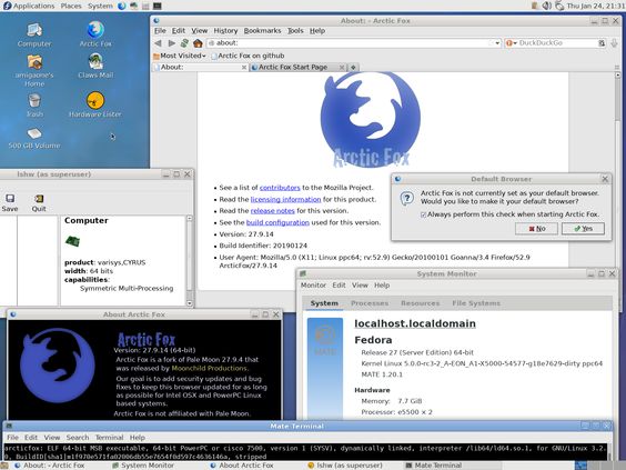

Hi All,
I was able to build Arctic Fox 27.9.14 PowerPC64 on Fedora 27 PPC64 today.
The first compiling wasn't successfull. I had to downgrade the GCC from version 7.3.1 to 6.4.1 with the command 'sudo dnf downgrade gcc gcc-c++ --releasever=25'. Additionally I integrated some parts of the AMD64 .mozconfig to my Non-AltiVec .mozconfig. After that I was able to compile it without any problems. Unfortunately I wasn't able to start it. I got the following error: '<jemalloc>: (malloc) Error in munmap();'. I added 'ac_add_options --disable-jemalloc' to the .mozconfig. After a new compiling it works without any problems.
.mozconfig
Code:
# This Source Code Form is subject to the terms of the Mozilla Public
# License, v. 2.0. If a copy of the MPL was not distributed with this
# file, You can obtain one at http://mozilla.org/MPL/2.0/.
export CC="gcc -flax-vector-conversions -O3 -falign-loops=16 -falign-functions=16 -falign-labels=16 -falign-jumps=16"
export CXX="g++ -flax-vector-conversions -fpermissive -O3 -falign-loops=16 -falign-functions=16 -falign-labels=16 -falign-jumps=16"
export LDFLAGS="-latomic"
mk_add_options MOZ_OBJDIR=@TOPSRCDIR@/obj-ff-dbg
ac_add_options --disable-crashreporter
ac_add_options --disable-tests
ac_add_options --disable-debug
ac_add_options --disable-updater
ac_add_options --enable-mozril-geoloc
ac_add_options --disable-webrtc
ac_add_options --disable-safe-browsing
ac_add_options --disable-parental-controls
ac_add_options --enable-release
ac_add_options --disable-necko-wifi
ac_add_options --disable-eme
ac_add_options --disable-gamepad
ac_add_options --enable-dbus
ac_add_options --disable-gio
ac_add_options --disable-pulseaudio
ac_add_options --enable-strip
ac_add_options --enable-install-strip
ac_add_options --enable-application=browser
ac_add_options --with-branding=browser/branding/arcticfox
ac_add_options --enable-optimize="-O2 -fno-schedule-insns2 -fno-lifetime-dse -fno-delete-null-pointer-checks"
I used these commands to build, test, and package:
Code:
./mach build
(starts the configuration and build process)
Code:
./mach run
(tests completed build with scratch profile)
Code:
./mach package
(creates the self contained archive which you'll find in <Arctic Fox src directory>/obj-ff-dbg/dist)
Download: arcticfox-27.9.14.linux-powerpc64.tar.bz2
It is important to compile a 64-bit PowerPC version of Arctic Fox because Firefox doesn't work reliable on Fedora PPC64. Midori also isn't a good option because it crashes very often on Fedora PPC64. The same problems on openSUSE Tumbleweed PPC64 so Arctic Fox is the solution. :) Arctic Fox is the best browser we have on Linux PPC currently. Many thanks to Riccardo Mottola for his help with the compiling of a PPC64 version.
Screenshots of Arctic Fox 27.9.14 on Fedora 27 Server PPC64 (A-EON AmigaOne X5000):
Screenshot of Arctic Fox 27.9.14 on openSUSE Tumbleweed PPC64 (A-EON AmigaOne X1000):
Cheers,
Christian

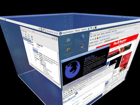

Picture pretty wild on above post (cube, 3d desktop version), never seen something like that. Was just go on a add, think only change I made was to Remember History in pref-privacy, if remember, it ask me to reboot attic fox (believe that's what it asked) but did that and seam to work fine. Other thing was, wasn't sure what add one etc. were (had some idea). Was kind of overwhelmed little bit but was checking em out and came to me. Was reading last night and if got that right, ways could kind of customize and stuff, and wow, lots of options, awesome.

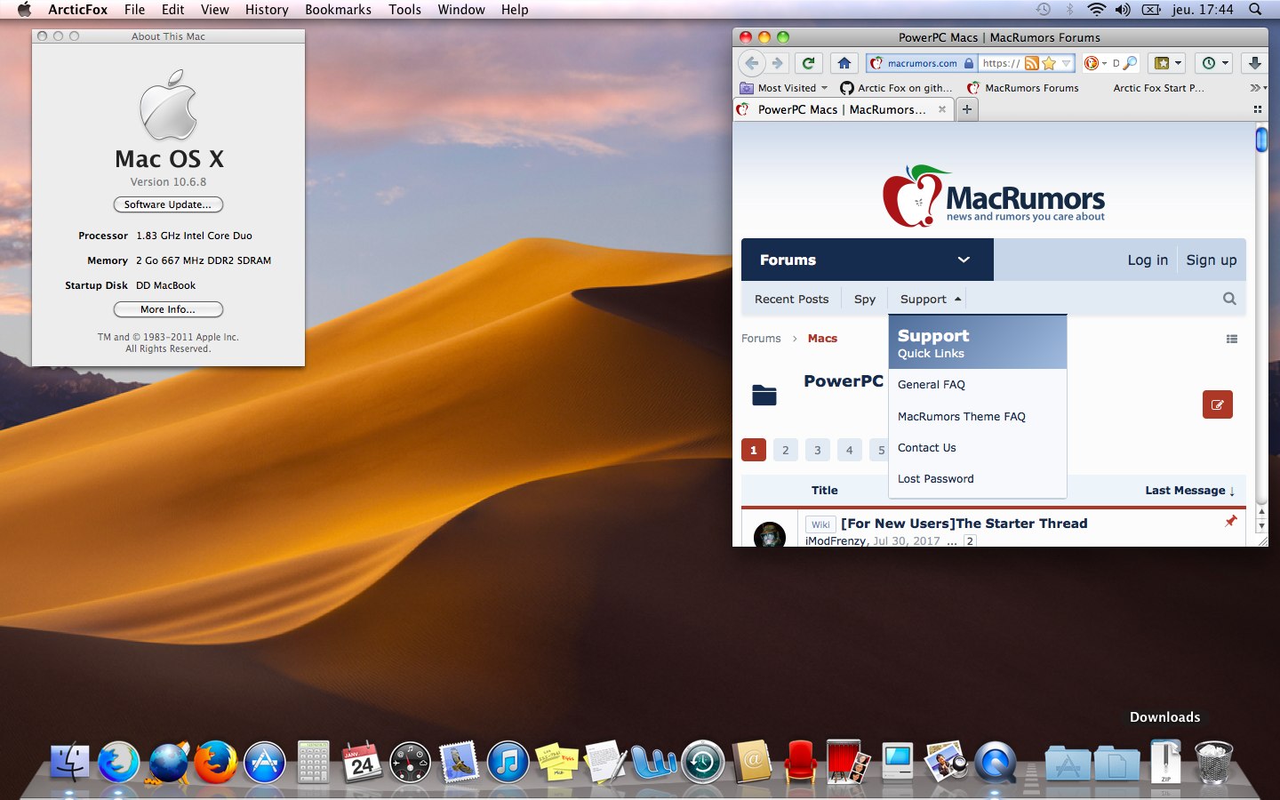

I also wanted to thank you Wicknix. You've saved our computers with your ArticFox project.
I wanted to report a bug though. I have a 2.16 Ghz 17" MacBook Pro with OS X 10.6.8 (the highest these computers will go because they are 32-bit (1st-gen. Intel MacBooks). As a result, I am using the 32-bit ArticFox 27.9.14 browser which works great with everything I've thrown at it, but pages 2 - 5 of this thread on this website always brings down my whole computer. I can go out to page 1 of this thread, but not 2 - 5 and I'm too afraid to test other MacRumor threads because I don't want to damage my hard drive with too many crashes (I've lost another computer that way before).
Can I send you some kind of crash report an, if so, how do I do that? Take care.
