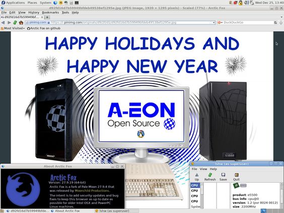

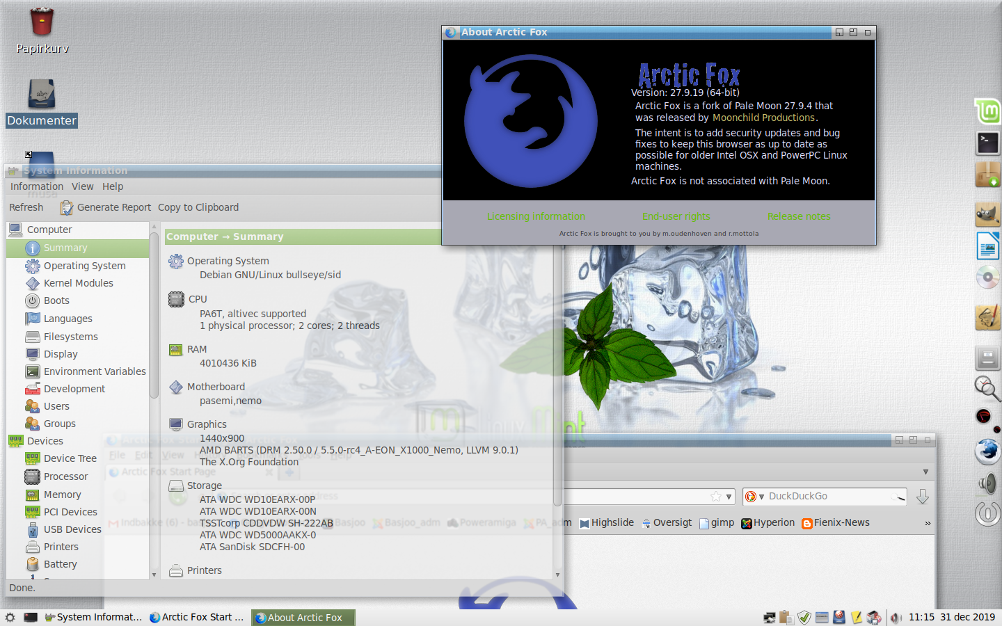

My Arctic Fox 27.9.19 PowerPC64 package works on Debian Bullseye/Sid PPC64 too!
Download: arcticfox-27.9.19.linux-powerpc64.tar.bz2
I wish you a happy New Year!
