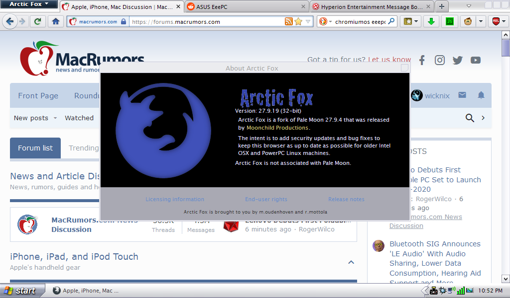

Not powerpc or snow leopard related, but i fired up my old asus eeepc 900a to test out AF 27.9.19 on winxp. Runs like a champ. :)

Is anyone aware of any x86 .debs of Arctic Fox without SSE2?
