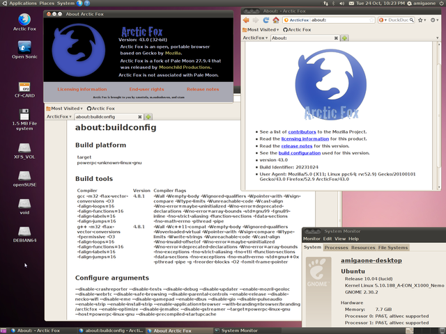

I compiled a non-altivec 32-bit version of Arctic Fox 43.0 for Ubuntu 10.04 and higher (12.04, 14.04, 16.04 etc). It also works on Void PPC, MintPPC (Debian Sid), Debian PPC 32-bit, and Fienix.
.mozconfig
Code:
# This Source Code Form is subject to the terms of the Mozilla Public
# License, v. 2.0. If a copy of the MPL was not distributed with this
# file, You can obtain one at http://mozilla.org/MPL/2.0/.
export CC="gcc -m32 -flax-vector-conversions -O3 -falign-loops=16 -falign-functions=16 -falign-labels=16 -falign-jumps=16"
export CXX="g++ -m32 -flax-vector-conversions -fpermissive -O3 -falign-loops=16 -falign-functions=16 -falign-labels=16 -falign-jumps=16"
export LDFLAGS="-latomic"
mk_add_options MOZ_OBJDIR=@TOPSRCDIR@/obj-ff-dbg
ac_add_options --disable-crashreporter
ac_add_options --disable-tests
ac_add_options --disable-debug
ac_add_options --disable-updater
ac_add_options --enable-mozril-geoloc
ac_add_options --disable-webrtc
ac_add_options --disable-safe-browsing
ac_add_options --disable-parental-controls
ac_add_options --enable-release
ac_add_options --disable-necko-wifi
ac_add_options --disable-eme
ac_add_options --disable-gamepad
ac_add_options --enable-dbus
ac_add_options --disable-gio
ac_add_options --disable-pulseaudio
ac_add_options --enable-strip
ac_add_options --enable-install-strip
ac_add_options --enable-application=browser
ac_add_options --with-branding=browser/branding/arcticfox
ac_add_options --enable-optimize
ac_add_options --disable-jemalloc
ac_add_options --disable-gstreamer
ac_add_options --target=powerpc-linux-gnu
ac_add_options --host=powerpc-linux-gnu
ac_add_options --disable-precompiled-startupcache
Download: arcticfox-43.0.en-US.linux-powerpc-libc6_2.11.1.tar.bz2

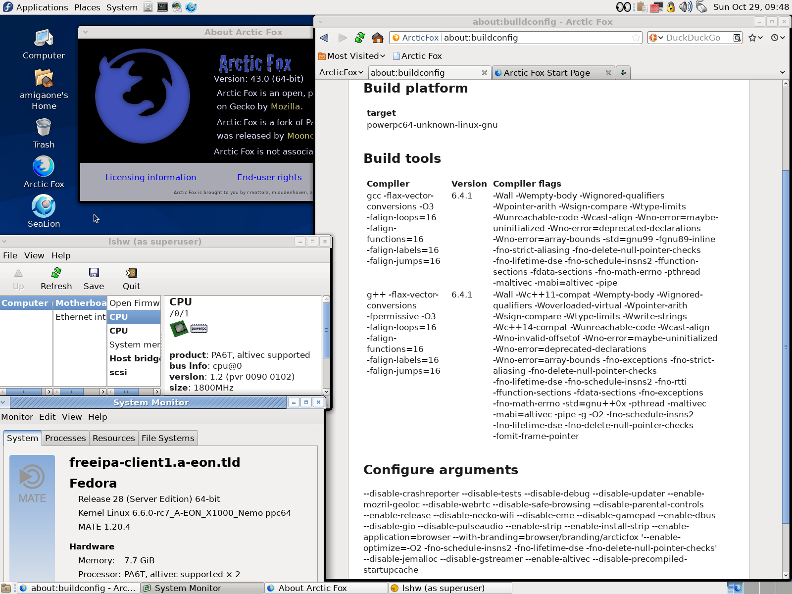

Hi All,
I compiled a Linux PPC64 version of ArcticFox 43.0 with AltiVec support today.
Download: arcticfox-43.0.en-US.linux-powerpc64-altivec.tar.bz2
Further information: forum.hyperion-entertainment.com
Cheers,
Christian
