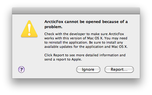

I deleted my old profiles but I can't get ArticFox to open on 10.6. What am I doing wrong? It worked before I updated it

Hi
--> Click on Report, then you see the reason why its not launching
This is my error, libc++ was not installed on macosx before 10.7.
Exception Type: EXC_BREAKPOINT (SIGTRAP)
Exception Codes: 0x0000000000000002, 0x0000000000000000
Crashed Thread: 0
Dyld Error Message:
Library not loaded: /usr/lib/libc++abi.dylib
Referenced from: /usr/lib/libc++.1.dylib
Reason: image not found

Dyld Error Message:
Grab the attachment below and copy those 2 dylibs to /usr/lib. AF will work again. It seems the new owner of AF isn't relinking the .app with those files included in the .app itself like i use to.
Cheers
  • libc++.zip
Cheers
Nice :) and it works !
