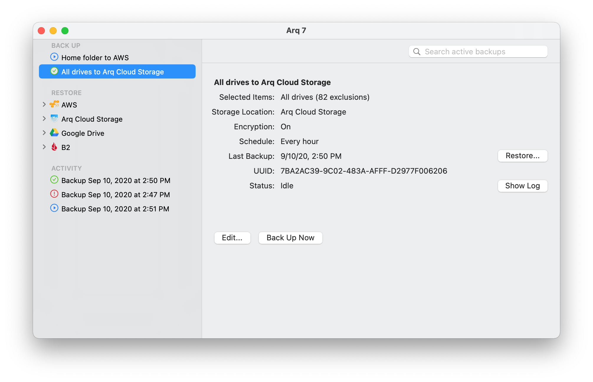

I'm not really happy with Arq 6 from an interface perspective. It is very limited compared to Arq 5. I really miss proper logging. It also does not show the full list of folders I've selected for backup from within the GUI window. I have to drill down into the selection box after clicking edit. But the stronger SHA256 hashing is reason enough to be using it instead of Arq 5.
The good news is that Arq 7 is going back to a native Mac interface and seems to have many of the missing Arq 5 features. Is anyone using the pre-release version of it? There is some information and screenshots at the link below.
gilby101
macrumors 68030
Mar 17, 2010
2,976
1,643
Tasmania
Does it bring back full logging of all actions to the file level?
Yes.
To have some influence over what is in the final release, use Arq7 and make suggestions to support.
My recommendation to people is to use either Arq5 or Arq7. I feel any uncertainties because Arq7 is prerelease are less than the known problems with Arq6. But make your own decision on this.
