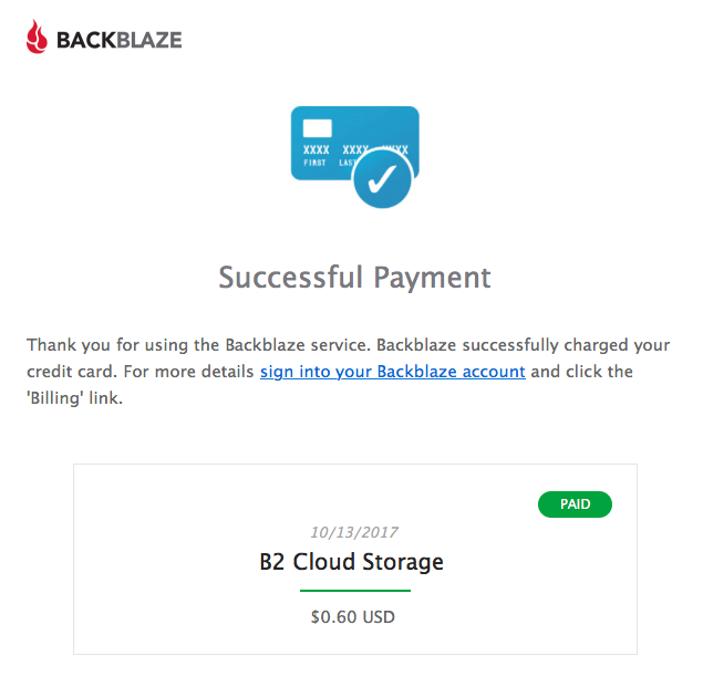

I just thought this email today was funny and worth sharing.
I am storing ~129 GB at BackBlaze B2 via Arq... and it's so cheap that I'm not sure how they're even making any money from me, since credit card companies themselves charge a fixed $0.30 fee per transaction, plus a percentage of the remainder (usually 2.9%). So BackBlaze is only getting $0.30 minus a few more percent after transaction fees... Yikes. 😵
But I am not complaining. I love the price. 😉
