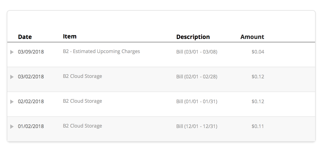

Just got my bill - $.80 - Backblaze - for 183 GB (no downloads) for almost a month. Not bad at all. I've been SUPER HAPPY with Arq and Backblaze.
I recently moved my data from one external drive to another and had to delete the Arq backup and re-add the data from the new external drive --- and Backblaze was smart enough to realize the data was already there so no additional space was used cuz all the files already existed (I used the same encryption key as the first drive).
Very happy. $.80/mo is insane for 183GB.
I got that same info in an email.
I swear, I don't know how they are making any money at all. They sure are not going to be able to retire off what I am paying. :D

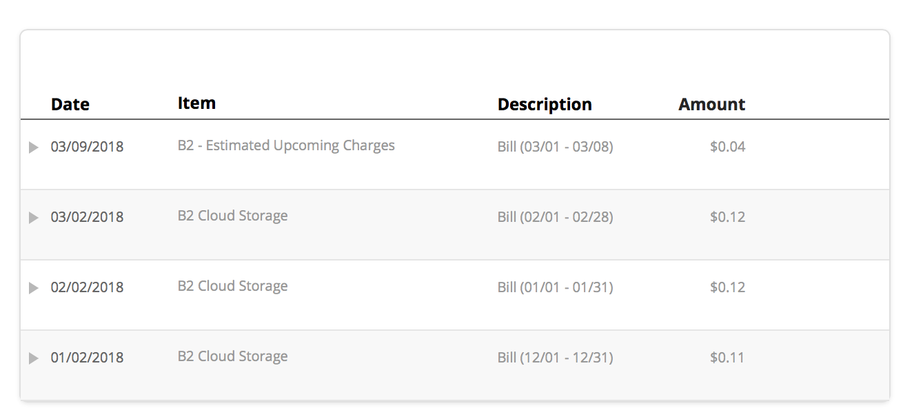

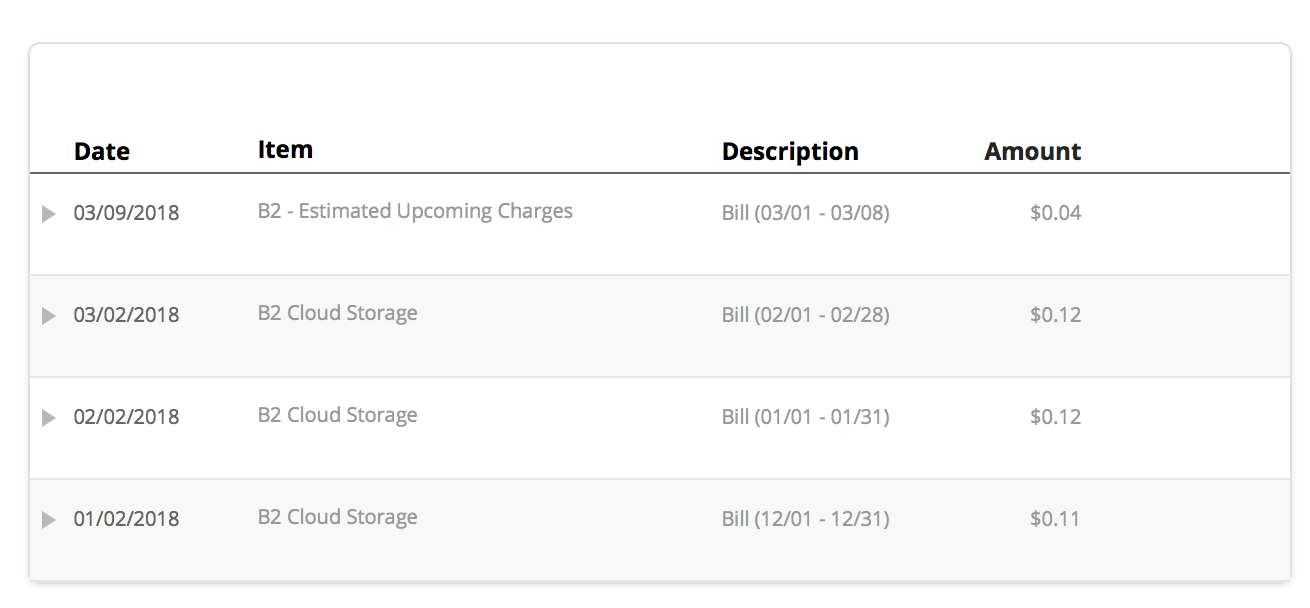

I'm not getting off quite as scot-free as you guys :) but my biggest B2 bill so far has been all of $1.58, and that was in a month when I moved around a huge amount of data as I resolved some issues with certain other vendors Who Shall Not Be Named Here. Guess there must be a lot of us using either B2 or the "regular" Backblaze service, or they'd be in a world of hurt.
I agree. I felt bad so I went and bought a https://www.backblaze.com/backup-pricing.html at the year price just because I really like this company (I'm not going to use it). Figured that would at least make it so I'm a customer who increases their annual revenue. That and I'll have to download some too just to see if it works. :p Their blog alone makes the $50/year worth it. I could read those HD stats 20 times over and still enjoy it. lol.
Not that I think that people just storing data are causing loss - my guess is there is profit, just tiny amounts because they only have 1 data center and storage is fairly cheap. I think you're right tho, they make most of their $ on downloads.

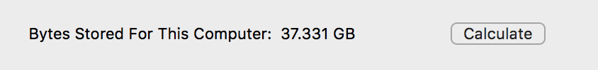

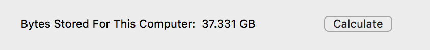

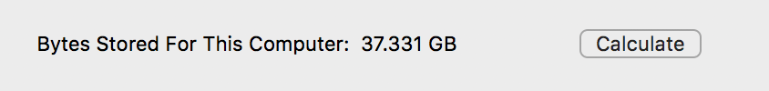

If you have Arq on multiple computers it will save the data based on the computer. See?
wYOJ0iRkqeQ2wsqr6yCIz5JCde3BjdZ-S-48me3Ti2XOGFCXZ3tBT9MCaz93zkSu0ivu5J9u5FbwGuanrah0lBcfpSlp5ZFXpI4kq_5QwKRaNYFPvKl29TlP-xcs2LjAyMln6jovRlq20ecAlvhiW4GsRzTv-8a0EAEB7RFDyxldK5FZFJaeFW_MWW6H7Qi8rpWlvgKZY7OiNNww6iOQIn24U9v-eFJDG0W-B7JkJ6tpyXj67vlVwriUWWQKo5Kbv3uELTOFkQQ-koEmVF0RAdhORcH-b5gM56eAZjNml7heDo0PfyAbTH9bzw7ZoMyg2Ow1Y7k34PYEabtseELL592NNdHJWoDVac7xuP4fR-jisSkxHwFzSzMPrGe_zDz4jV3PfaA1EsObhcDKERwlLOwDmX29PENa0ZDLhz6dFpOqvaqw7NyeQZmdTmXa-4RfJR0DG-0_8fMzbI1tjwPSlyZGDHVLvpOQwscDmhA_Xi8uzJz3p1p0QXzzd8mXcDs--DtkZ2icCfywX8eMzqXCCW_LdcUCruMfaD1vwuzZ2pU1dRi8P9NI_iRFH86kA5qwZPL3NTHIXYorfImm4Nj0wylie5GD83nwAArcHzWU=w237-h192-no
I have my wife's two computers backed up to B2 via Arq, my 4 computers backed up via Arq to B2. It separates them via computer. So you can't have duplication - it is each separate.
