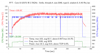

Here:
December 31 top and July 31 below. The drop in average fps was about 0.40.
The x264 was very similar - with a 0.50fps drop on average.
In retrospect, it doesn't seems like it deteriorated as much as I thought. I will definitely keep doing these tests periodically.
First, I don't see much difference to be honest. Average and peaks are very close. I don't see the fps result in the bottom one but I'd think they are close (assuming you used the exact same settings in the GPUTest test). 0.5 fps drop in x264 is not significant, mine goes up and down by that much when running multiple tests consecutively.
Second, the idle temperatures are very different (look at the start): one is 45C the other is 60C ... obviously you either were in a hotter room, or had more tasks running in the background. It's actually a pretty good result considering!
In general, these stress test are best run with nothing else running in the background, i.e. Activity Monitor should show you 99% idle cpu on average. I always close all running or resident apps (in dock or tray).
Definitely agree (as admitted already in the post). Good point about the idle temperature too. I can think of two reasons 1) Winter-Summer change or 2) running the test too soon after the x264 one.

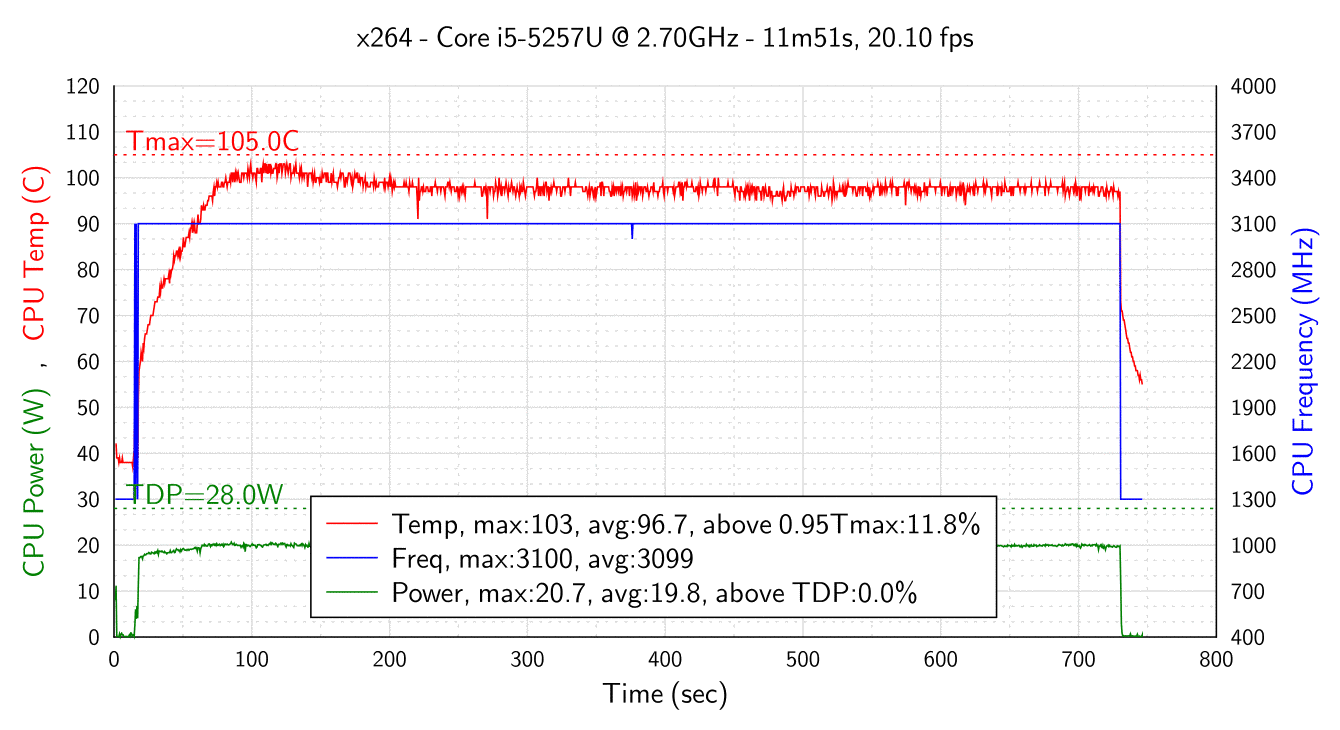

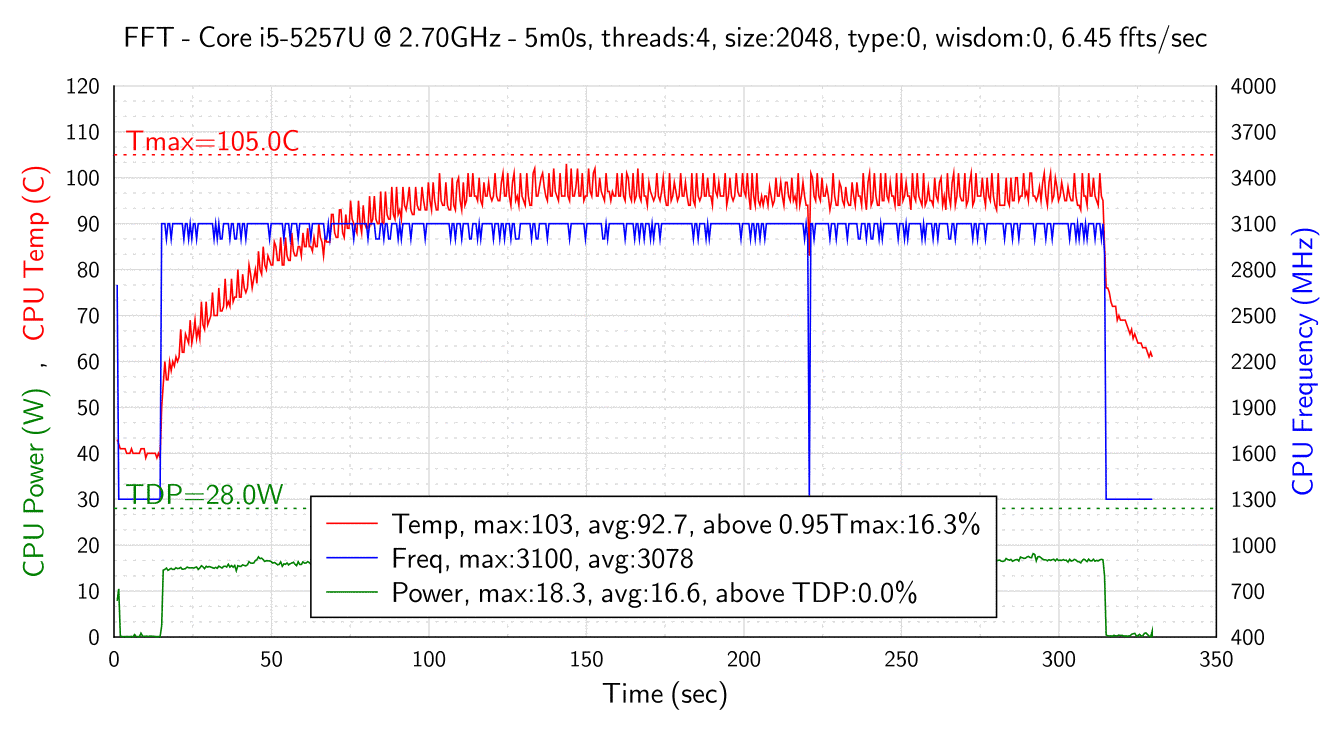

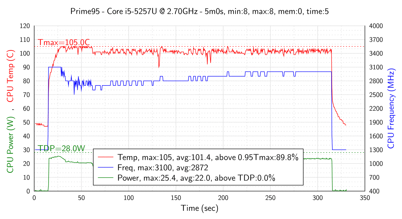

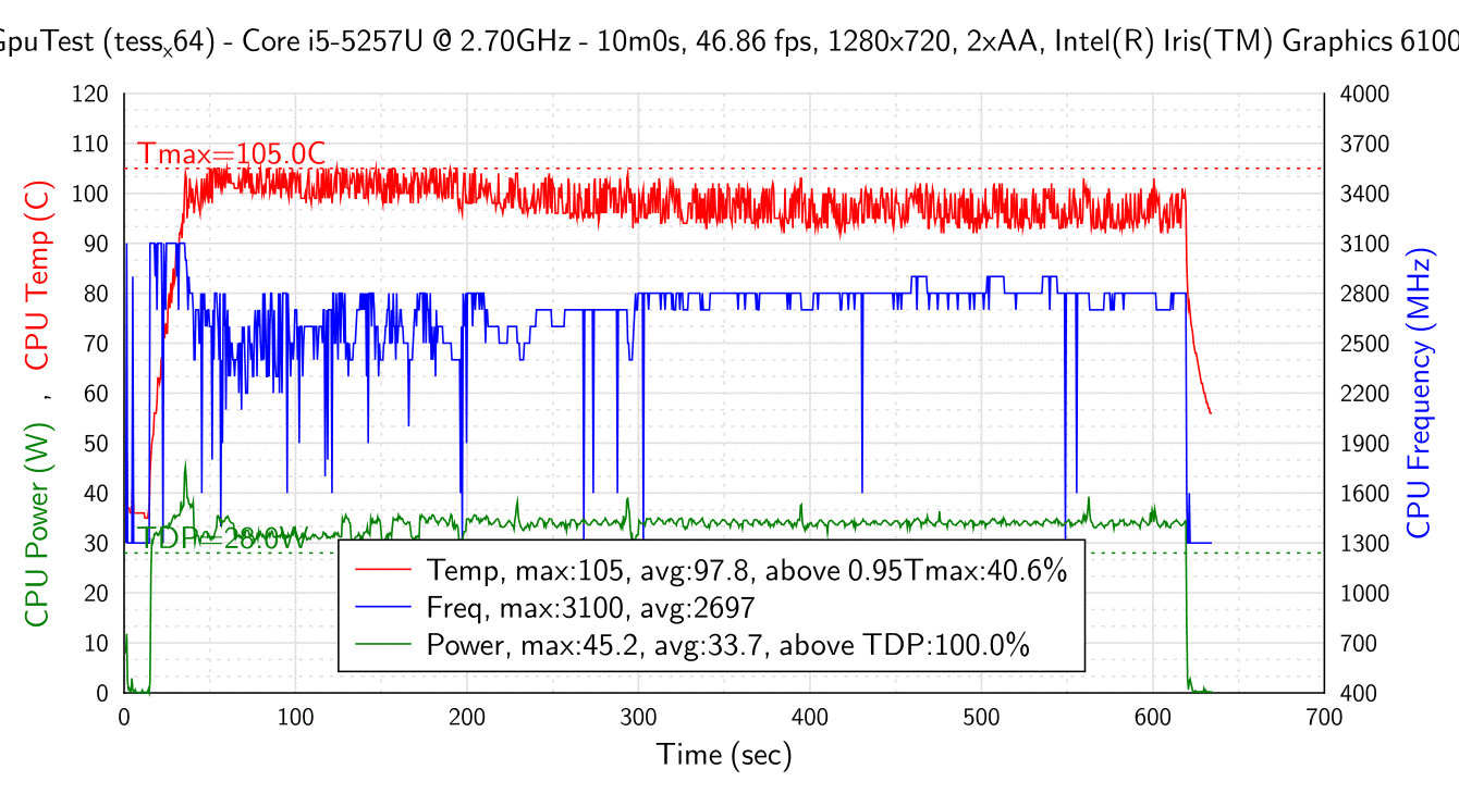

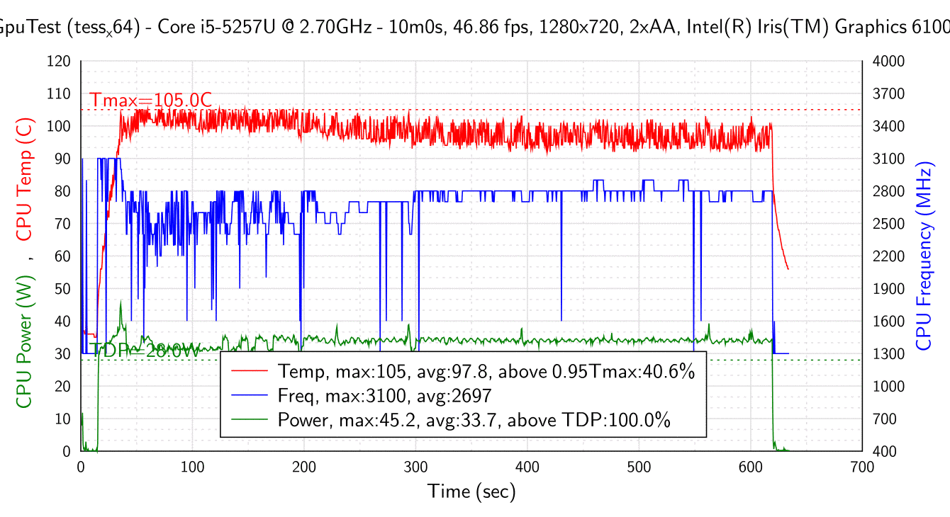

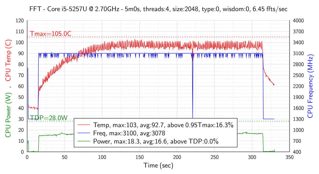

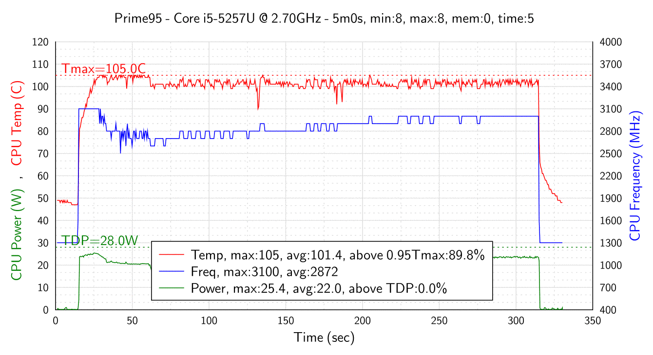

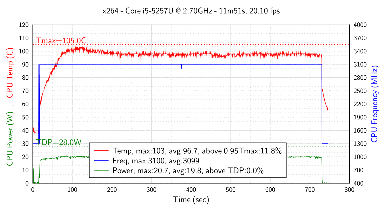

Heres my 2015 rMBP 13 inch OSX 10.11.6 Intel Iris 6100
ambient temp 22˚C
