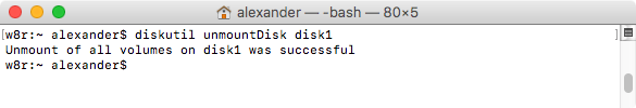

Get this error when I am trying to add the Win10.vmdk to VirtualBox, what can I do? Also getting an error running the command...
Kind regards,
Mark
sudo diskutil unmountDisk disk1
The unmountDisk verb is similar to umount, but it unmounts an entire disk instead of one volume. Disks are specified with their mount point, as seen above. You can’t unmount your boot disk or volume, and you’ll get an error if you try to unmount a disk or drive that’s currently in use.

Hi there
I'm on the disk preparation part, and when I type the command I getting this error. Following the directions precisely as written. I'm not sure what's wrong. I'm on Big Sur at the moment.
Hi,
Wasn't tested on Big Sur and perhaps VirtualBox has since changed.
Can you try with Catalina or earlier to rule out the Big Sur angle?
Hi there
do you have vbox installed?
Couldn't have been "Following the directions precisely as written" if not, but looking at things again, that does seem the most likely cause of the issue!
Yep that's what the issue was, I didn't have it installed. Well I was able to get all the way through until the very last step where I have to restart into the windows drive. I have open core installed and I don't seem to see the drive in the boot screen so I can select it.
