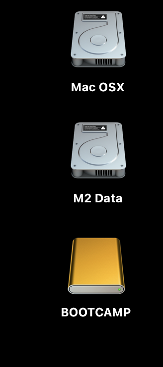

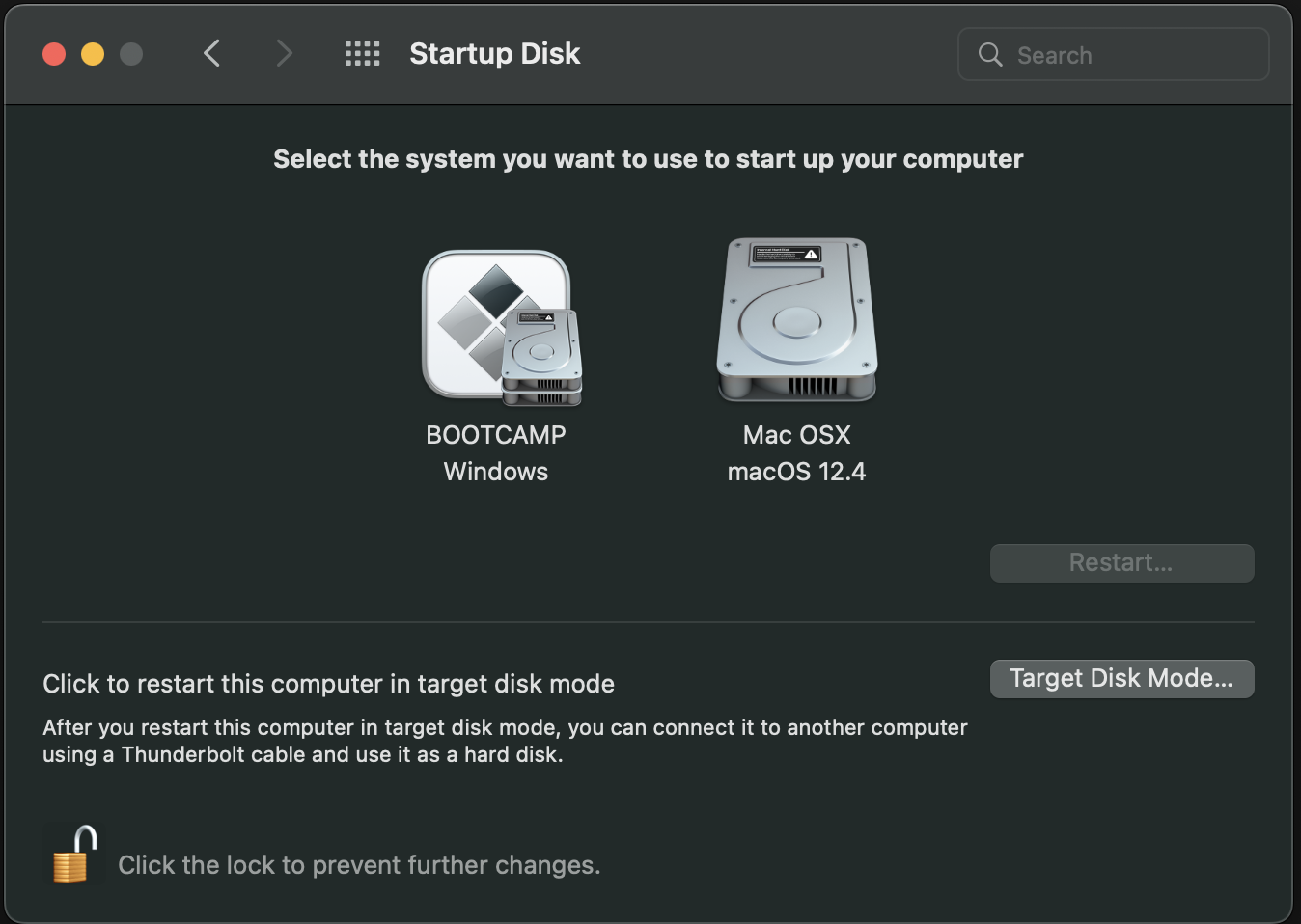

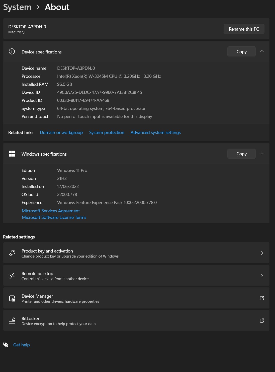

I have windows 11 that boots fine from external M2 980 pro drive.
Start bootcamp assistant, at the top menu bar download all driver files for bootcamp then exit bootcamp. save files to USB drive.
Boot into recovery, at the top menu bar you have security option, disable T2 security enabling boot from external drive.
have the latest version of windows 10 on usb to install on USB drive.
Format in disk utility the drive you wish to load windows on in FAT, then shut down your mac. put USB stick with windows on to USB port, hold option key while booting, then select windows USB install. (NOW THIS IS IMPORTANT BIT IT SEEMS THAT NOTHING IS HAPPENING but wait just leave it, maybe 3 mins later windows install loads.
Then select the drive formatted earlier in FAT, delete all partitions on that drive, then hit new.
then carry on and install windows 10, after its loaded you can load the bootcamp install from USB drive. this then gives you the option to reboot to Mac OSX from windows.
After all drivers have been updated you can then disable the WIN 11 check and update to windows 11 keeping all your apps and files which you wont have any apart from bootcamp install on win 10.
After it has updated to win 11 you will find bootcamp will still let you boot into Mac OSX and when you start the machine you can hold down the option key and boot into windows at any time. can also be selected from preferences start up disk in Mac OSX.

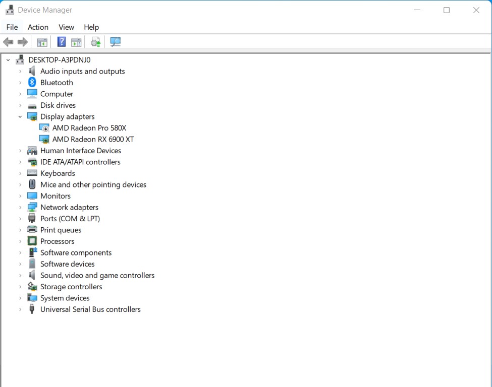

I have a 6900xt in my Mac pro 7.1 so used DDU to un install all the bootcamp AMD drivers so i could install the Latest AMD drivers directly. I have the Apple 580x also installed via these drivers and both work under windows with no problems all works fine. but you might not need to do this if useing an Apple GFX card only.

I got it working eventually.
And this is a way for some others if you have many disk drives in your Mac Pro 7,1:
  • I took one of the NVME drives and configured it for the windows Installer. Format with EXFAT so the install ISO can be copied onto that drive. This way will make the installer run really fast.
  • The other drive just format with FAT32 and call it something obvious like BOOTCAMP
  • Reboot Mac and hold down option (easier with wired keyboard) then choose Windows.
  • Followed Matty_TypeR's instructions to get the installer to format your BOOTCAMP drive (should be empty)
  • Eventually after many restarts it will run Windows 10
  • Install the bootcamp drivers.
