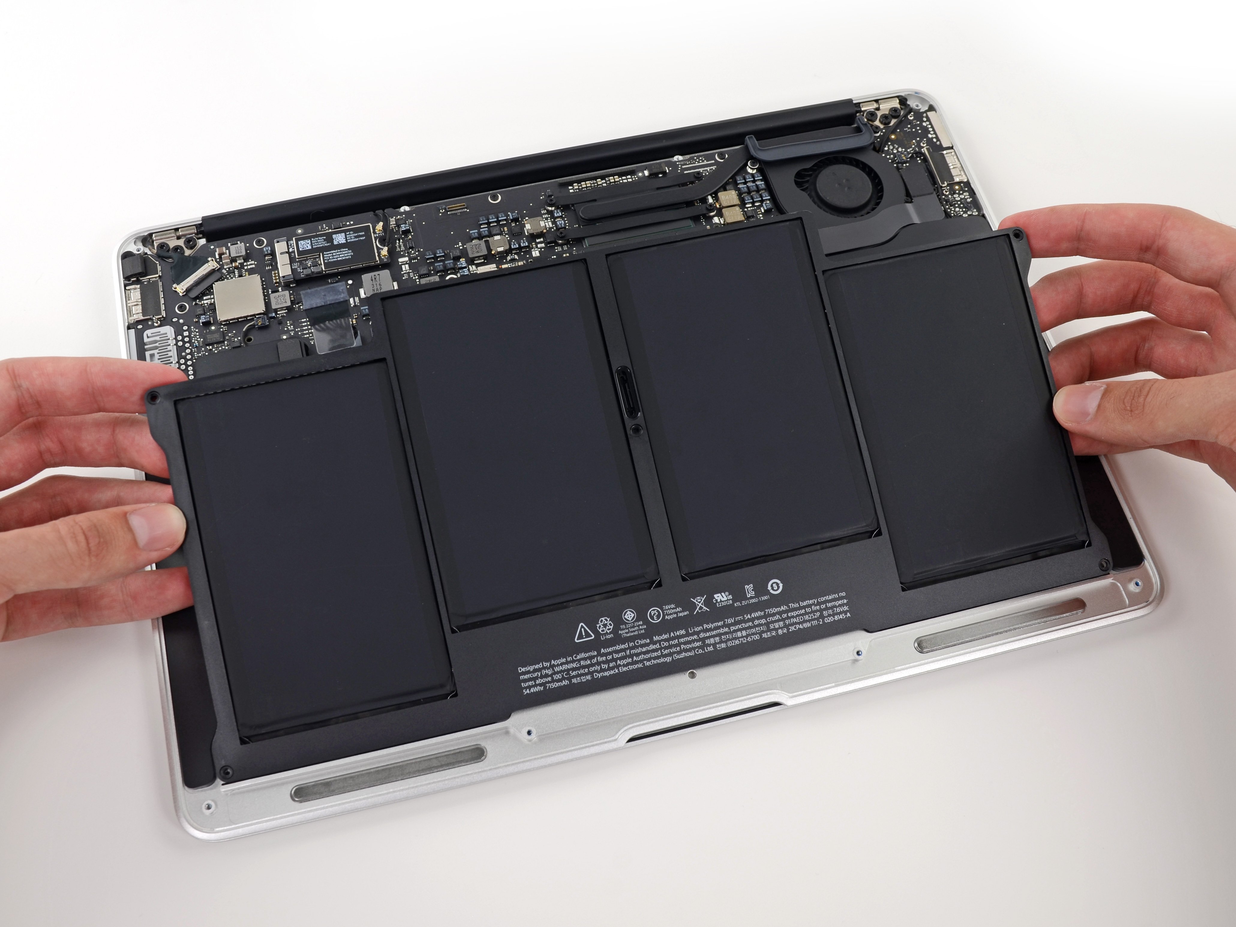

OK, you are getting a lot of opinions in this thread from people who have never done a MacBook battery replacement. Having already successfully replaced a swollen battery on my 2015 13" MBP (which is a lot more difficult than yours) - this is what I would do:
1. Buy one of these, which is the brand I bought (check it is for the right model MacBook Air):
Or if you want to spend more for no real benefit:
2. Battery replacement in your MBA is dead simple, it is not even glued in. Only 5 steps! While wearing eye protection, carefully remove the existing battery following this (check this is for the right model):
3. See if the deformed case returns to normal after the swollen battery is removed. If so, put in the new battery.
Done.
Good luck.
Reactions: zoran
It’s a 13" early 2015 MacBook Retina but thanks 😉
Is placing a battery as difficult as removing a swollen one?
Ah ok, that is a lot more difficult than the Air, also batteries are more expensive. The most difficult part is removing the glued-in battery, and there is a high risk of breaking a cable or connector. Placing a battery is easier than removing it.
This would be a project for someone very comfortable with taking apart electronic devices and prepared to accept the risk of permanent damage.
