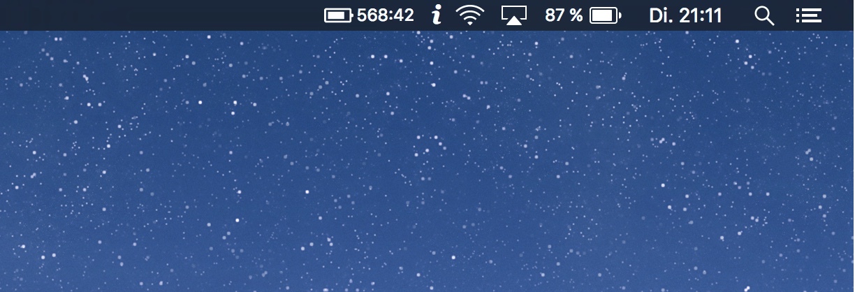

I really don't understand why you guys are crying regarding the battery life of the MacBook Pro Touch 15'#
87% and still 568:42 hours 2 go :p
joke aside - I noticed that after few days of using the macbook the battery is getting better and better, maybe its because im using gfxcard ? ( first two days the battery was covering 4-5 hours, now im getting 7 hours approx. )

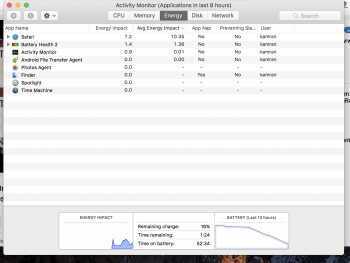

Just want to share my experience with the new MBP. Been using my 2016 MBP TB 13" for almost a month now. The first week was pretty awful battery wise. The MBP would lose power when not in use & got perhaps 3 hours of use out of it consistently. Thought about returning it at this point.
Thankfully, by around the 2nd week and beyond, it got a lot better for me. For the last 2 weeks, I only charge my MBP every other day since I only use it at night for around 3 - 4 hours each day. So from personal observations, I can say that I have been getting around 7 - 8 hours consistently for the past 2 weeks. Not amazing but I think I can live with this
Anyways, for my use case, I usually have Safari, Messages, Whatsapp, Spotify, Unity3d, Affinity Designer, BetterTouchTool & a few other applications running.
